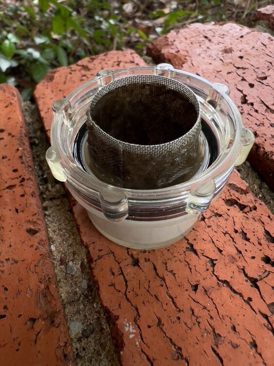

@CRM, if your are experiencing low water pressure when NOT connected to city water, but using the water pump to draw from the fresh tank, then check the filter on the input to the water pump.  I recently was investigating an issue where the pump would not draw water from the fresh tank.  Upon checking the filter at the input to the pump, I found it clogged with a slimy residue (see attached photo.  I removed the fine wire mesh from the filter housing and washed both with Dawn dish detergent.  Water flow is much improved with a clean filter.

We had the exact same problem after cleaning our fresh water tank and using it the first time.  We had to clean the filter multiple times before the water pressure to the faucets was back to normal.  Thanks so much for the advice.
