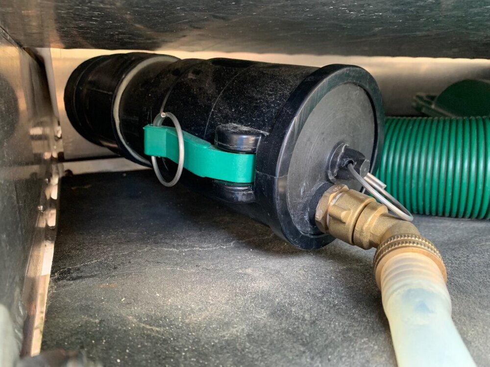

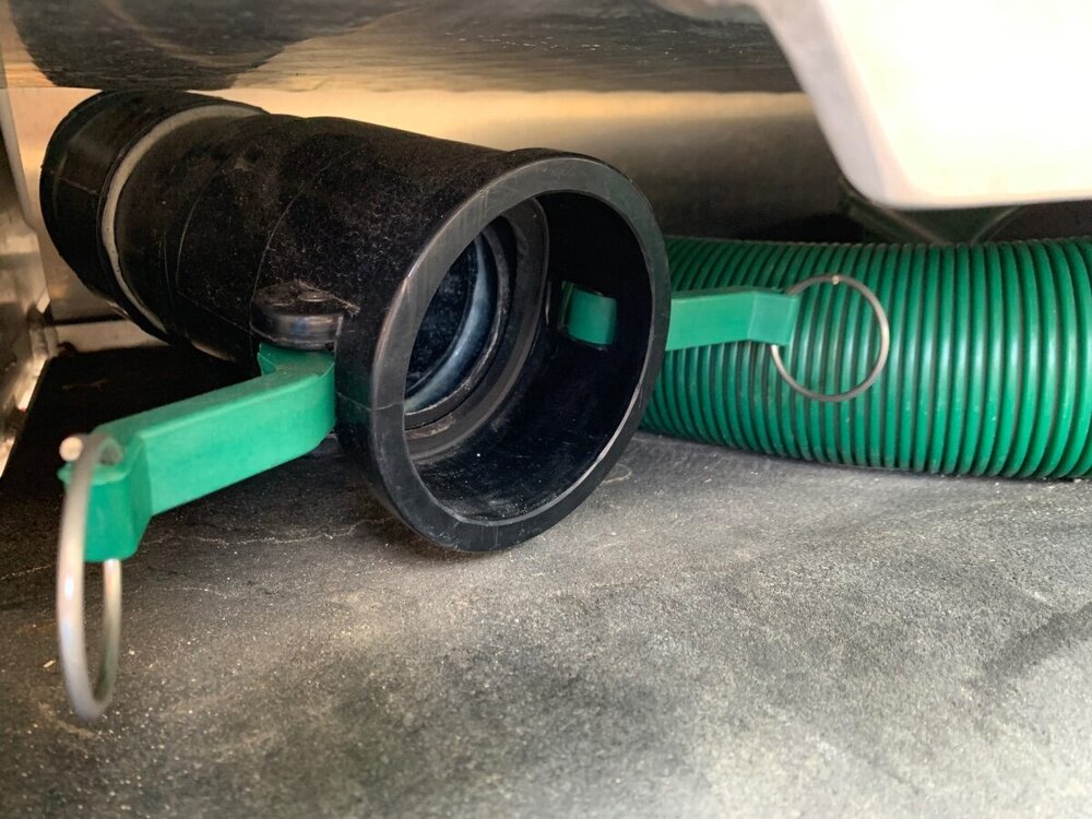

I also received an adapter that can be used to permanently modify the Oliver,

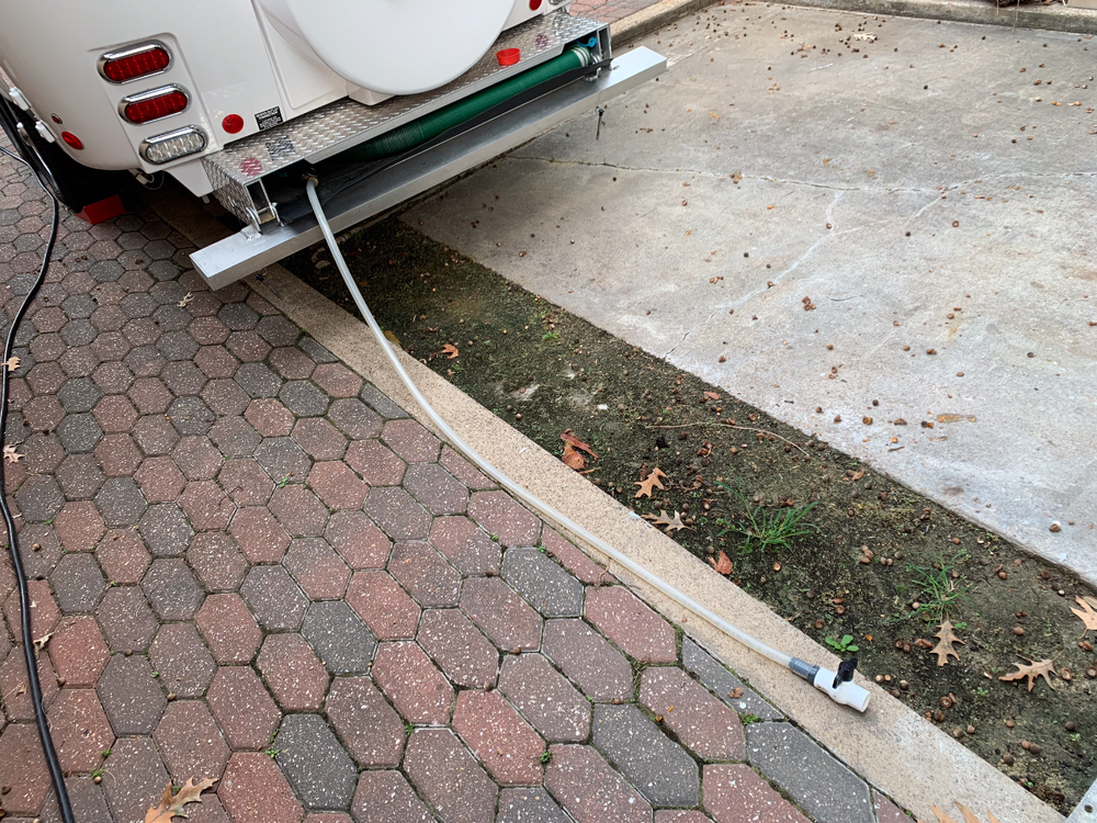

A look at my permanently installed black tank connection; requires cutting off the bayonet coupler and gluing on the cam lock fitting.
View of waste hose connected; allows for rear bumper to be closed.
However, I usually keep an end cap fitted with a hose for gray water management; the hose has a valve at its’ terminus. Another benefit, the clear silicone hose serves as a sight glass in the event of a black tank valve leak.

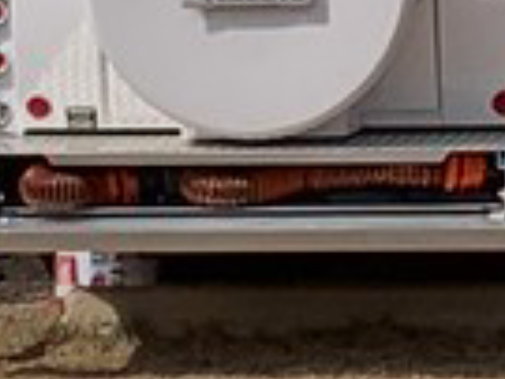

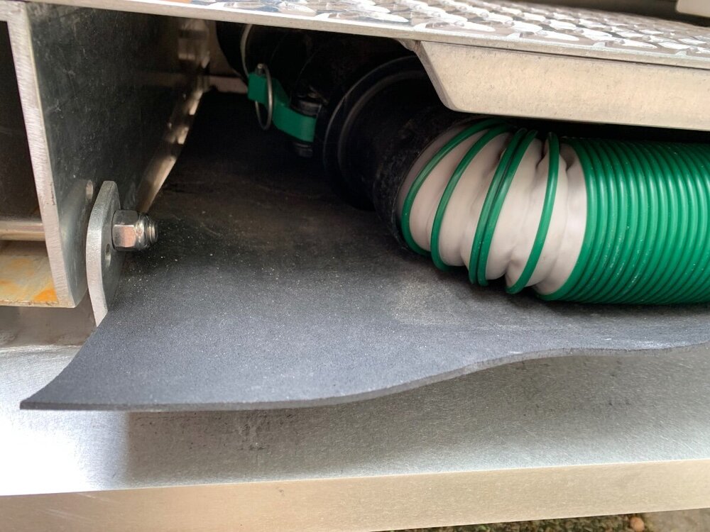

22 hours ago, Ronbrink said:
the coils are rigid enough to hold shape when stowed and deployed, no frustrating snaking around
Quoting myself to make a point. The first pic is a 20’ section (when extended) of RhinoExtreme sewer hose, very difficult to stow since it bulges out (snakes) when attempting to contain in the rear bumper compartment. The second pic is the same extended length of Waste Master sewer hose, much more manageable! And yes, the nozzle end can be rotated to position the valve handle facing upward, thus allowing it to easily pass through the notched (wider) opening at the compartment end. Also shown is the gray water hose with end valve.
Thanks for the info and pics. My older Ollie doesn't have that notch and I have to keep my current waste nozzle stowed away instead of in the bumper. Looks like I can notch mine as shown in your pics and be done with that added hassle.
It would be easy to do. Mine came notched on both sides; driver side benefits the sewer hose hookup, passenger side the propane quick connect and now the hose nozzle as well.
