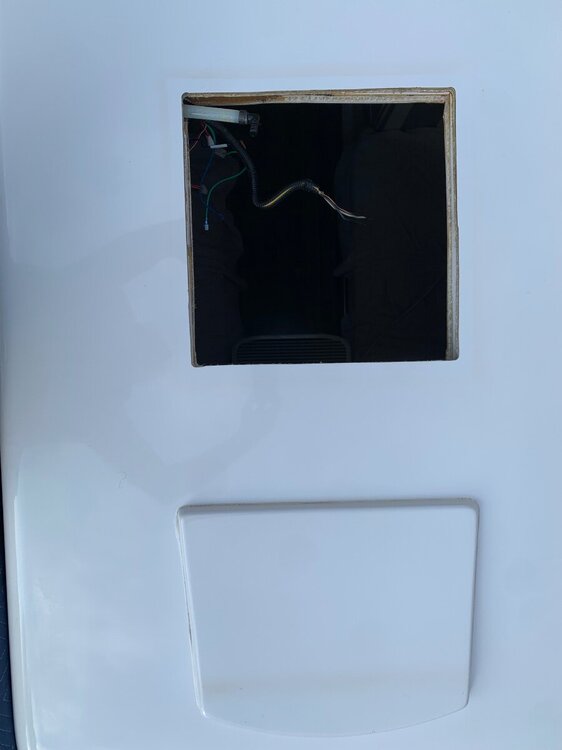

Interior view of the Atmos being positioned over the roof cutout. Note the use of the mounting bolts as a guide, as recommended by SDG. Because the ‘rough cut’ edges of the layers of fiberglass (inner and outer hulls, and spacial filler) were inconsistent, I used the foam seal as a reference to accurately center and align the unit; distances measured to each respective bolt.
Initially, installation instructions were followed by adhering the supplied straight piece of self-adhesive foam onto the bottom of the unit as a rear support, but it did not make contact with the roof due to relief of the aforementioned fiberglass landing. Alternatively, the foam piece was cut in half and each adhered onto the fiberglass, in like manner as the square seal, along the outer edges of said landing. This adaptation proved very effective in application and purpose, as the last of the next three pics demonstrates.
Now that the exterior unit is properly positioned and supported, it’s back inside to further installation. As a side note, I made use of a portable a/c to buffer the heat and humidity of the day! Although my son helped with the heavy lifting and positioning, I cut him loose and completed the remaining tasks solo. Before proceeding, I used foil tape to treat the end of the aforementioned condensate drain tube and secure it to the side. Next the installation of the fabric air plate duct subassembly was started (provided Dreiha Atmos 4.4 Manual details the process). Note I used foil tape on both the upper (at Atmos bottom) and lower (at mounting frame) duct plates, even though most installs viewed applied to the mounting frame plate only. Between the upper and lower duct plate installs, the ceiling assembly mounting frame was bolted in place and hand torqued using a screwdriver only (torque specified in Manual).

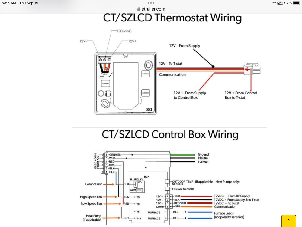

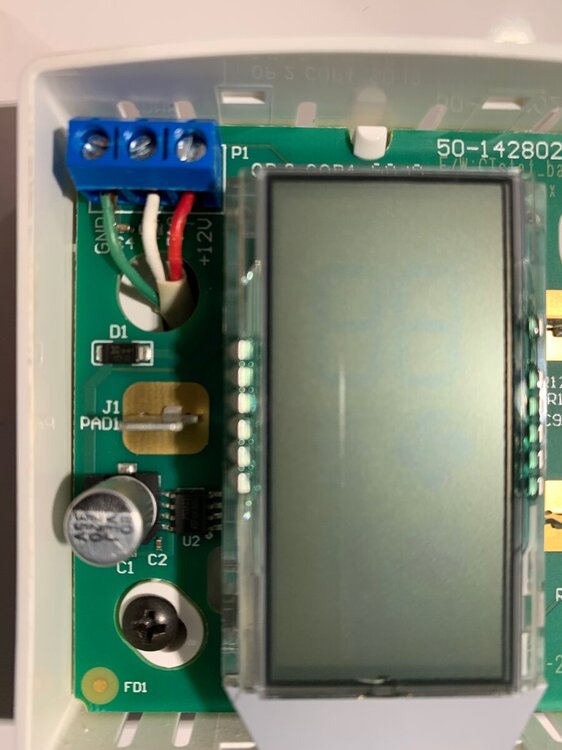

Today’s project, making sense of this wiring to enable Dometic heater/wall thermostat operation. This pic was taken during the Atmos install of the stock DC wiring harness. Standby!
Looking forward to understanding this. SDG recommended to replace the Dometic thermostat with a simple furnace thermostat. That's what I was told when I called SDG.
I've been wondering why I could not just keep the Dometic thermostat where only furnace operation would be controlled, the other functions would be null, wires taped open. This assumes you control the Atmos via the Atmos remote. I have this model thermostat:
This is the “simple furnace thermostat” provided by SDG. Take notice it is currently on my dining table, as I just came in the house from getting the Dometic heater functioning. That should tell you something! Details of what I was able to make do forthcoming.
Since you mentioned the Atmos remote, I received the replacement GREE model from Amazon this morning; primarily because it has a backlight, which the stock remote lacks. Based on the product description I was unsure if it would work with the Atmos, being ‘This is NOT a universal air conditioner remote control’ and there was no compatible match. Free Returns, right? Well, I’m happy to report is does work, at least good enough for now; it came with no instructions so I need to further assess its full functionality. Better yet, it fits in the stock wall mount! BTW, I have the same Dometic thermostat.

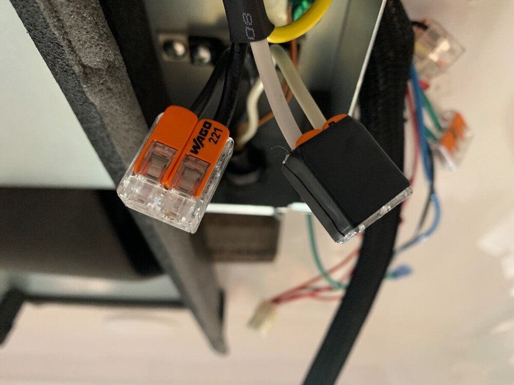

As previously indicated, my Dometic furnace is ‘good to go’!  I will preface the following by saying this task was not as difficult as first perceived, perhaps because my DPll 11,0000 BTU unit wiring setup was unique. When installing the Atmos I did not take time to mess with the furnace wiring and thermostat dilemmas, one hurdle at a time. Having watched several install videos on SOBs and closely followed @rideadeuce’s experience with SDG, I remained uncertain regarding the furnace apparatus; wiring configurations varied and In all instances the existing thermostat was abandoned. While dismantling the DPll I found all AC/DC  wiring involved a plug&play box, specifically a control box as part of a Dometic single zone kit to include a thermostat and wiring harness, as well (PNs: control box 3313191.000, thermostat 3316410.700). I didn’t think much of it at the time, since the Atmos junction box was all needed to connect AC power. However, in the days following the install my thoughts focused on the furnace and then it occurred to me that maybe the control box could be retained, making use of the existing DC harness and stock thermostat. First some afterthought matters to address:
When installing the Atmos A/C wiring I did not utilize the inherent strain reliefs within the junction box, so it was opened, wires further secured, done. I decided to better seal the fiberglass edges of the ceiling cutout to inhibit potential unwarranted air draw (from within/between hull walls) given the higher operational CFM of this unit. In particular where the wires entered, a piece of closed cell foam was cut to size and shoved into the opening followed by an application of foil tape around said cut edges, to the extent possible, done. Onward!
Here is how I proceeded forward:
The ceiling grille was removed, mounting frame plate bolts loosened to free the loom wrapped DC wire bundle tucked away at initial install and ensure clearance of the control box within the void of perceived securement, DC wiring harness connected to the control box and all staged for an operational test of the furnace/thermostat. With AC/DC powers restored, I was pleased to find the Dometic thermostat operational, but had to chase an E5 code on the display. Although specific to the a/c, the freeze sensor wire needed to be plugged into the control box to clear the code. In order to test the furnace the Atmos was first used to drop the interior temp to 73.8° with the thermostat ‘FURNACE’ set to 77°.  Voila!
Following a second successful test of the furnace, the mounting point of the control box was cleared of an adhesive stock piece of foam and box prepared for installation. A self-adhesive strip of Velcro was applied to the leading edge of the box and subsequently affixed into position. The foam piece was then positioned against the box and pressed in place to help stabilize it. Next, corresponding wires were connected in respective ports, wire loom secured with tie wraps and tucked away, mounting frame plate bolts retightened, cover grille reattached and decorative screw covers placed for a final install, YAHOO!
Excellent work Ron! You know I had asked, "why couldn't the Dometic thermostat be kept as-is for furnace mode only?"
Perhaps it's safe to say in future installations, the installer should remove the AC wiring from the control box but keep all DC wiring as-is (including the freeze sensor wire). Mount the Dometic control box within the Atmos cover as you have demonstrated, and the furnace mode will work with the OEM installed Dometic thermostat.
With your pioneering efforts, I and others will be able to work this as part of the initial installation. 😂

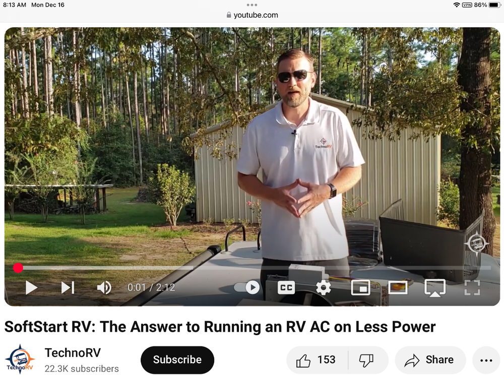

Any chance you have a picture of the SoftStartRV installed? I have one installed in our Dometic P2 and would reuse it if possible, given it's in working condition.
Another question: why is soft start necessary for this more efficient A/C? I understand you have a 2KW Xantrex. Would it be necessary with the 3KVA Victron MP2?
Search this:

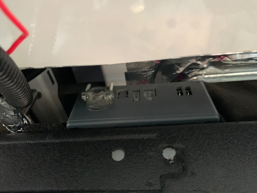

Ronbrink, do you have a little bit better view of the overall area/location/description of where the old Dometic control box is placed in the new ac unit? The close ups are great but I’m not understanding the location. Also, does your factory installed thermostat have individual wires or like mine, does it use a telephone type wire? Thanks
2017 Elite II, Hull #208
2019 Chevy HD 2500 Duramax
You’ll have to stretch your imagination a bit, hopefully you can visualize in your mind’s eye the approximate location. The control box occurs in the void between the bottom of the roof unit and the top of the new mounting frame plate, that space being the depth of the cutout measured from roof surface to ceiling surface. In the first pic (Dometic) the box would occur in the vicinity of the white label seen over the drain line. The second pic (Atmos) is a bottom view of the mounting frame plate with the box being situated on its’ topside, nestled up against the duct, a couple inches from the top right mounting bolt and faced outward along the downward angled edge of said plate. Looking closely at the third pic you can see the threaded bolt to the left and duct plate immediately right of the control box. The forth pic shows the three wire thermostat cable. The last pic may be of interest, wiring diagrams for the control box and thermostat. Hope this helps.

So, for clarity, your thermostat wiring is a three wire cable not a telephone type cable with a telephone type plug on each end.
Edited by mountainoliver
Clarification
25 minutes ago, mountainoliver said:
So, for clarity, your thermostat wiring is a four wire cable not a telephone type cable with a telephone type plug on each end.
Actually there are three wires (red, white, green) in the white sheath leading and connecting to the thermostat.

15 hours ago, mountainoliver said:
Okay got it! Not a telephone type wire/connectors. Mine must be the only one that was wired using telephone type wire and connectors.
Likely you will just leave the wiring you have at the thermostat and control box. The "telephone" connector has often been used for plug-n-play electronics, so consumers do not have to do any real wiring. It is a 4-wire connector where sometimes just 2 or 3 of the 4 available wires are used. The old "twisted pair" landline telephones only used 2 of the 4 wires (black/red and yellow/green). Four were used only when there was a second line into a home or business. I have spliced these phone cables to change the terminal on one end. If you do the wires are of such fine gauge they should be soldered.
