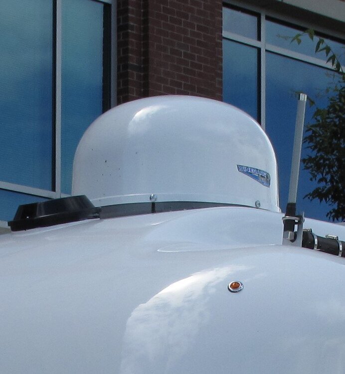

I thought it would be cool to mount a Star Link Mini in there.    **** My Bad....   I misunderstood OP's post.   Thought Claudia was talking about the Winegard Satellite TV antenna.  See Picture.   Now if we  someone other than me... can figure out how to get a Star Link Mini in there... we're golden.
Back to my first un-edited post.
Full disclosure.... I have not seriously explored actually doing that, nor am I certain that it would even be possible.  Just wanted to put the idea out there in case someone more mechanically talented than me would steal the idea and write up a post with pictures, circles, arrows, and a description of exactly how this is accomplished.  Then maybe I could think about it some more.
Good Luck on the removal...   Don't forget to take pictures.
Scotty

There are a few installs documented. @Galway Girl and @rideadeuce to name a couple. Just search for keyword “Starlink.” These are not the Mini, but installation cannot be much different. I hope to buy one Dec-Jan and will document my installation.
@Patriot has a recent thread on the Mini, and he is adamant on its being portable, stating the need to use it when the Oliver is camped where view of the northern sky is blocked. This is an important valid point.
Mine will be installed on the tow vehicle, plugged into our Pepwave router, also installed in the TV. The Pepwave would look first to cellular signal, switching to Starlink when needed to minimize Starlink data used saving $$$. I figure that if the Oliver is blocked from the northern sky, which is rare in the SW where we do not have the tall trees of the east, I can park the TV in a better position which could be 100+ FT away and still have Wi-Fi access, broadcasted by the powerful Parsec antenna.
I'm trying not to add more portable gear, the setup and tear down. Kinda sorry I invested in suitcase solar vs. another rooftop panel or just a DC-DC charger. It’s great that Starlink now has affordable options.
Oh, and we have a monstrosity of a Winegard Dish Sat device, front of ours, yes bug collector, that I will remove soon. What a mess with all the screw holes OTT drilled in the roof (use 3M 4950 VHB tape).
