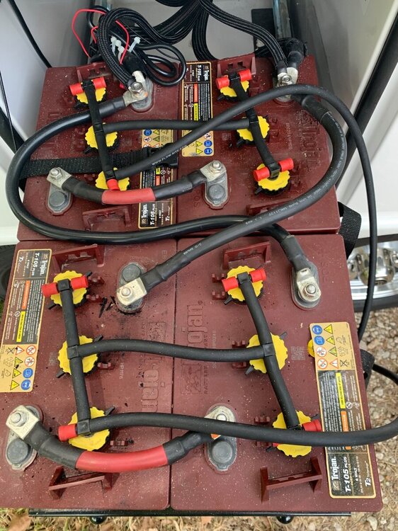

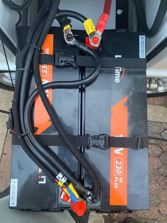

Ronbrink Posted December 28, 2024 Posted December 28, 2024 20 hours ago, grweber1 said: The inverter should work with a 300ah from LiTime, There is a remote pendant that plugs into the Xantrex inverter 9260C, and converts it to lithium. ( see JD's post ). Our 2020 OLEll 579 was ordered with the stock Brightway battery bank, Xantrex 2000W inverter and no solar. I soon ditched the Brightways and installed four Trojan T-105 6V batteries my Son gifted me when he upgraded his motorhome to LiFePO4s. Last year I upgraded to LFPs, specifically two LiTime 230Ah batteries. I changed settings in the Xantrex for the new battery type and disconnected the vehicle charging wire at the 7-way cable connector. I, as well as @topgun2, have detailed the installation of said batteries in respective posts. I have had no issues using my Xantrex with this setup, and have also taken measures to operate the a/c on battery, as well. 4 Ron and Brooxie | Clear Lake (Houston), Texas 2020 OLEll, Twin, 579: No installed solar, dual 30# propane tanks w/GasStop safety devices, Renogy 40A DC-DC charger, 460Ah LFP battery bank/Victron SmartShunt, auxiliary Cerbo-S GX/Victron 30A Blue Smart IP22 Charger combo, interior mounted Hughes Autoformer, twin independent sliding Lagun mount tables, extended dinette table and pantry landing, tongue-mounted hoist, Beech Lane refrigerator Ventilation/Evaporate Coil fans, metal valve stems with TST cap sensors and signal repeater, Waste Master sewer hose management system, Dreiha Atmos 4.4 A/C upgrade. 2019 GMC Savana 2500 Cargo Work Van: Explorer Limited SE, Low-Top 7 Passenger van conversion, 6.0L V8 Vortec, 6-Speed Automatic, RWD; Air-Lift LoadLifter air suspension/WirelessAir compressor; Bilstein B6 4600 Series shocks; metal valve stems for TST tire pressure monitoring system; Buyers Products cargo containment boxes/DC Cargo securement system; rear bumper DC-DC Anderson power cable outlet; 100Ah 12V portable power station/Dometic CFX 75L Dual Zone Refrigerator and Freezer; front 2” receiver hitch/QuikrStuff Mach2 double bike rack; Mechman 320A high output alternator.
