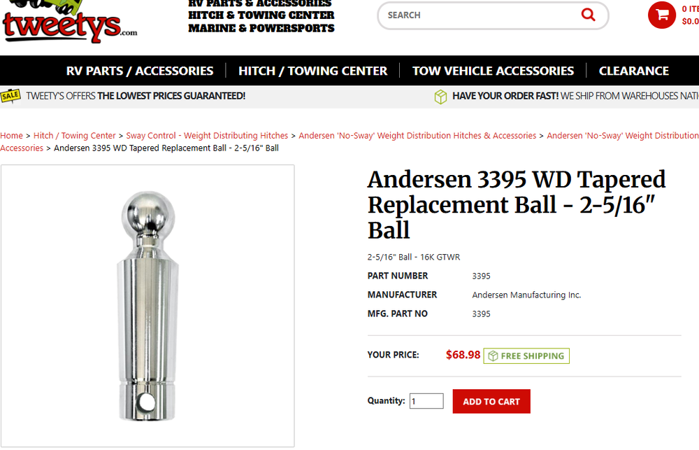

I just purchased the 2 5/16" ball and friction cone. It is the friction cone ONLY that has a lifetime warranty but you must pay shipping ($18 part and $13.50 for shipping)! 🤣
My total was $90 just purchased this month.

$94 at Tweety's.  A bit more expensive than free.  Drats.
Thanks for the heads up.  At that cost it will be worth an inspection of the ball and it's shaft.  If the shaft is good,  Get the free cone for cost of shipping and install the ball 180 degrees from OEM and wear out the other side of the ball.

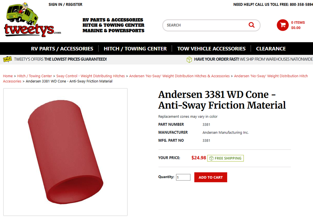

Apparently (per Anderson) there’s an old style and a new style Anderson WDH cone, the correct friction cone for my 2023 WDH is blue and looks like the one in the image I have put below. The white friction cone is for the old system, which one did you get?
For what its worth - there is also a "red" friction cone.
I’ve ordered two friction cones directly from Andersen.  The latest ones supplied  are red, but they’ve shipped me a light blue one previously. They’ve changed the material at least once. Why? Dunno.

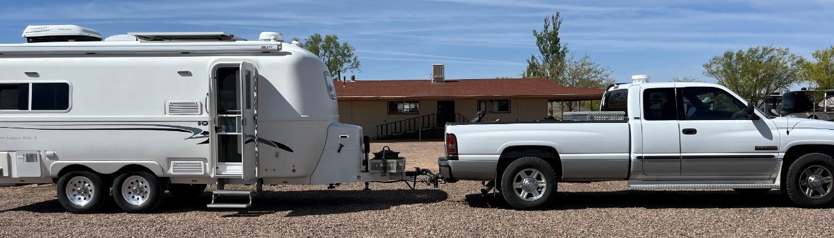

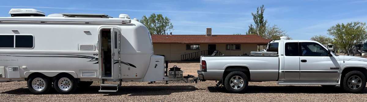

Measure from bottom of each fender to center of wheel (or to the ground) on all 4 wheels. They should be the same left to right, but often the rear height is greater than the fronts in a truck that is weight balanced.
Hitch your Oliver and take the same measurements. The numbers will usually be lower on the rears and taller up front.
Tighten the Andersen chains until you have the same numbers measured when the truck was unhitched. The only way this method is not accurate would be from a worn suspension or being over capacity in the truck bed. Once you get it right, count the number of threads and go for this number. Also, it does not matter if left to right you are off a thread or two. The hitch will adjust to make chain pressure equal on both sides.
If you look very closely at these pics, the first one is tongue weight loaded, about 2" or so drop in the rear of the truck. The second pic shows truck and trailer in a perfect level line after tightening the Andersen WDH! 😂

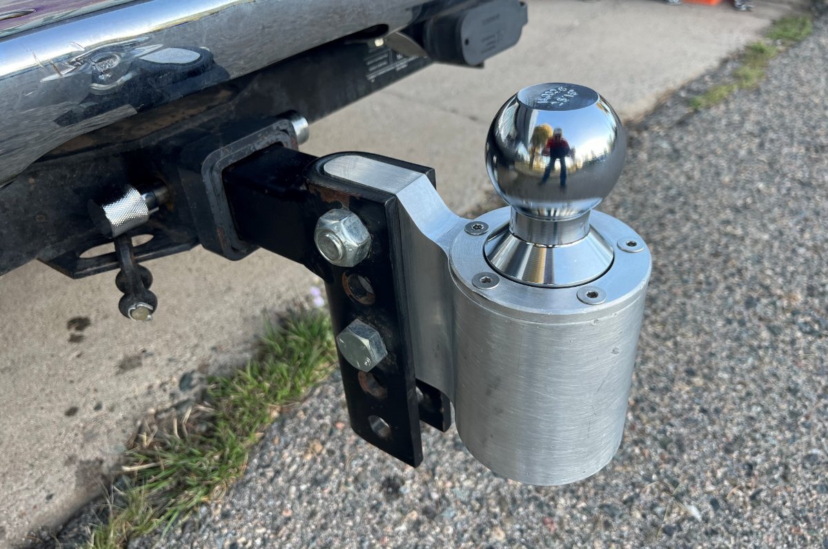

I was getting clunking even before I started using the front jack to raise the TV. One of these fixed it right up. Rhino USA Hitch Tightener

The only way this occurs if your Andersen chains are loose! When tight enough the ball of the hitch is pushed forward to the point of being tight.
We get absolutely NO noise from the hitch at all when the Andersen is dialed in to the right tension. When coupled and adjusted. Push your foot down on both chains. They should flex a little and nothing else.
