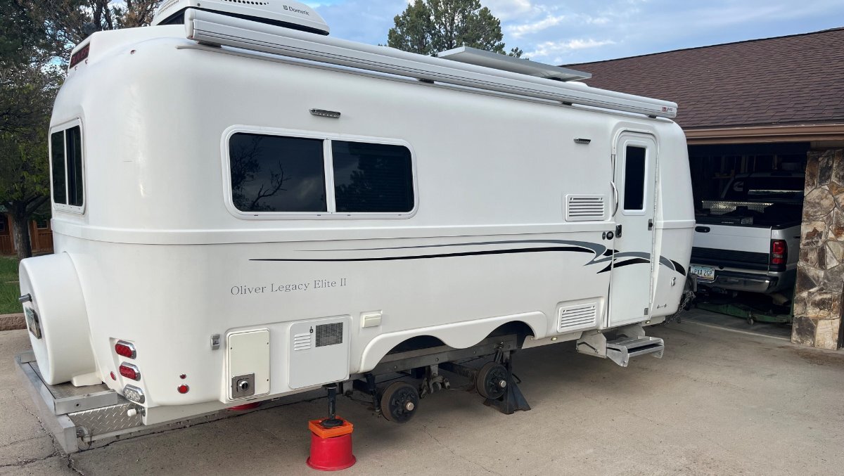

I'm installing ours this weekend (more info soon)...
Out with the old and soon in with the new D52 axles and Alcan leaf springs! 😂
