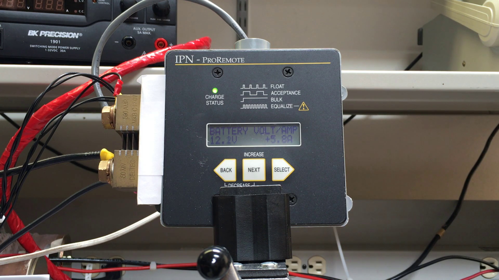

So, what I'm about to suggest may return insults from the purists here...
Of course, get your Blue Sky SC setup properly for LiFePO4 at the voltage settings spec'd by the battery manufacturer. The dozens of menus and buttons you have to push in this setup is truly tedious. I went through it all following the training video below. It took me 3 tries to get it right without making a mistake! 🤣
Given you're "not often plugged into shore power" you could forgo purchase of the PD charger upgrade, at least for a while (or longer). We got home from camping last week and I only plug in at home when over 90F and I need A/C. Batteries were 55% SOC and by the 3rd day they're back to 100% on the Blue Sky charger alone.
The only true harm to LiFePO4 batteries by charging in lead acid mode on shore power is over-charging. So when you need to charge occasionally using the onboard PD charger, just turn it off when you get to 90% or so. Even 100% is OK if you turn it off just in time. Personally, I NEVER leave a charger on continuously (except a MPPT SC) or for more than 48 hours, "smart charger" configured correctly or not. I just don't trust algorithms nor programmers. If you're one that would forget it's connected, that's another thing!
8d5792e58ceb69ff1d86ccb3c073768f.jpg?image_play_button_size=2x&image_crop_resized=960x540&image_play_button_rounded=1&image_play_button_color=10649de0
Learning Center – Sunforge LLC
