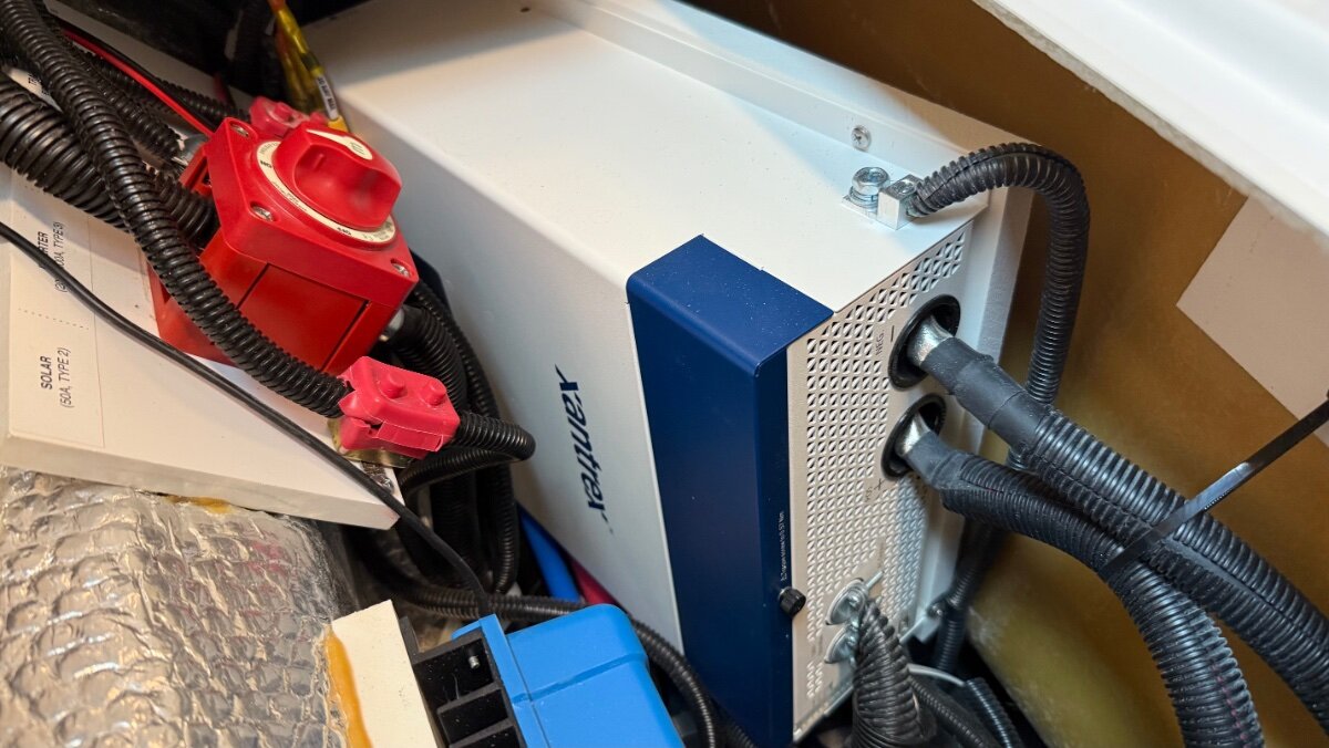

Durning my preflight inspection I noticed that our Xantrex inverter had become detached from the fiberglass sidewall. Has anyone had their Xantrex inverter mount detach from the sidewall?
Any recommendations as to what type of adhesive or alternative fix for this situation?
 It appears that the adhesive that was used at the factory did not stick to the fiberglass and was possibly only holding on with the sticky black tape.

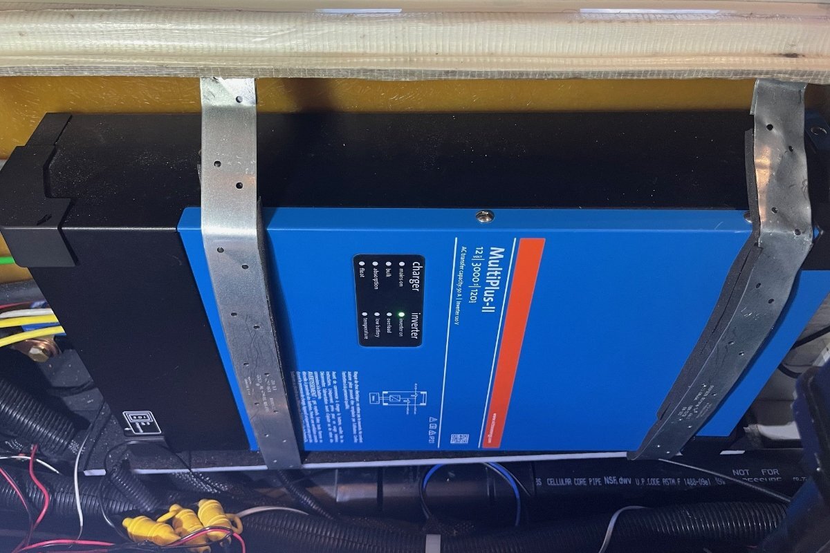

When I installed our Victron inverter, I had seen installations on this forum using a vertical mounting board and adhesives which made me worry. That's a lot of weight to to be glued to a wall of a travel trailer!
I decided to build a shelf sitting on the floor below and after the inverter was in place, I used anchors and strapping to hold it against the wall (see pics). You should see if you can move the inverter up and out of the way and see if building a floor-mounted shelf would work in your hull. Pull the battery ground or turn a shut-off switch before moving or removing your inverter.
In the meantime if you must travel, stuff some insulation on both sides of the inverter to keep it from moving!

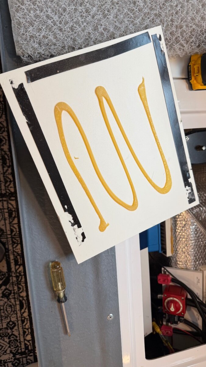

Upon examination it appeared that the original application of adhesive did not adequately  fill the gaps between the mounting board and the fiberglass as a result the mounting board was only adhered to the fiberglass in a few spots ( along with the black tape ).
I followed the recommendation of @John Dorrer and applied Gorilla Max Strength Construction Adhesive making sure that the adhesive bead was adequate to more than fill the gaps and surface area.  I'm pretty sure that this bond will last longer than anything else in the trailer.

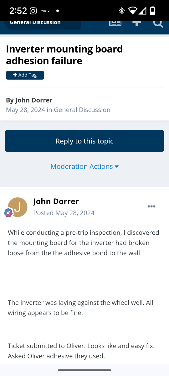

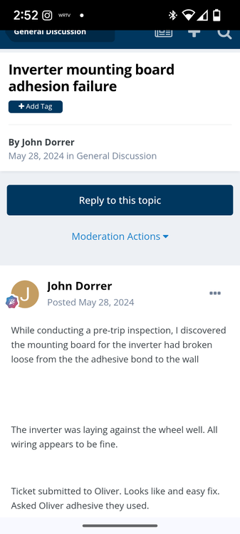

Ollie Haus found a post I did on remounting the inverter board back on 2024. I forgot I had posted.🙃
Here is my 2024 post. Many photos included
Edited by John Dorrer
Updated Comment
 Good write up John, and that is your story and your STICKING TO IT!  Bada bum!! 🥁 Pun intended! 😄
