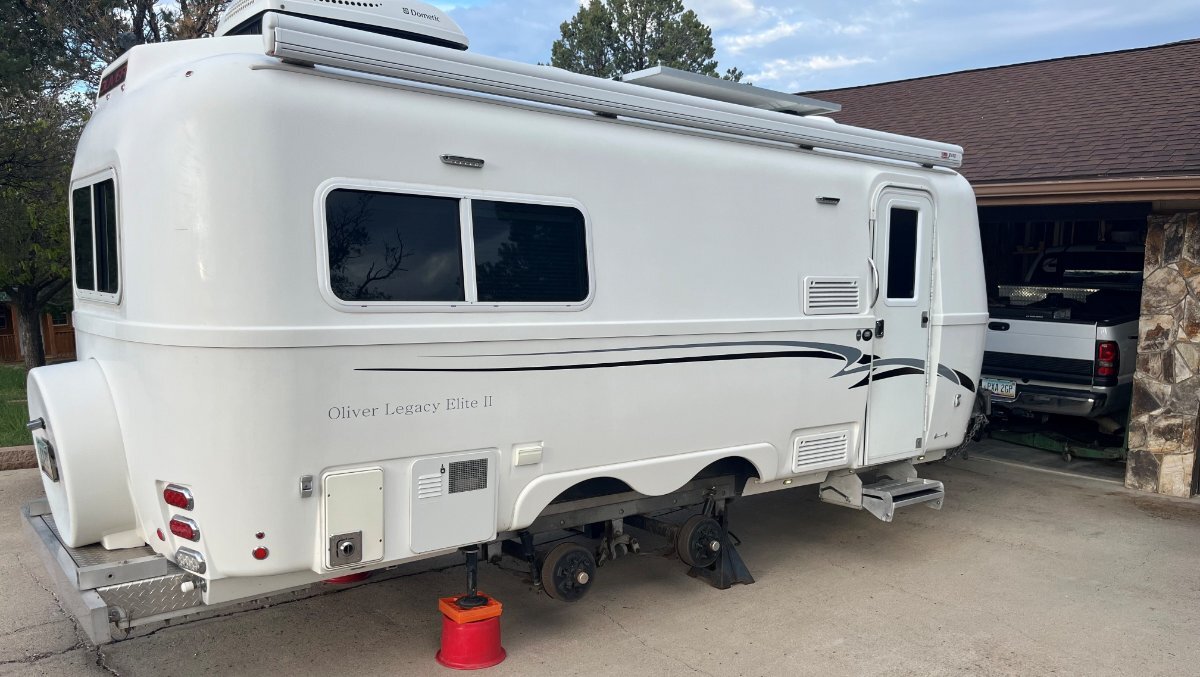

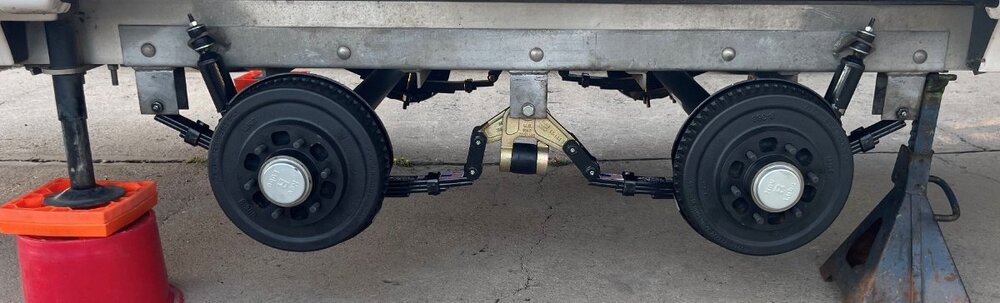

Next step was disassembly and removal of the original suspension. This took about two hours on a first afternoon. The Oliver should be connected to the tow vehicle when doing this, so given our short driveway the truck had to be in the garage with garage door half-open for a few days (TG no Pack Rats in the garage)!

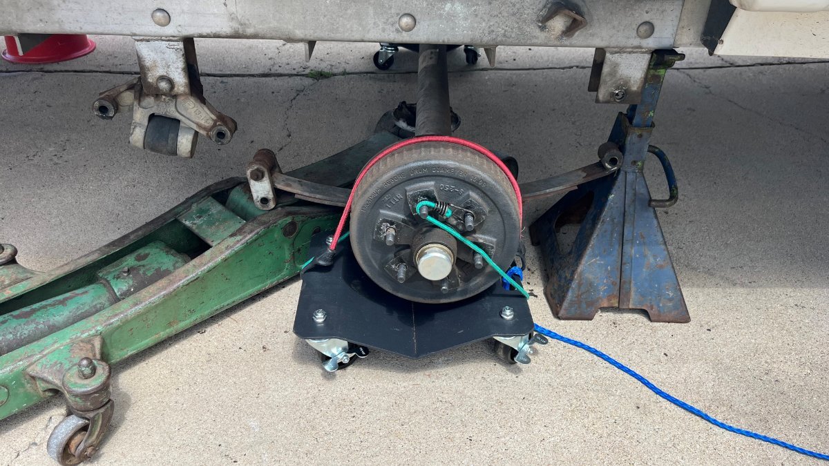

I used the rear stabilizer jacks to lift wheels off the ground and then placed jack stands at the front edge of the steel subframe, and lowered the rears to balance the weight of the hull front to back.
Thinking this through a few days prior, I realized a pair of wheel dollies would allow me to do this work without a helper to carry axles. Picked up a pair on Amazon for a little over $50. It was great to roll out the old and later roll the new axles into position!
Since I've done this work at home and replaced an entire working suspension in relatively good shape (no flat spots in the OEM leaf springs), I have the original suspension listed on Craigs, hoping to get $800 on the entire setup. There are a lot of guys in Arizona that build homemade ATV trailers and this would be perfect for that use vs. spending $3K for new. Wish me luck! 🤣

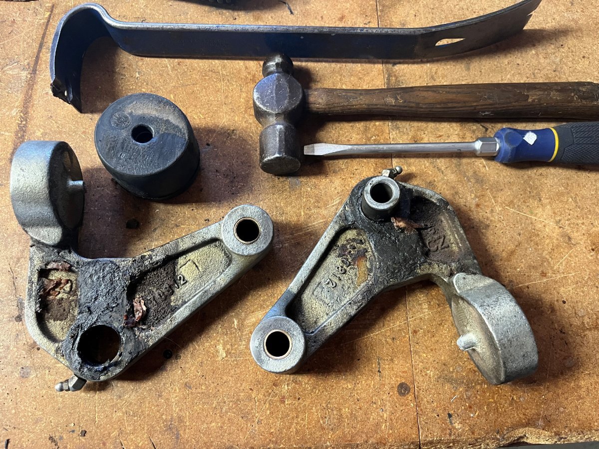

Most of us have the Dexter EZ Flex upgrade which includes bronze bushings, wet bolts, HD shackles, etc. You want to check on the condition of these parts during this installation. Going to Alcan for service? I suggest you bring new EZ Flex equalizers with you to have installed with your new leaf springs!
I purchased new wet bolts and HD shackles from Alcan since the new leaf springs have new bronze bushings and I wanted new on new. It was suggested to reuse the center equalizer of the EZ Flex. Turns out ours, installed by OTT in 2018 had seen better days!
You cannot truly inspect these parts without removing them and better yet is to fully disassemble them. I've read these parts are not serviceable but you can see here that they could be, yet Dexter does not sell bushing kits for these. I had to buy new equalizers and mounting bolts, another $316 at eTrailer.
They can be disassembled by prying the two levers apart. To put them back together you need a LARGE Channellock (or vise), one with jaw opening greater than 4", squeeze square and slip the center sleeve back into the bushings on each equalizer lever.
Notice the cock-eyed bolt alignment in the second picture. I believe the dual lever design creates the off-angle wear over time. Keep up on wet-bolt torque settings (65 lb-ft per Alcan) including the center equalizer mount bolt and this should help keep the center bushing square. As I disassembled the original suspension, I noted every wet-bolt was too lose! I'll do better going forward now that we're starting from new! Re-torque annually after the frequent adjustments required during break-in.

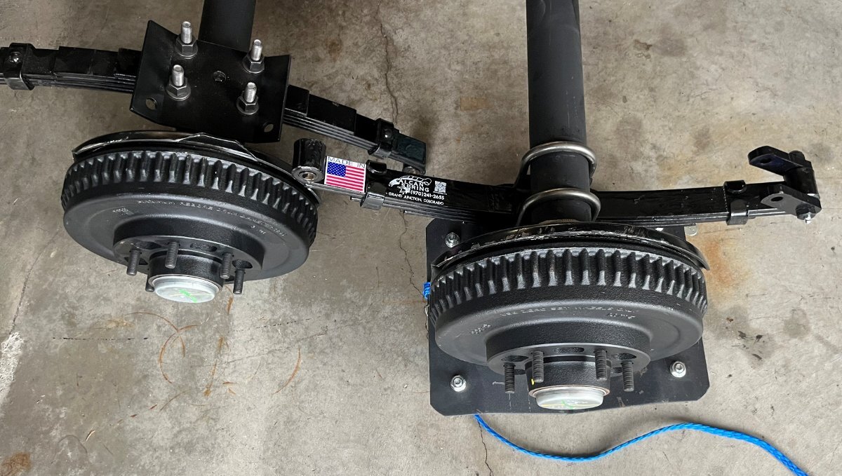

I thought I should mount the leaf springs to the axles on my garage floor and then roll the entire assembly into place for installation. I wanted the leaf springs and U-bolts as square (perpendicular) as possible. I noted each leaf was basically 4" from the brake backing plates, so I found a 4" spacer to use for assembly. Also, the U-bolt tops should be 2 1/8" apart and I had a socket this size to gauge.
Not sure how the pros do this. Do they just lose-bolt everything together and torque down after mounting? That would certainly be quicker (likely). Turns out i had to loosen the U-bolts on one wheel to get the hanger bolt to align and push it through. Then It took me an hour to realign the U-bolts to get them square again!

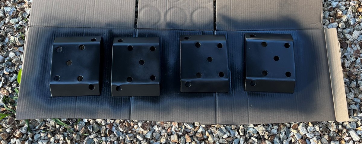

You need to reuse the custom U-bolt ties, the lower plates with the shock mounts. I cleaned and painted them. The centering hole had to be drilled out some for the larger bolt on the new springs. I mounted each spring so that the Alcan label and Made-in-USA flag would be facing outwards. The left side of the axle is the side with the brake wiring. When torquing the U-bolts to 90 ft-lbs, I used a caliper to ensure thread lengths on either side of the U-bolts were close. I re-torqued them the next day prior to installing since it's easy while sitting on the floor. Several reasons why when you do this work for yourself it does take longer!
When remounting these tie plates, I switched them left-to-right. This allowed me to mount the shocks to the bolt-hole on the other side that had not been previously used. You may be able to see in the picture that the bolt-holes used over the last 10 years were somewhat oval-ed from use. Nice, eh? 🤣

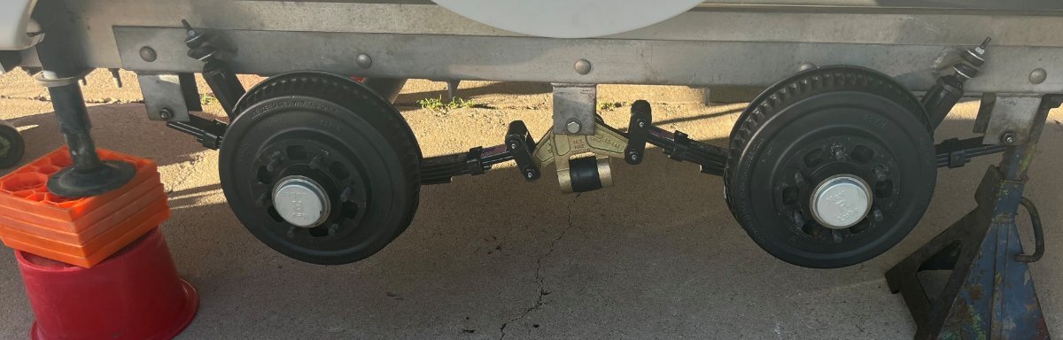

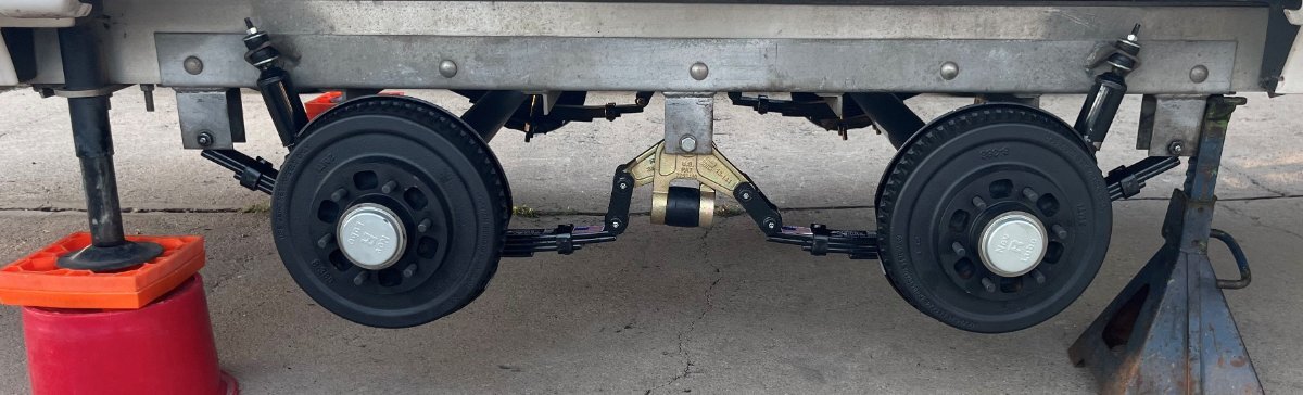

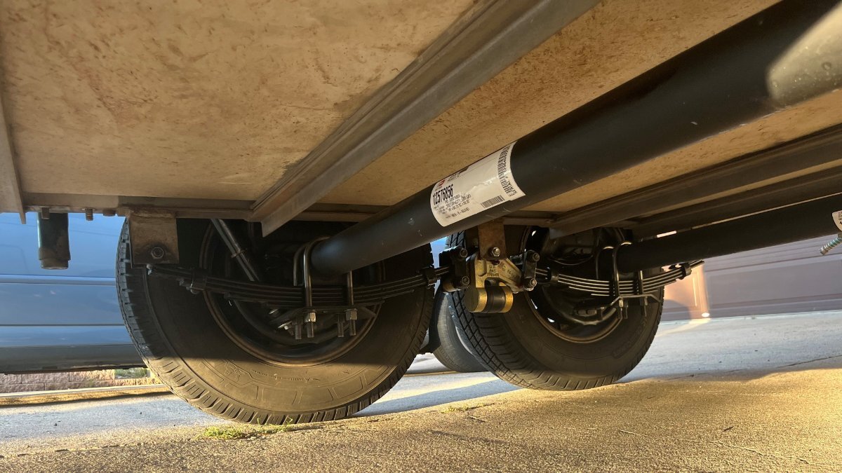

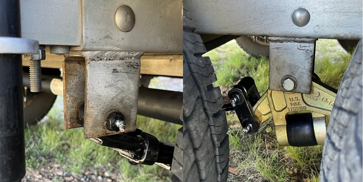

Next step is to build the new suspension. I made a mistake in assembly, then contacted Lew at Alcan and he got me straight in a minute!

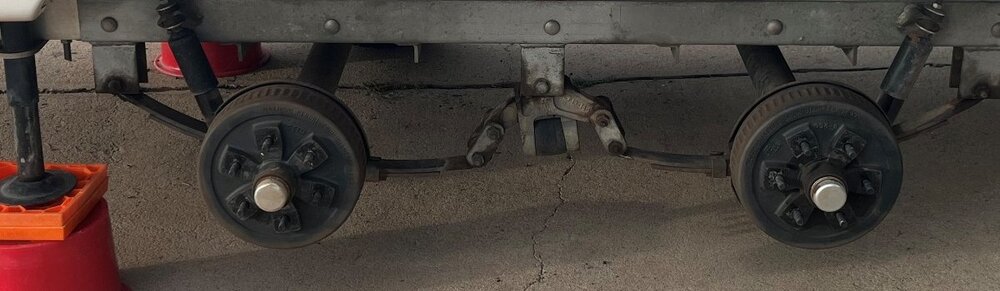

Notice the first picture, suspension jacked up, wheels removed, axles hanging. I thought I could mount the new leaf springs in the same manner, not true!
Remember reading posts here about having to flip a shackle, after lifting the Oliver to change a tire or something? On the OEM, old weak and lose suspension, a shackle could drop down and you could drive over a curb and the shackle would flip back up. Not with the HD Alcan leaf springs. They must be mounted shackles up to start, as they are NOT going to flip! 🤣 This also means that when changing a tire after your Alcan upgrade you will not have to worry about the shackle falling, they will certainly stay up!
Pic1 shows the original suspension, pic2 how I first installed it, pic3 shows the suspension corrected shackles up. It was not fun, nor easy to remove the wet-bolts to flip these shackles. You must have the Oliver jacked up evenly, front-to-back and side-to-side otherwise there is stress on these bolts keeping them tight. On our driveway, slanted downhill it took me a couple of hours on each side to get the leaf springs aligned to make this correction. BTW, if you want to change the equalizer by itself, that job would not be fun either. Replace the equalizer when you replace your leaf springs.

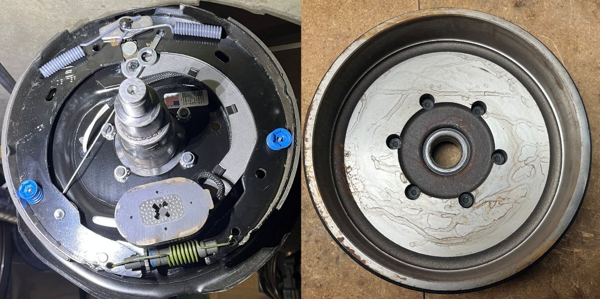

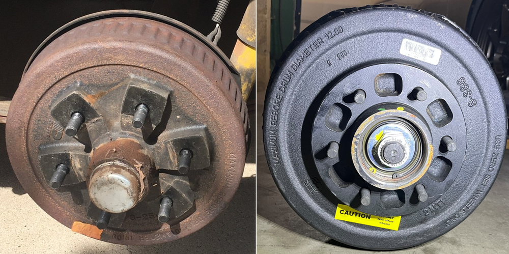

The 12" brake drums are certainly more substantial, though my side-by-side photo does not do them justice since I made them the same size as the 10". Another photo shows the internals of the 12" Self-Adjust and Nev-R Lube setup.

A couple 30 mile test drives so far. I've torqued everything 3-4 times now. 90 ft-lbs on the U-bolts, 80 lbs on end spring bolts, 65 on the shackle bolts.
After 30 miles with very little trailer brakes, I manually tightened the self-adjusters the the point it was difficult to turn the drums by hand. Next test drive my brakes were 4x better. When any of you are going to Alcan for this service and return there to re-torque, I'd also ask them to tighten the shoes. Don't leave Grand Junction and tow any steep mountain declines until the shoes are properly seated.
