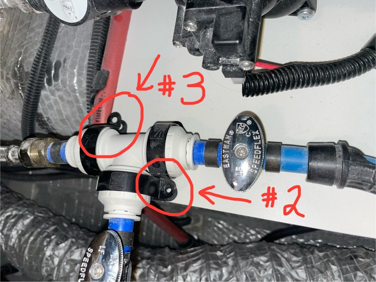

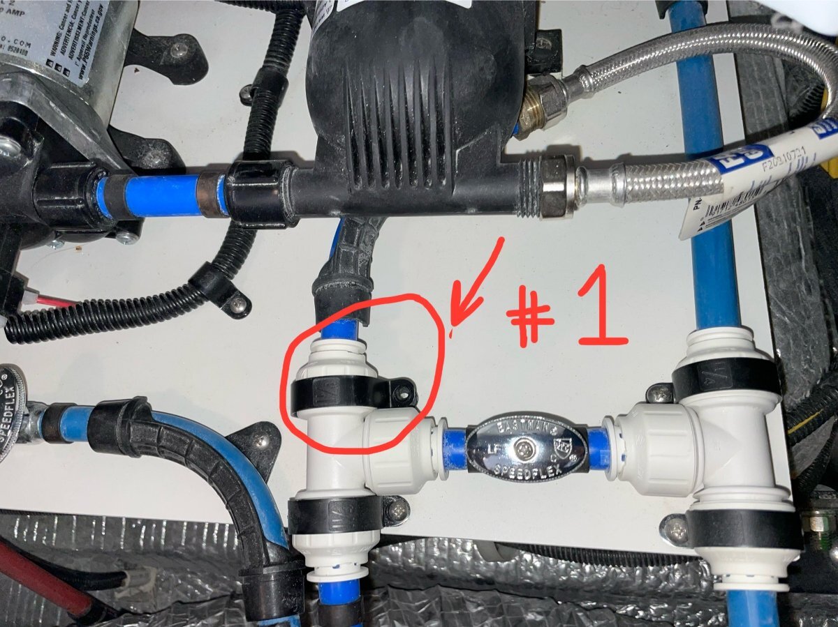

Can anyone help me identify the TYPE and SIZE of screws to anchor the lines around the Water Pump?  I have found several of these are missing (see photos attached), and am loathe to take any out, because I'm not sure whether I can re-install them by hand OR whether they will stay in place, if mounted into the existing holes.  I'm on the road (not at home) and haven't been able to find a hardware where I can pull in with my trailer in tow to get help with this.
I don't have power tools, so am limited to using the standard screwdrivers.
Does anyone have suggestions or solutions:
- alternative mounting (screws of different size, addition of some kind of glue, or different system to hold them down)
- how to size screws (in general) without removing them
Is this standard (another thing to add to the list for pre-trip maintenance)?
I have inquired at OTT mothership (I discovered them missing right after my maintenance service). They have not been able to assist with identifying the screws used, nor suggesting methods to reinstall or what to use in place of original anchors.  EDIT: ** They did suggest that I could "try gorilla epoxy" to see if it would help (once I find the right size and type of screws to use, one would assume).**

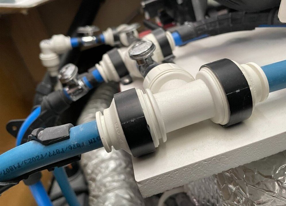

FOLLOWUP:  I took a photograph of the side of the board where my equipment is mounted. I don't know what it is, but I wouldn't call this PVC; I would call it foam core. It's so soft on the inside that I can poke my fingernail into the side.   *haha -- I don't know why it's posting upsidedown; it doesn't appear that way on my computer until I insert it here*

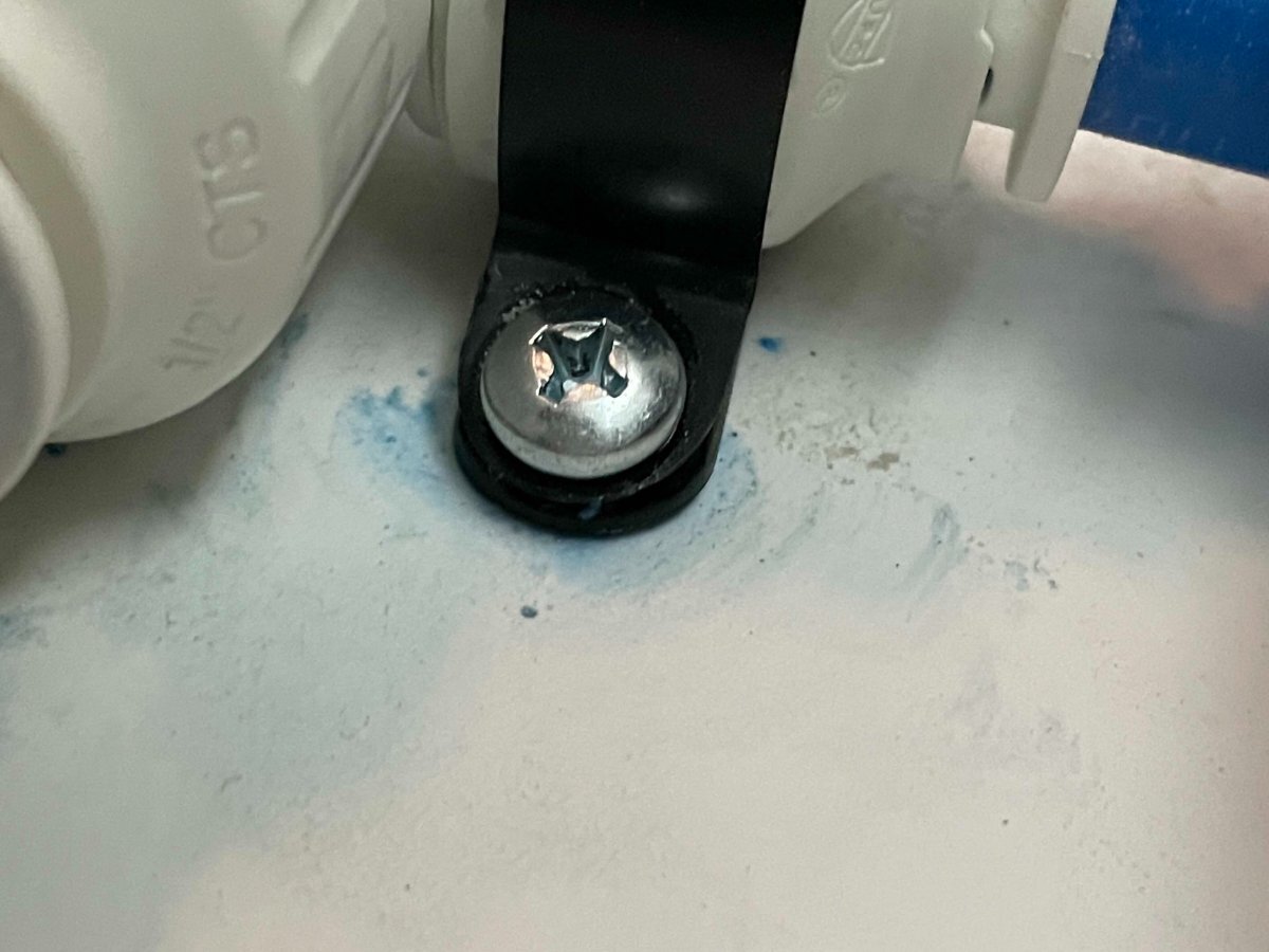

I purchased both #8 and #10 x 5/8" screws yesterday.  I wandered through the hardware and pondered all the glues, epoxies, and wood fillers, but felt that I should begin with the medium locktite that is already in my kit.  I tried to post a video to demonstrate, but suffice to say: there is no purchase for any type of screw. It's useless.  **hints on video uploads?**
I installed only one of the screws, because I expect it to fall out tomorrow when I drive to my next destination.  I did not remove any screws; only 3 of the original 7 that I can see are still in place. I will update here after some towing, about whether this screw stays in place.

The rigid "foam" board is what we have in our Hull #1291 manufactured in October, 2022.  It may not be apparent in the photo below, but our mounting board is not solid PVC.  It has a "foamlike" feel to it, especially on the edge.  It feels to me like it is a cross between solid PVC board and foam insulation board.
That said, we have had no issues with screws loosening from that board, but we avoid driving on bad roads with our Oliver.
I second Mossemi's "one size up" and Geronimo John's silicone adhesive recommendations.  A "little dab'l do ya" on the screw threads.

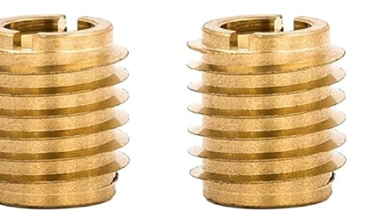

This doesn’t answer your question directly, but may give you some food for thought.  When I did the full Victron electrical system upgrade, I wanted to also upgrade the mounting method of most of these components.  As you have found, sheet metal screws into PVC board isn’t exactly the most secure.  So for most of the components  I installed, I also used brass threaded inserts of various sizes - depending on the weight of the component and the mounting - vertical or horizontal.  It’s a little more work, but it’s a very secure mounting method if installed correctly.
https://www.amazon.com/Z-Threaded-Insert-Internal-Threads/dp/B00207NF6W/ref=sr_1_8?dib=eyJ2IjoiMSJ9.DGW1I2sdUlWBQMbecRdN1iMmRcq6Ckucrt-5cHlTGY5RYWzcdmFoUG4qRk6LclmKYaxzhYX3lC7tfKsu8RDNblUeEkg54NBy50z3oBTFE5ZeP59dsYyB4WHq758aJz0K8CHMucPo9GtVKiC5c2rR4i4KRmqwaw1-nVPauSmq1tey0aUXEeRBoIQcNAFNdicNHu3sHwVWwfrgj5PemUXIGRHLK2gziE078GGFLwrPe74._T9JMhLIQjGnr1JN_QYoT8MS7rGJPVIZT_YbZ3oUNjc&dib_tag=se&keywords=threaded%2Binserts&qid=1759539352&refinements=p_n_material_browse%3A17548933011&rnid=17548926011&sr=8-8&th=1
Did you install them into the existing foam core board? If so, did you use epoxy on the outside of the brass?
Yes, the inserts were installed in the factory board, but I also added several pieces of Azek PVC board that I had on hand.  No, I did not use epoxy on any of the inserts.

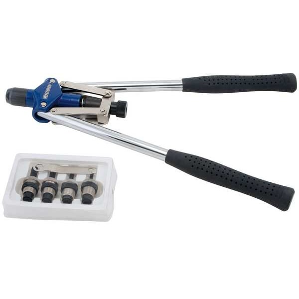

I prefer to use Rivet Nuts (AKA RivNuts/Blind Flange Nuts).  They have the advantage of expanding on the far side of the connection as well as board strength for pullout.  I've found them to be quite strong when the surface being mount to is solid.  Would not work on "foam board", but for PVC and metal they are super... at least from my experience.
Edited by Geronimo John
18 hours ago, Geronimo John said:
These fasteners rely on the strength and having thicknes of the mounting board.

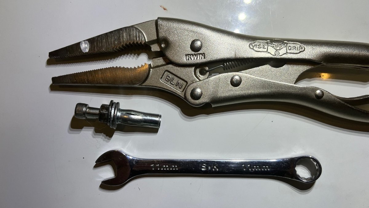

I've used both of these type of nuts.  Airplane mechanics call rivnuts "the spawn of the devil" because they inevitably come loose and start to spin.  They are difficult to then either remove or squeeze again to try to tighten them up.  That being said, I've had a couple of airplanes where these are used (and yes, some have come loose).
The benefit of the threaded type inserts is they can be installed in much more cramped spaces - like the bays of the Oliver.  The rivnuts (especially the large ones needed to mount the Victron Multiplus II) require a tool that is too large to fit into the bays.
Zoro Select Rivet Nut Tool, Aluminum / Steel, No. 10-24, 1/4"-20, 3/8"-16, 5/16"-18 5TUW5 - main
Me too. Love the threaded inserts that @katanapilot suggested for use in wood and perhaps PVC and other synthetic boards, minimum 1/2" thick and the board has to be of a woody-like substance that will take the threads of the inserts without cracking.
Like the rivets that @Geronimo John suggested, for as he wrote, for thinner materials (where a threaded insert would not work). I used a different kind of rivet than the one pictured above (see link below).

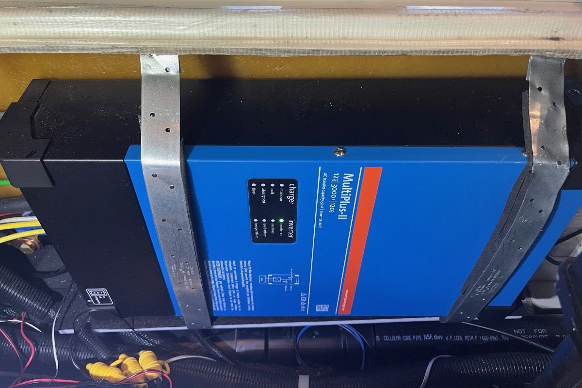

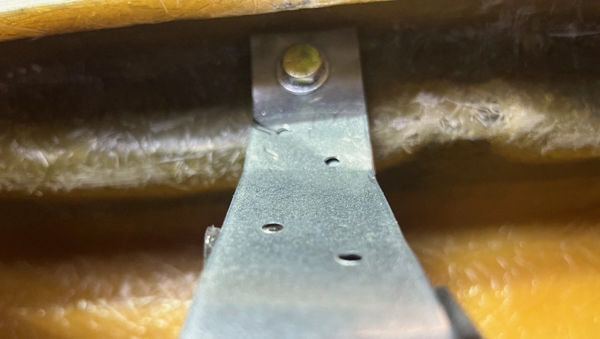

When it comes to something as heavy as the Victron Multiplus II (64 lbs), it should not be mounted to a board with any kind of fastener, when the board is merely glued to a vertical surface. This is why I built a platform, for it to sit on, and then strapped the MP2 connected at the top with rivet nuts to the inner structural fiberglass that supports the bed platforms. I also did not purchase any long rivet tool. I used a longer bolt and extra nut to compress the rivet in place (see pics). These are the 1/4"-20 "Plus Nuts" I used and I also bought an M5 set for lighter needs.
