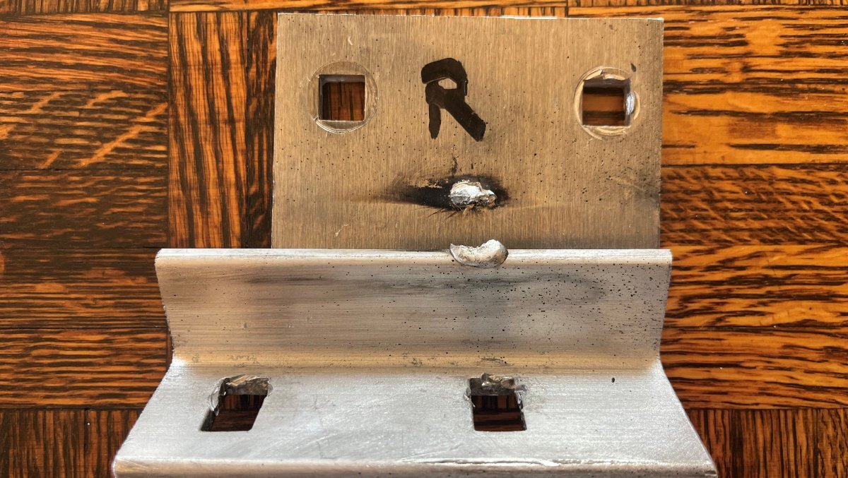

I recently found OTT forgot to fully weld (tack-weld only) the mount to one stabilizer jack. OTT blamed Barker, but actually OTT makes these welds as part of the standard installation procedure. I made a new bracket with $10 of steel. We also had two small welds fail on the frame, two cross-members were hanging on one side. Local guy welded them for $75.

It is my understanding that OTT makes the jack brackets and provides them to Barker.
Good to see you're back John, safely returned home from your annual mainland trip and contributing here as always! 😂
This is a point of confusion that it seems even Mike Sharpe did not understand the full installation process when I talked to him on the phone, hence his thinking this was a Barker issue (not).
The bolt holes that OTT drills into the lower hole and frame are not drilled to precision so that a one-piece bracket can be used (e.g. precision in distance between holes at +/- 0.010"). The ALUMINUM brackets are made by Oliver (same aluminum used in the frame). All Barker components are made from STEEL! Barker welds the STEEL bracket to their jack for Oliver and they have a special Oliver-only part number (learned from talking to Barker rep).

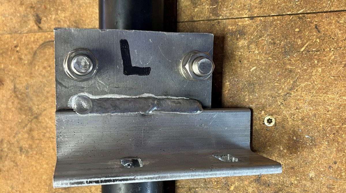

After the jack is put in place, the two aluminum brackets are tack-welded. Then they must be removed and fully welded on a workbench, then final installation bolted/torqued into place. If they were manufactured to length (welded by Barker), there would be no reason for a tack-weld followed by a complete weld. In fact they would use a one-piece bracket. Why are these aluminum parts when steel is used for frame pieces? Because OTT only welds aluminum! More info in my post linked below.
I can see exactly how it was originally installed by removing and reinstalling these jacks. I believe I have done more jack work than any other Oliver owner, now that I have rebuilt all 3 jacks, ready for the next 10 years! 😎

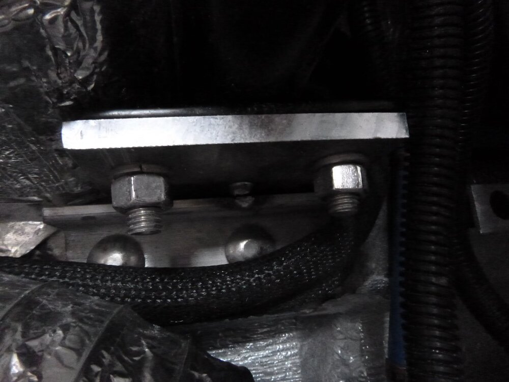

@jd1923 OTT must have changed their jack bracket setup. This is what we had at the base of our jacks.
Looks like what you fabricated.
Also the source of one of our other problems. If you look here, you'll see the square hole circled in red is larger then the other.
Too large, in fact. The carriage bolt just spun around in the hole and couldn't be tightened. I found this trying to trace down the cause of that jack creaking under load. Don't know how that passed QC and got the little green marks on the head and nut.

I attached a picture of the tack-weld failed mount when I submitted a service ticket and was told OTT did not have brackets they could send me!
My next service ticket was re artwork for the front hull. When I was told again NO, I asked why I should ever again enter a service ticket? Five (5) times and not once have I received useful help. But then, if you want something done right…
Obviously they do have these brackets. At least the one I fab’d is better than OEM. My square holes for the carriage bolts are of correct size. No need for precision when you drill holes that wide! It’s not easy making square holes in 1/4” steel in a home shop, but should be EXACT when manufactured!
if yours is still lose, replace them with hex-head bolts, use a washer and position a wrench on the topside, against the bracket, while you tighten from down below.
And BOTH bolts holes are too large. When they are the correct size you will not see the square opening at all as it should be completely hidden by the head of the carriage bolt.
