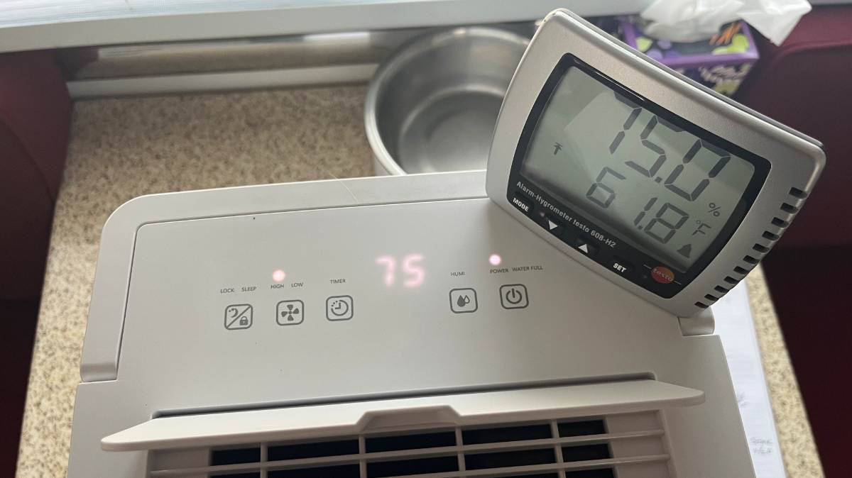

Roger Posted December 25, 2025 Posted December 25, 2025 17 hours ago, John and Debbie said: Roger, I did as you suggested and got a new one when the price dropped to $98. I have had it plugged in and running 24/7 for a week now after letting it sit upright for over 24 hours. I am getting about a cup of water daily in the tank, so am pleased with how it's working. I do have a Vornado heater running at low fan speed and the Truma set at 50°. I have all the cabinet doors open. I am happy with it. John John, I am glad it is working for you! One thing I have also learned about the unit is you MUST lift up the baffle at the top or it just doesn't work very well. Don't ask how I learned this (more than once 😁). I am thinking about removing the baffle so that I don't forget to open it in the future. 3 2021 Elite II Twin Bed Hull #1023 - Kimba | 2025 Ford F-350 6.7 Diesel
