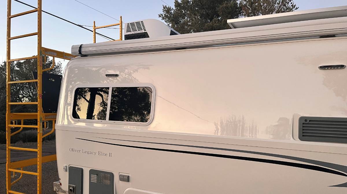

Some owners have height restrictions.  This unit "stands tall" at about 14", a good 5" taller than our OEM Dometic.   A hard deal killer for besome owners for sure.
Agreed, but... Looking at the specs I see a 3.25" difference (14.5" - 11.25"). It would be 5" to your low-profile Houghton.
I promised @Tideline77 measurements which I took yesterday. My son Adam climbed up the scaffolding and place an 8' 1x3" on top of the A/C unit hanging off to the curbside. I measured the height and did not believe the number, so I measured it in the same way off the streetside, same number! I measured exactly 9' 8.5" on BOTH sides!
This is great news and thank you for measuring !

I have since updated the post.  The 5" increase is from my Houghton A/C height.  JD's remeasured and it is 3.25" higher than the Dometic Penguin II.
In our case, there is no way I could back it into our storage area.  Especially since there is a ramp at the entrance and that kicks the area behind Ollie's axles up even further. So if height of your storage areas is close, it would be wise to double check.

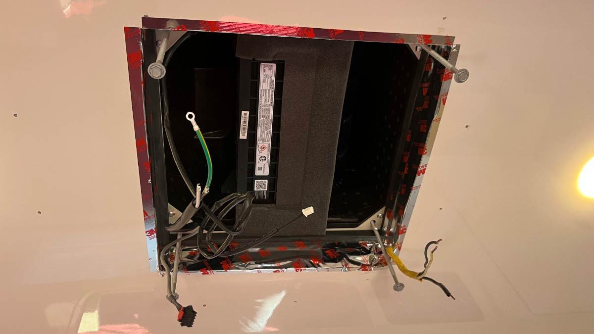

First step was to remove the Air Distribution Box (ADB) of the old A/C unit. Spend time cleaning the roof after removal. I had removed the old unit, plugged the 14x14” opening, prior to having the Oliver cleaned, stripped, buffed and ceramic coating. The new A/C unit is now mounted on a perfectly polished roof. At least clean the opening well so the new units seals well.
Oh man, as usual, OTT with their drill-happy installers, we now have eight (8) drill holes in our ceiling! To date, I’ve had to fill over 30+ holes in interior and exterior holes in the fiberglass (beside here, the thermostat, the old inverter switch, the corner TV mount, the sat dish, Wi-Fi Ranger, both exterior cameras, etc.) OMG! Fortunately, new models like the Turbro and Furrion Chill Cube mount the ADB to the interior frame that’s bolted to the outside unit. If I had installed the original Dometic P2, I would have figured out a work-around, bolt to the frame or if need use 3M VHB on the edges vs. 8 screws.

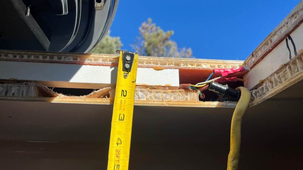

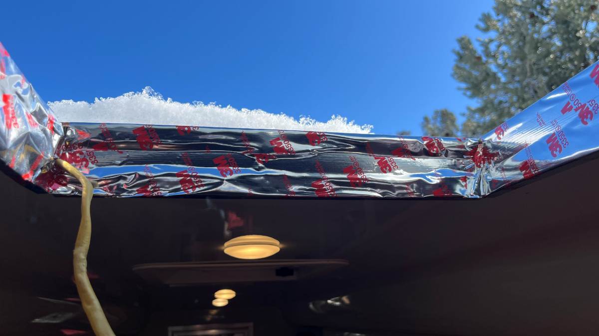

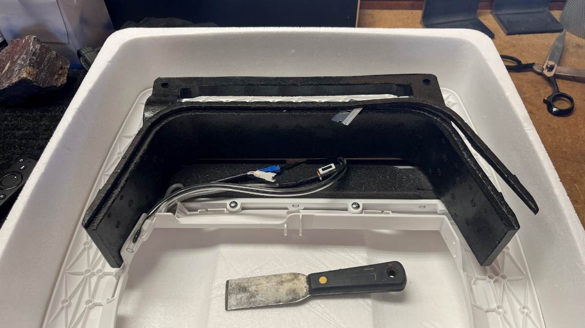

First measure the thickness of the opening (pic1) to know how much to trim the air baffle that fits inside. Cut off the thermostat wiring connectors and push remaining wiring and condensate drain plumbing into the ceiling, leaving only the 12 AWG 120VAC Romex wiring. Then I covered the opening with 3M 3350, a thin foil duct tape. I used one 14” length above and below wrapping about 1/2" on the roof and ceiling so it would stay sealed (pic2).

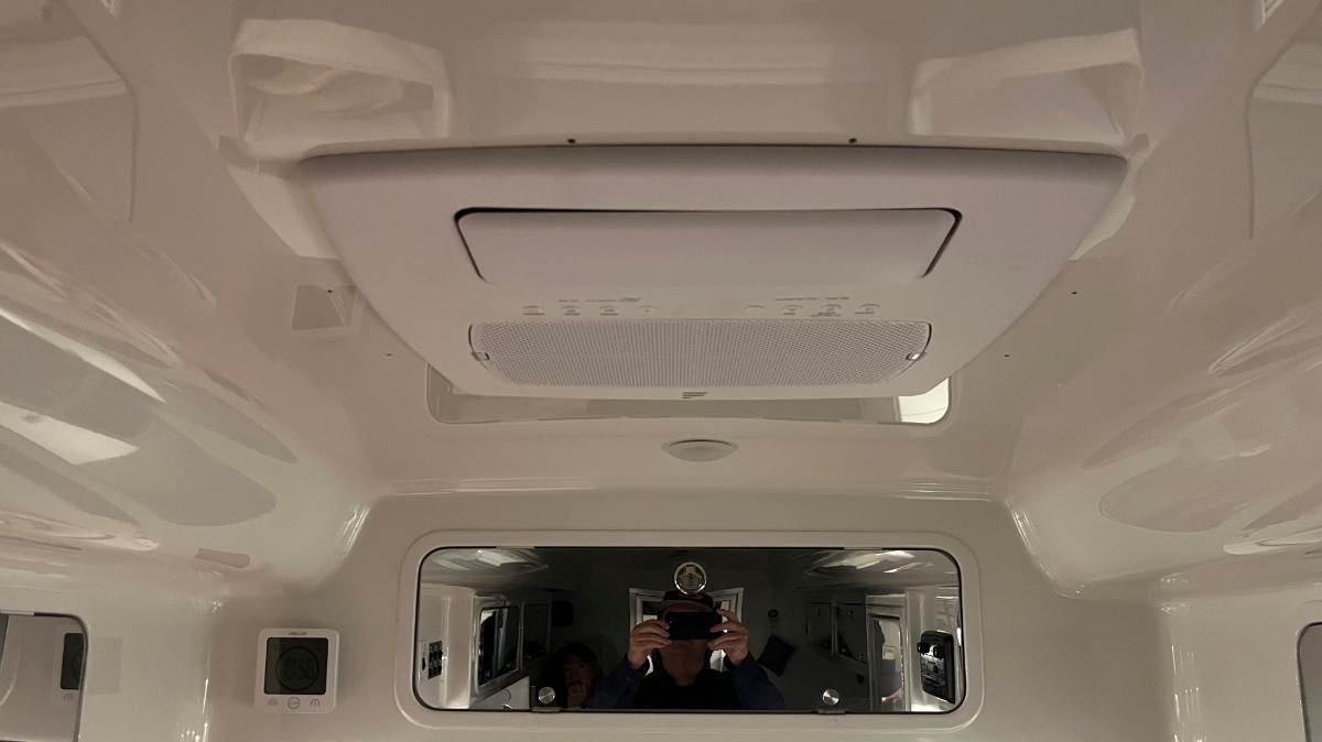

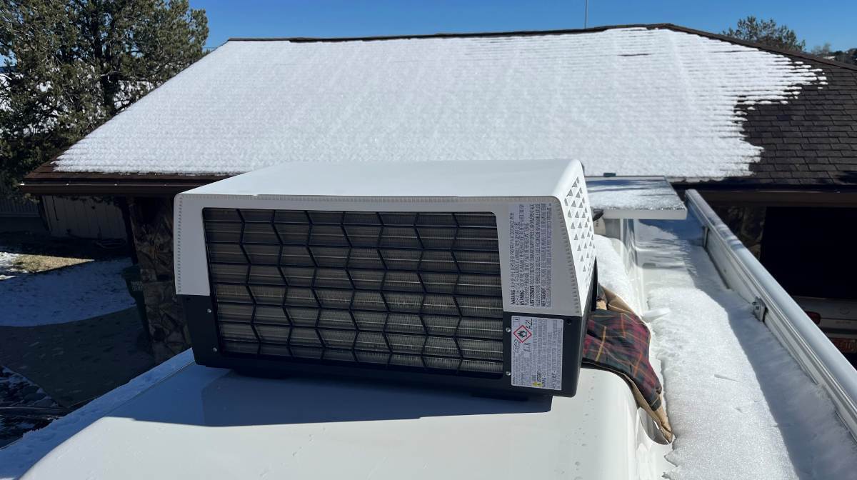

Adam and I got up on the scaffold to remove the defective (and refunded) Turbro unit. We set one scaffold cross beam and the same height as the roof so to have a place to rest the A/C on the way down. When we picked up the new Chill Cube, Adam said, “Wow, this one is light!” (Turbro weighs 88.2 LBS and the P2 was heavier, the Chill Cube is 72.4 LBS.) It’s also easier to maneuver with it’s tall square shape, foot-print about 60% of the others.
I forget a bath towel like we used last time, so I took off my jacket to have something to help slide the top unit into place. Then inside, I pushed up on the A/C and pulled the jacket down through the opening. Screwed in the four corner bolts, to see and align the exterior unit over the opening. You don’t need the air baffle extension, and the primary hard foam baffle must be trimmed. I trimmed ours about 1/2". When you measure, realize the foam seal on the exterior unit once torqued should also be 1/2". If you trim too much (bad mistake) you will have a gap between the warm in and the cold air out! Better to error on trimming too little, but if it’s too tall it will be pushed up against a hard plate and could crush. I first cut only 1/4" off and it contacted the upper plate before the foam seal compressed at all. I then knew another 1/4" had to be trimmed. Better to do it twice, than to over cut! (many pics to follow)

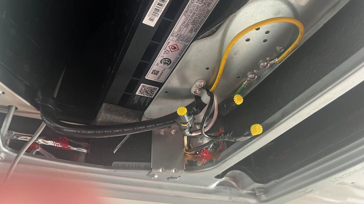

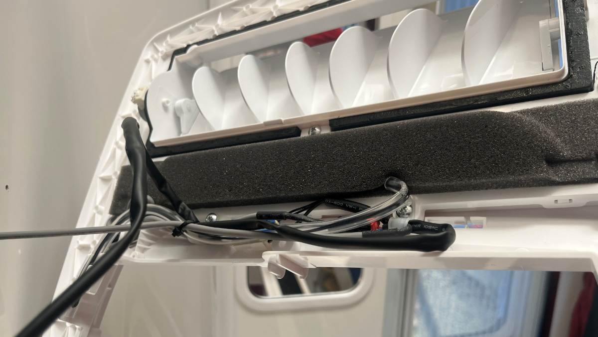

I was not able to use the 120VAC connector they supplied and used standard wire nuts instead. I also made a hole into the foam baffle to get the Romex into the center area. I moved the wire clamps to be usable based on the where the Romex was installed. Not easy to fit all the wires in the narrow center area. The extra length of some cables can be inserted into the junction box. The main thing is you have to feel the center mounting screw will seat without any wiring obstructing it. The instructions say to use the long screws for the plastic air handler, but they do not supply any! I used two long screws I had to get started, but once the plastic cover snapped into the metal frame all I needed was 5 of the supplied 1/2" screws. Mount the filter components and you’re done! (Notice the screw holes in last pic. I still need to patch the ceiling fiberglass.)
