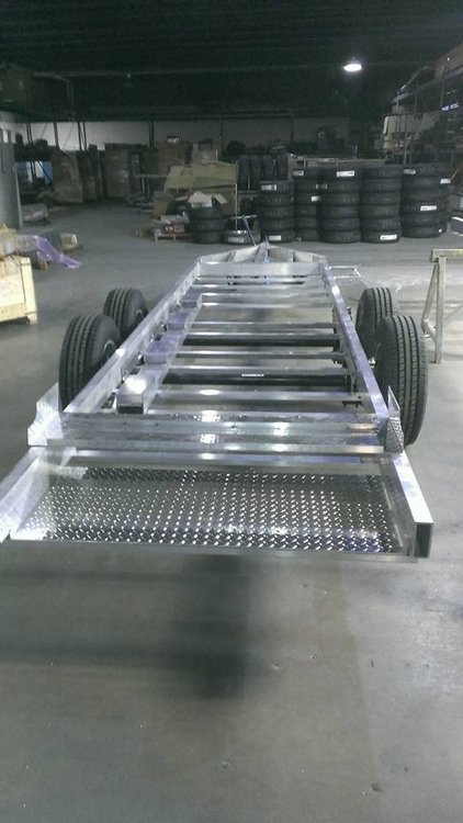

rideandfly Posted October 8, 2016 Share Posted October 8, 2016 This really makes one appreciate the sometimes referred to as “overbuilt” Oliver frame. Here's additional Ollie frame photos taken earlier this year during a factory tour: Frame upside down in the frame weld fixture: Bill & Debbie / 2015 LE2 #75 / 2024 F-150 5.0L / North Carolina Link to comment Share on other sites More sharing options...
Overland Posted October 8, 2016 Share Posted October 8, 2016 I don't know about the Oliver frame being over-engineered. Intuitively, it looks strong, but the only evidence we have that it lives up to its appearance is the fact that we don't have people complaining of failures. Thats good evidence as it goes though. I remember being told that Oliver strengthened the frame at some point - I don't know the motivation behind that. Perhaps it's academic. I don't know what effect the frame stiffness has on towability - perhaps some. More importantly, I don't think the overall stiffness of the frame is as important to an Oliver as it is to many other brands. On most trailers, the frame is truly the foundation off of which everything is built. On the Oliver, the hulls seem structurally sound enough on their own, so the frame mostly serves to distribute the loads from the suspension. One nice bonus of that arrangement is that if the frame ever did fail, I feel like it would be fairly easy for Oliver to lift the hull off the frame for repair or replacement, rather than writing off the entire trailer like you'd have to with the cheapy stick built brands. What's important to consider on the Oliver frame is the tongue section and how well it absorbs vibration and loads from both the trailer and the tow vehicle. Welded aluminum is always a cause for concern - it's a tricky weld in that it is very easy to overheat the aluminum surrounding the weld, which causes it to loose strength and become brittle. That said, a good welder is a good welder, and Oliver seems to have some good welders. One thing I like about their design is that the weld joints are staggered so that there isn't a straight line of joints going from side to side that are subjected to direct bending forces. The staggered arrangement means that each joint for the most part experiences only shear forces. For highway driving, I would put all the trust in the world in it. I'm a little nervous about long-term gravel road use because of the constant vibrations. I agree with John that the EZ Flex equalizers are a good buy if you plan to take the trailer on rough roads. I'm considering going a step further with the Center Point equalizers but that may be overkill and isn't an easy swap out like the EZ Flex. http://www.lci1.com/center-point One thing I'd like Oliver to offer, perhaps as an upgrade, would be a set of gusset plates at the key stress points of the frame that are huck bolted to the frame. Again, that's arguably overkill. I'm definitely looking forward to Bill's thread on his sway control unit. 1 Link to comment Share on other sites More sharing options...

Raspy Posted October 12, 2016 Share Posted October 12, 2016 In the end we can talk about the differences between steel and aluminum all day long, but we don't have enough information to say definitively that aluminum, in this case, is a problem. And I have no intention of saying it is. Just because aluminum has a different fatigue character than steel, doesn't mean in this case that it will fail. Way too many factors are not being included to make that analysis. The frame on an Ollie seems to have different functions in different places. In the tongue area it must have bending strength to transfer the tongue weight to the hitch. It must also carry the pull from the hitch. Out back it just offers a bumper mount that protects the body from a hit. Over the suspension it spreads the weight to the "support truck" which is the steel suspension assembly subframe. It definitely doesn't act in the same way as the frame on a conventional trailer where everything is assembled piece by piece with the frame supporting it all, as the build proceeds. Having said all that, Ollie's entire structure is flexible and I hear it creaking whenever I load the jacks. The frame works in tandem with the inherent unibody strength of the Oliver body, but it's not absolutely rigid. All of the trailers I've looked at with steel frames have two frame rails that get to the front of the body and then come together at the hitch. Oliver front sections are way more reinforced and beautifully built. I just went through one of the most severe 4 wheel drive roads I could get it through. No problem at all as I watched the suspension flex and tried to avoid dragging the frame. I fully intend to use this trailer to it's limit as we go desert camping and exploring old trails. Rather than second guessing it's design, I marvel at it. 4 John "I only exaggerate enough to compensate for being taken with a grain of salt." LE2 #92 (sold), Black Series HQ19 Link to comment Share on other sites More sharing options...
