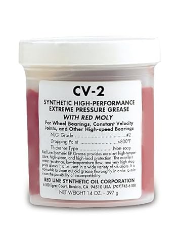

John E Davies Posted January 11, 2017 Posted January 11, 2017 Red Line CV-2 isn't on the list but it is simply stellar for high load applications like CV joints and wheel bearings. It is hard to find locally tho often an automotive speed shop will stock it. It is a pretty light red so if your bearings get contaminated it is easy to see, unlike with black moly lubes. You can buy 14 ounce plastic jars or tubes. https://www.redlineoil.com/product.aspx?pid=82&pcid=17 Amazon carries it, and it has a five star customer rating. Many consider it to be the Best of the Best. https://www.amazon.com/Red-Line-80401-Synthetic-Grease/dp/B0053O9FQS Nobody has mentioned that mixing different types of greases can be bad - most especially mixing synthetic and petroleum based ones. It is best to choose one brand and type and stay with it long term, especially for suspension zerks where you are not physically cleaning out the old stuff, but instead you are just adding a few pumps of new.... John Davies Spokane WA 1 SOLD 07/23 "Mouse": 2017 Legacy Elite II Two Beds, Hull Number 218, See my HOW TO threads: Tow Vehicle: 2013 Land Cruiser 200, 32” LT tires, airbags, Safari snorkel, Maggiolina Grand Tour 360 Carbon RTT.
John E Davies Posted January 11, 2017 Posted January 11, 2017 For those of you worried about wasting a tube of expensive synthetic grease, you can buy a mini gun that does not use cartridges, and simply keep topping it up from the jar as needed. It would be good for carrying inside a couple of freezer bags on a long road trip, but no mini gun works as well as a big lever type or pneumatic one. Of course those can also be refilled, you don't need those cartridges. It is messy..... BTW I don't know anything about the gun in the video, but this little one is good ... https://www.amazon.com/Astro-101-Grease-Needle-Nozzle/dp/B000FMK7FG/ref=sr_1_1?ie=UTF8&qid=1484155079&sr=8-1&keywords=mini+grease A needle fitting works fine on a zerk but you must hold it hard in place at 90 degrees to the fitting. Another reason to have them facing inboard. John Davies Spokane WA 1 SOLD 07/23 "Mouse": 2017 Legacy Elite II Two Beds, Hull Number 218, See my HOW TO threads: Tow Vehicle: 2013 Land Cruiser 200, 32” LT tires, airbags, Safari snorkel, Maggiolina Grand Tour 360 Carbon RTT.
