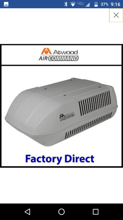

trumpetguy Posted May 19, 2017 Posted May 19, 2017 I replaced the original Coleman Mach 8 with an Atwood and was very happy with the unit. Snowlakemike owns that trailer now so maybe he will chime in. I solved the thermostat issue with a digital thermostat controlling a relay to the AC. Exactly like some Casita owners have done. My AS has Dometic Briskair II and I did the same mod for it. I would buy another Atwood if needed, but check the service first because someone told me Dometic bought Atwood last year. 1 Current 2007 Airstream Classic Limited 31 2015 Oliver Legacy Elite II (Sold) 2016 Ram 2500 HD 6.7i Cummins turbo diesel

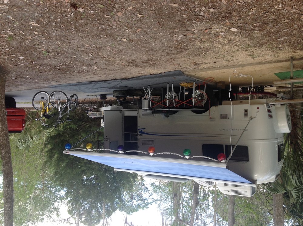

trumpetguy Posted May 19, 2017 Posted May 19, 2017 This is for the member who messaged me about the appearance of the Atwood Air Command [attachment file=20160410_202601838_iOS.jpg] 1 Current 2007 Airstream Classic Limited 31 2015 Oliver Legacy Elite II (Sold) 2016 Ram 2500 HD 6.7i Cummins turbo diesel
trumpetguy Posted May 19, 2017 Posted May 19, 2017 It wasn't upside down on my iPad. Don't know what happened. Apologies. Current 2007 Airstream Classic Limited 31 2015 Oliver Legacy Elite II (Sold) 2016 Ram 2500 HD 6.7i Cummins turbo diesel
Raspy Posted May 19, 2017 Posted May 19, 2017 Maybe that picture was taken in Australia! 1 John "I only exaggerate enough to compensate for being taken with a grain of salt." LE2 #92 (sold), Black Series HQ19

rideandfly Posted May 20, 2017 Posted May 20, 2017 It wasn’t upside down on my iPad. Don’t know what happened. Apologies. Rotated the photo for you!!! 1 Bill 2015 LE2 #75 2024 F350 6.8L
Windwalker Posted May 29, 2017 Posted May 29, 2017 I had the same issue with my ipad photos and have since learned that the ipad needs to be held with the home button on the right in landscape mode and at the bottom in portrait mode it seems that the problem is in the settings on the pc equipment on Olivers end. Doesn't seem to be a problem on a Mac computer got to love them they just work. Marc
