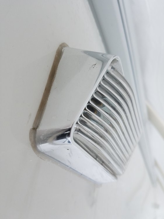

donbob3 Posted February 3, 2017 Posted February 3, 2017 My trailer in #140 and was picked up May 5. The porch light gasket is still creating a stain and it will not just wash off. I know that #136 has the same problem. I am hoping that all we have to do with the replacement gasket is remove 2 screws per fixture and install. 1
Moderators Mike and Carol Posted February 3, 2017 Author Moderators Posted February 3, 2017 My trailer in #140 and was picked up May 5. The porch light gasket is still creating a stain and it will not just wash off. I know that #136 has the same problem. I am hoping that all we have to do with the replacement gasket is remove 2 screws per fixture and install. Maybe May trailers got a bad batch of gaskets? Mike and Carol wrote: The black gaskets around all of my porch lights bleed black whenever they get wet. Does anyone else have this problem? Considering they are fairly new and under cover when not out on the road it doesn’t seem possible they could be breaking down already. Thoughts? Mike and Carol, You are not alone. My 2016 Oliver had bleeding around outside lights just like the one shown in your picture. I have had no leaking inside of the trailer and the rubber gaskets didn’t seem to be failing in any way, but having black streaks running down the side of the camper was not something that I wanted to see. I have in my bag of tricks a product that I’ve been using since my sailing days down in the Caribbean. “DAP Dow Corning 100% Silicone Rubber Aquarium Sealant”. I’ve had the same tube for about 8 years and it still mostly full and still usable. I put some on my finger and wiped it around lights, lightly covering the black rubber gasket. I did this a couple of times. You can hardly see it after being applied. To this point I’ve not had any more issues with black streaking. I even had it washed at the Blue Beacon truck and RV wash the other day and still no streaking. I would encourage everyone to have this product in your bag. Hap, good to know. I will look to get a tube. Hopefully, Jason will get some replacements soon. Texas Hill Country | 2016 Elite II #135 | 2020 Ram 2500 6.7L Cummins
Hap Posted February 4, 2017 Posted February 4, 2017 My trailer in #140 and was picked up May 5. The porch light gasket is still creating a stain and it will not just wash off. I know that #136 has the same problem. I am hoping that all we have to do with the replacement gasket is remove 2 screws per fixture and install. Donbob3 The product that I use to remove stains is 303 UV Protectant. I use it to wax our Oliver before we leave for a long trip and then while traveling I just use 303 on the front of the trailer after I wash it. It works great for me especially protecting from love bugs, road tar, etc. A lot of sailboat owners use it for to protect their boats. It can be purchased at Westmarien stores, Camping World Stores. I purchase it on Amazon by the gallon which will last me for several years. I've used it on boats, a motorhome, and two travel trailers and love the stuff. You can get a lot more information on Amazon and by reading their reviews. Once again I just wanted to let you know what works for me. Hope it helps Hap Short for Happy as in happy to own an Oliver Travel Trailer especially after seeing some of the other RV's out there. 2
donbob3 Posted February 10, 2017 Posted February 10, 2017 Spoke with Factory (Oliver) today. There will be no replacement gaskets. Manufacturer does not consider it to be their problem. I will coat my gaskets tomorrow. I have acquired two sealants: Marineland: acquarium sealant 100% clear silicone rubber -waterproof -harmless to fish. Adheres to rubbers. Liquid Nails Sealant: Clearer than silicone - Clear Seal all purpose sealant - 50 year durability - weatherproof seal - excellent adhesion. Adheres to rubbers. Did not find the DAP Dow Corning product in stock locally. My choice depends on not harming fish or 50 year durability.

Try2Relax Posted February 11, 2017 Posted February 11, 2017 These are the old style, which I have, and have never had an issue. Unlike the shore power connection gasket, which streaks. This is the newer light they switched to last spring The pictures on the main site don't look like they changed since then. Randy One Life Live It Enjoyably 2017 F350 6.7L SRW CC LB 2015 Oliver Elite II Hull #69
GrayGhost Posted February 11, 2017 Posted February 11, 2017 I have hull #98, which was delivered in Sept 2015 to the original owner. As with Try2Relax, I have the old style lights with no streaking, but streaking around the shore power gasket. It's almost like soot. It takes very little moisture to produce the streaks. Seems like an oxidation problem. The streaks come off easily enough, I just worry about the gasket integrity and water eventually getting behind it and between the hulls. 1 GrayGhost 2015 Legacy Elite II Hull # 98 2020 F150 3.5 EcoBoost
Mainiac Posted February 11, 2017 Posted February 11, 2017 So it seems the streaking is only with the new LED lights, whenever they switched to those?
Try2Relax Posted February 11, 2017 Posted February 11, 2017 For those looking to make their own gaskets, the manufacturer is ITC in Elkhart IN here is a link to the part listing, the middle photo is a dimension drawing that might help. The part number is 69710-CH-6.5K ITC LINK For those with the old ones, they are made by Diamond Group and their catalog is full of useful modification items DG catalog 4 Randy One Life Live It Enjoyably 2017 F350 6.7L SRW CC LB 2015 Oliver Elite II Hull #69

KarenLukens Posted February 12, 2017 Posted February 12, 2017 Actually, the simple fix is to replace them all with the white gasket material. That black has been known to bleed for decades and they've (the manufacturer) had the white material but don't use it because it's more expensive. Happy Camping, Reed & Karen Lukens with Riffles our Miniature Poodle 2017 Oliver Legacy Elite II Standard, Hull #200 / 2017 Silverado High Country 1500 Short Bed 4x4 Past TV - 2012 Mercedes-Benz ML350 4Matic BlueTEC Diesel Click on our avatar pic above to find the videos on our Oliver Legacy Elite II
