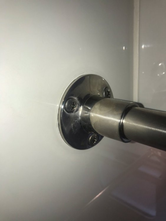

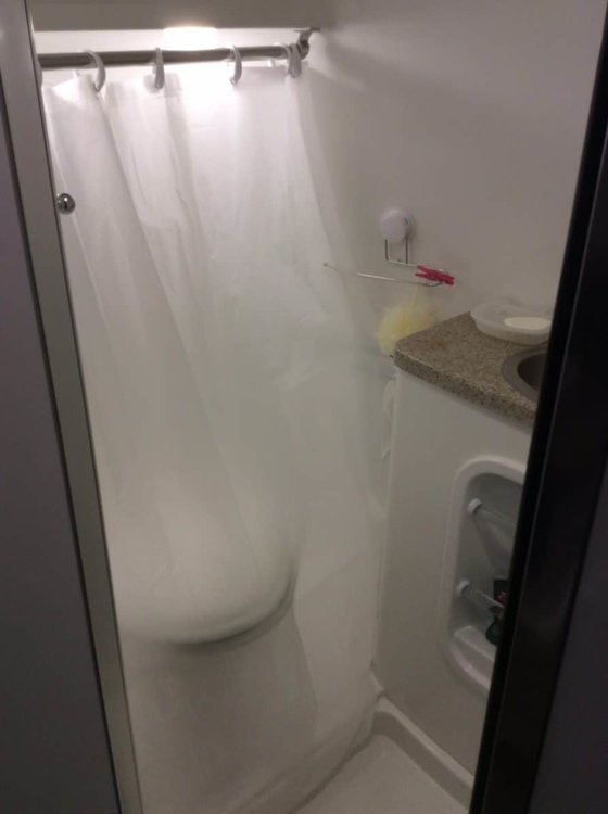

Has any member had the factory install the shower curtain rod  that goes in front of the toilet?   I would appreciate your comments and any pictures.  I am thinking about installing this during rally.
Thanks for the photos.  Did you install or did the Factory install?  I am assuming that you installed..  If u installed , did you just drill through cabinet and bolt attachment with stainless bolts? Is that a towel bar on the left?  How was that attached?  Hope to see u at rally #140.
Yes in house. All marine grade SS hardware and screws. Used 3M 5200 marine sealant. And yes its a towel rack on the left.
Greg:
Where did you purchase the shower rod from?  Also do you have the model number for the shower rod?  I assume you mounted the shower rod using SS screws and the 3M 5200 marine sealant was used around the screws.
I have been looking for a shower rod to install in the same location as your rod is mounted.
Thanks in advance for the information.
Horace & Dianne
Chesapeake, Virginia
2016 Toyota Tundra Crewmax 4x4 Limited
2015 Oliver Legacy Elite II - Hull # 93

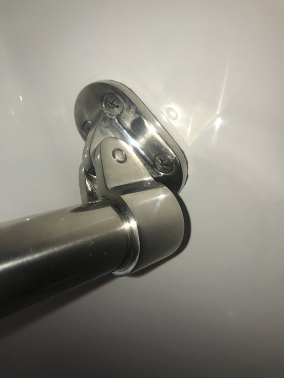

I used a SeaChoice product # 50-38291, 7/8 60 degree end rail fittings and 7/8 SS tubing. And yes the sealant is around the screws. The only trick to the install is using the right size drill bit and counter sinking the hole so the gel coat does not pop. Easy install works great.... Greg
Seems I have been asking the wrong questions. Maybe I have been talking to the wrong person? I have never heard about a shower/curtain rod being available for in front of the toilet. What a great idea and time saver! As I look at the pictures, what an easy modification to do. A piece of masking tape, under the bracket, to draw the location of the pilot hole should also keep the fiberglass from chipping. A curtain would keep dirty clothes, a wastebasket, and all kinds of assorted items dry until after a shower A different rod or modification would also keep a towel, on the towel rod, dry. We have some quality marine stores nearby, but would think with a little 'research' (shopping) even Home Depot would produce a quality item. Thank you, looks like we have our first modification to do...

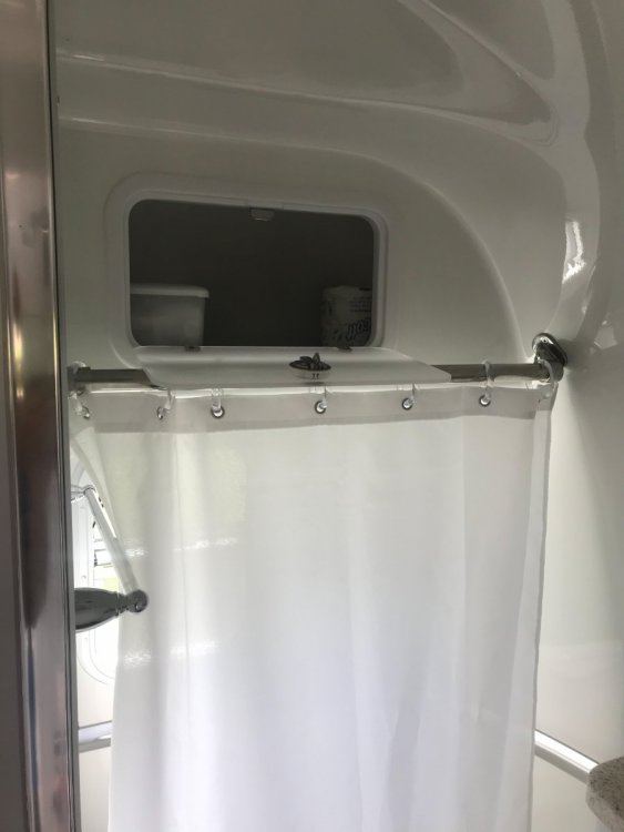

We asked for the one in front of the toilet but Oliver gave us the one over the door by mistake. So I ordered the parts and installed it myself, and now we have both, lol, though the one over the door just get used as an occasional towel rod. It wasn't hard, but I did have to do a lot of eyeball work to get it lined up just so against the curved front wall. I put mine higher and in front of the cabinet to give more headroom over the toilet and I lined it up with the bottom of the cabinet door so that when open the door sits on the rod at 90° and acts as a shelf. Very convenient. The curtain keeps the toilet area very dry, with just a little splash around the sides.

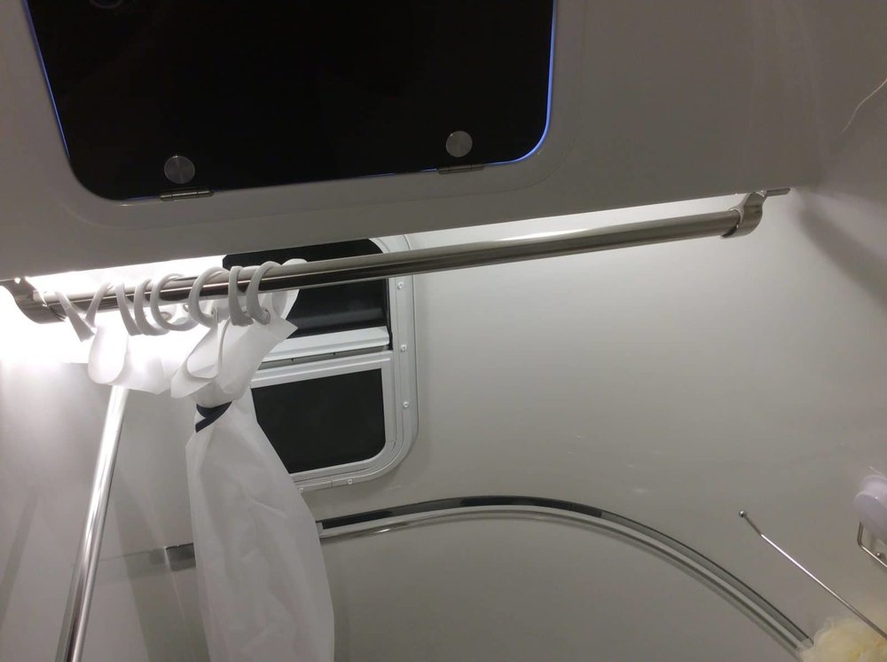

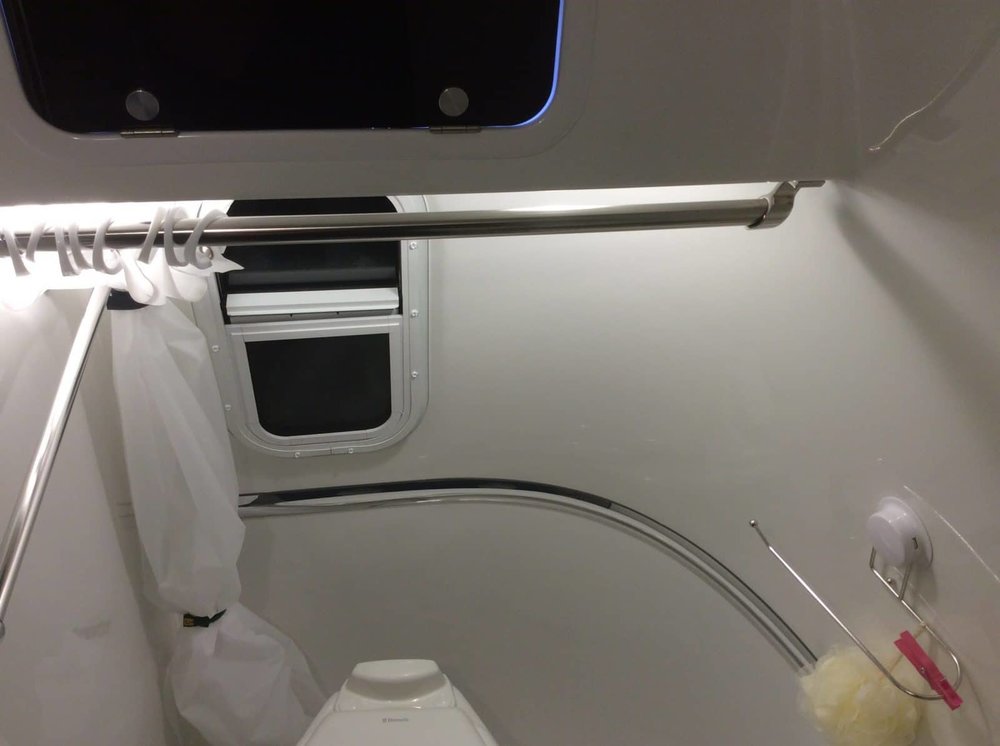

Thought I would add my completed curtain rod project.  I used Overland's style so the rod would be a little higher to decrease the chance of another mark on my bald head. I drilled a 1/16 inch pilot hole, used a countersink to smooth hole to a little bigger that 5/32 inch. Then drilled a 5/32 inch hole in center of countersink. 5/32 inch is the suggested pilot hole for a # 10 machine screw. Sealed everything with 3M 4200. The machine screws worked perfect with no cracking of gel coat and everything pulled up tight.
