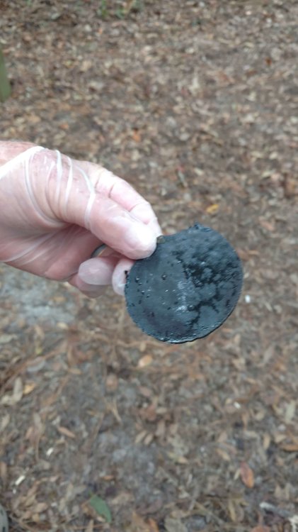

cptgringo Posted April 7, 2017 Share Posted April 7, 2017 My hot and cold water being reversed in the kitchen wouldn't Warrent a 800 mile trip to the factory for repair. If this got jammed in a valve or pipe on the way out. Now that is another story. Someone at the factory would have a messy job! 2 Link to comment Share on other sites More sharing options...
John E Davies Posted April 7, 2017 Share Posted April 7, 2017 OK, that is really distressing since it indicates really shoddy work at the factory. Switched lines at the faucet are understandable, though they should have caught the problem and corrected it when testing the system before delivery. Where did you find that disc, plugging up your waste hose? You can't leave us hanging like this. John Davies Spokane WA SOLD 07/23 "Mouse": 2017 Legacy Elite II Two Beds, Hull Number 218, See my HOW TO threads: Tow Vehicle: 2013 Land Cruiser 200, 32” LT tires, airbags, Safari snorkel, Maggiolina Grand Tour 360 Carbon RTT. Link to comment Share on other sites More sharing options...
Mainiac Posted April 7, 2017 Share Posted April 7, 2017 Switching hot and cold lines might happen when someone reaches blindly under a sink to hook up. My guess is they don't even run the water heater long enough to fill the lines with hot water to see if the faucets are running hot. Just long enough to see if not leaking and the water heater is working correctly. But it would indicate sloppy quality control or a procedure process that should change to be sure to deliver a quality product. I have had a bad experience with the "black disc" before. Most times that disc comes from when the black tank is drilled for a 1 1/2" sink drain or vent pipe. I don't see a center hole for the drill bit. The bit usually holds the disc to the hole saw. Without the bit it can fall out of the hole saw and into the tank. Usually that disc will pass out of the tank through the 4" discharge and no problem to the camper owner. Maybe sloppy quality control again or maybe you just identified a way they can improve their process. What happened to us was we hooked up a "honey wagon" to a camper. (It was a high end camper and not an Oliver). It ran well as usual for a few minutes and then struggled from extreme pressure and we had to shut it down. Poured water through the line and all was fine. Start machine and it would run fine for a while and shut down. This disc would act like a butterfly choke in a carburetor and block off the hose at a coupling. Had to take lines apart to finally find. Not a fun task. We think manufacturers should count one disc for every hole they find... Where did you find yours? Link to comment Share on other sites More sharing options...
cptgringo Posted April 7, 2017 Author Share Posted April 7, 2017 John, I agree with the shoddy work. I have found a couple of other things that also point in that direction. That being said, I've seen 800k class A's with two pages of punch list. I still think Oliver does a darn good job, but it could be better. To answer your question how I found the little goodie. I added a small extension to the dump connection in the bumper with a section that is clear . I have the fun job of watching the black tank til it is running clear. On one occasion this got stuck in the clear plastic section. Ugly Link to comment Share on other sites More sharing options...
Mainiac Posted April 7, 2017 Share Posted April 7, 2017 Yup. Now you know why some campgrounds and other places charge to dump if you don't camp. Things like that disc not only occasionally plug up campers, but can raise all kinds of problems for waste disposal systems They can lead to plugged filters, backed up lines throughout whole sections of a camping area. You think a clear plastic fitting plugged is gross, try looking out and see 12 sites bubbling greenish brown "crude". Almost as bad as 'baby wipes'. Those things can become expensive for folks down the line. Link to comment Share on other sites More sharing options...
