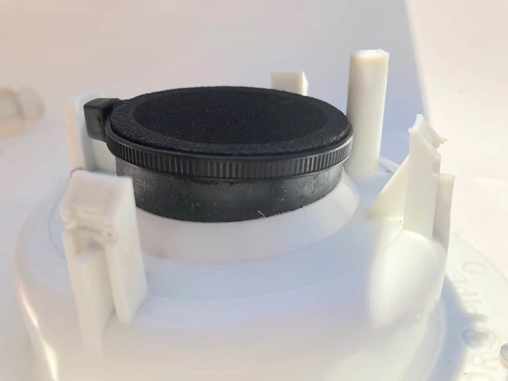

Overland Posted August 6, 2018 Posted August 6, 2018 I decided better safe than sorry on the bug thing. I had the ladder out yesterday to install the easy start on my AC, so why not add a screen to the plumbing vent while I was up there. Taking off the vent cap is just one screw and it pops off. Once uncovered, the PVC vent sticks up a half inch or so from the roof, making it a simple task to add some screen. I had a pack of these in the trailer for repairs, and they fit perfectly with just enough overlap to zip tie one on the vent. (Those particular patches come with tape around the edge, but it didn't want to stick so I took the tape off and used a zip.) Took all of five minutes, if that. Just be sure that if you go through the trouble of adding a screen that you use a finer mesh like a tent screen. I think standard screen that you'd get at the hardware store is probably not fine enough to keep out the sort of gnats that would infest your toilet. 2 3
John E Davies Posted August 6, 2018 Author Posted August 6, 2018 Nice mod. Very neatly done! BUT, if you camp in below freezing temperatures the screen may ice over due to the moist air coming up through the pipe and condensing on the mesh. Maybe, maybe not, but keep it in mind if you start to get some stinks in the bathroom in cold weather. I think some screen inserted into the vent pipe where it attaches to the toilet would be better. John Davies' Spokane WA 1 1 SOLD 07/23 "Mouse": 2017 Legacy Elite II Two Beds, Hull Number 218, See my HOW TO threads: Tow Vehicle: 2013 Land Cruiser 200, 32” LT tires, airbags, Safari snorkel, Maggiolina Grand Tour 360 Carbon RTT.

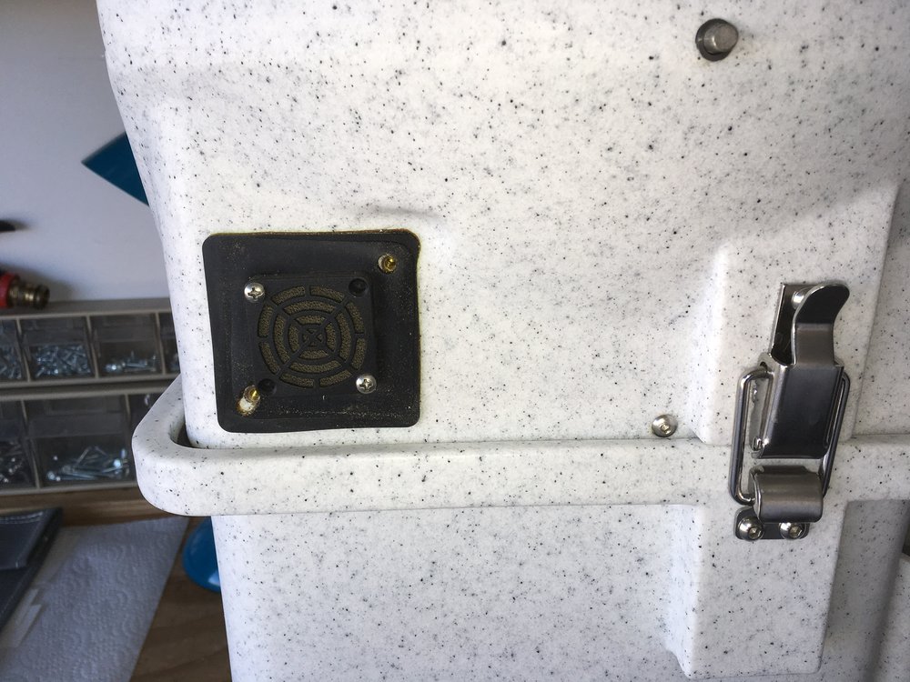

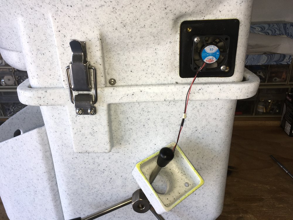

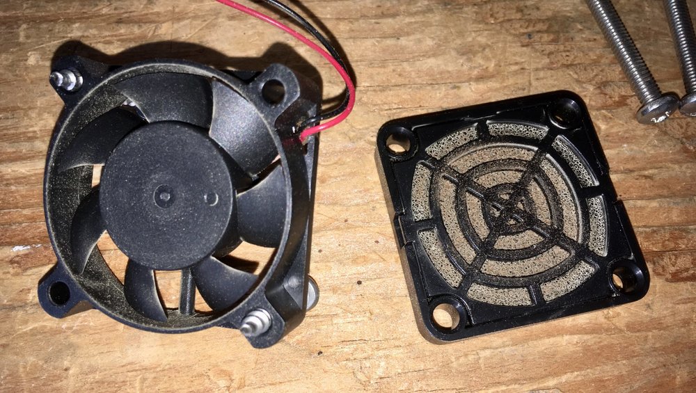

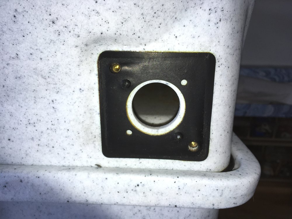

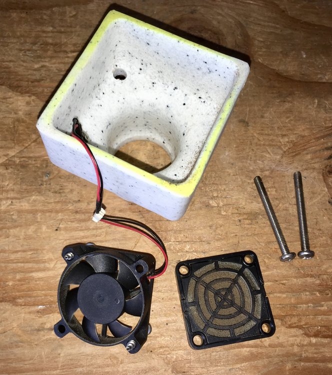

John E Davies Posted September 21, 2018 Author Posted September 21, 2018 How to inspect and clean the TWO vent air filters. Yes, there are two, one at each side opening. It is really easy if you do this when the toilet is removed for servicing and cleaning. I set mine on a workbench for easy viewing. Front exhaust filter. Remove the two housing machine screws and lower the unit onto the nearest star wheel arm to support the delicate fan wires. Remove the two fan screws and carefully pry the fan and filter away from the rubber gasket. Leave the gasket undisturbed. Seperate the fan from the filter. Blow off the accumulated dust from the filter and the fan blades (hold the fan with a finger so it does not spin). Reassemble. My filter was visually clogged with fine coconut coir dust but it was still pulling air. Note: if you keep the coir moist with fresh water from the sink sprayer, it reduces the amount of fine particles that might get sucked into the exhaust fan when the wheel is rotated. If it is allowed to dry out (turns a very light brown color on top) it will send lots of dust into the filter. Rear inlet filter. Remove the housing and then the filter, clean and reinstall. This filter was barely dirty. This was the first time I have cleaned these in 18 months. The manufacturer recommends to check them every two weeks. LOL.... I think annually is fine, unless you have really fluffy dogs that shed. After cleaning the fan did move more air. It is really important to keep positive flow of air through the toilet for it to function well. John Davies Spokane WA 3 1 SOLD 07/23 "Mouse": 2017 Legacy Elite II Two Beds, Hull Number 218, See my HOW TO threads: Tow Vehicle: 2013 Land Cruiser 200, 32” LT tires, airbags, Safari snorkel, Maggiolina Grand Tour 360 Carbon RTT.
KWRJRPE Posted September 22, 2018 Posted September 22, 2018 John EXCELLENT description, with pictures! I intend to purchase the composting on my April 2019 Oliver so this maintenance info is very helpful (as long as I can remember how to find this post when comes time to check the fan). Is there a way to "bookmark" these more helpful posts? I suspect by searching composting toilet I can stumble my way back to this post next year. 1 KWR 2019 Oliver Legacy Elite II, Hull#444 2019 GMC Sierra 2500HD Crew Cab, 4WD, Denali, Duramax 6.6L Turbo Diesel V8 Engine with Allison 6-speed transmission
