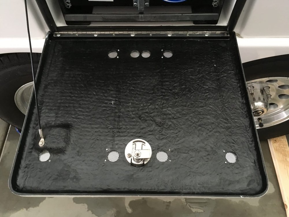

John E Davies Posted July 24, 2017 Posted July 24, 2017 Mine is not. I am wondering if they are supposed to be. It seems as if it would be a huge heat loss area. I'm wondering if I need to get mine swapped or not. Or just add insulation. I have AGMs so venting is not needed. Does anyone have a link for the type of outside panel insulation Oliver uses, in bulk quantity? Thanks for any comments. John Davies Spokane WA SOLD 07/23 "Mouse": 2017 Legacy Elite II Two Beds, Hull Number 218, See my HOW TO threads: Tow Vehicle: 2013 Land Cruiser 200, 32” LT tires, airbags, Safari snorkel, Maggiolina Grand Tour 360 Carbon RTT.
Overland Posted July 24, 2017 Posted July 24, 2017 There's insulation on the battery box itself so I'm not sure if it's necessary to insulate the door, though I suppose it wouldn't hurt. For both AGM and especially LFP batteries, it would be better to insulate the door and not the box. I believe they use Reflectix insulation. They used to spray a few layers of Lizardskin insulation, and I don't know if they still do that - it would be interesting to know. I don't know if the black that you see on the door isn't Lizardskin. I didn't think that it was glossy but it could be.
Moderators Mike and Carol Posted July 24, 2017 Moderators Posted July 24, 2017 Mine is not. Looks like yours. Hasn't been an issue even in the low 20s. Mike 1 Texas Hill Country | 2016 Elite II #135 | 2020 Ram 2500 6.7L
routlaw Posted July 24, 2017 Posted July 24, 2017 Same here no insulation, and its not been an issue what so ever. Legacy Elite II #70
Try2Relax Posted July 24, 2017 Posted July 24, 2017 I would imagine that they are all built for the lowest common denominator, that being wet cells that need to breath, and while AGMs don't require it even they can have an issue. It's easier to add a couple layers of reflectix if desired, than to drill those holes and add those little screens they put in, in case someone decides they really want to install wet cells. My trailer has the double insulation completely surrounding the battery box between the hulls, so has no more heat loss than any other part of the hull. If I knew I we're going lithium, I suppose I would request it be closed off and insulated with holes to the inside for hull heat to keep them as warm as possible when needed (requested part of build I mean) 1 Randy One Life Live It Enjoyably 2017 F350 6.7L SRW CC LB 2015 Oliver Elite II Hull #69
Overland Posted July 25, 2017 Posted July 25, 2017 I kept the vents on ours even though we're swapping out for LFPs. Like you say, it's easy enough to cover them. I doubt that Oliver would give you one without the vents anyway. The dreaded 'certification' and all that. 1
Spike Posted July 25, 2017 Posted July 25, 2017 Just checked mine. The door looks the same as John's. I too have AGMs, but the warning label atop the batteries announce that they need to be vented. Onward through the Fog! EarthPicks of Cochise County
