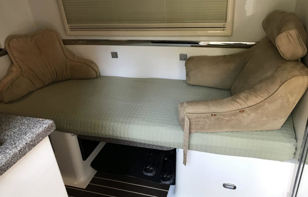

Hi Everyone,
I had this great idea....    Put the Dinette area in bunk mode to use as a couch.  We never really use the dinette seating. It's not the most comfortable, so if we are relaxing inside we sit on the bunks, but that gets old so I figured let's try the new configuration.

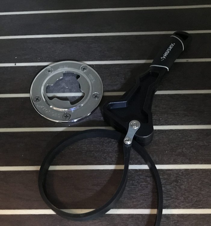

I quickly found that you are most likely NOT going to be able to remove the post by hand.   There are 3 tongues that fit under the floor bracket that attach the post to the floor.  You have to loosen the black flange and then rotate the post holding the table.  Very difficult if not impossible to do by hand.
Finally figured it would be best to use a strap wrench.  $9 and a home depot trip later and I was able to get the post removed.  I used the strap wrench on the flange first and then on the post itself.  A rubber mallet and some blue language were also employed. :-)
Pictures attached.... Comment appreciated...    So far we like it this way and will probably leave it in this configuration.

Rubbing a little paraffin wax on those tabs will make them rotate out a lot easier. Plus I don't think the tabs need to be fully twisted on to do their job if you also lock down the black collar. We like to eat outside as well but when it's blowing and snowing we like our dinette!

I don't think you would need the pole as support.  The table nests into the ledges on the seats and seems plenty strong.   I got some self stick insulation striping at home depot and ran it onto those ledges and they make it very stable and keep it from sliding or "chattering".
The existing cushions cover that distance perfectly and you can get a blanket to wrap it all up.  See our picture.   As for back cushions, you could get those made or use throw pillows.  The big negative in using this area as a couch is leaning onto the window shade frame.  I am always afraid that leaning on that too hard might crack it somewhere important.  Hard foam backs would help reduce that.
The good news is that you can make the switch right now and try it.  If the decision would be to make it permanent you can design the cushions to make accessing the hatches easy.  Post some pics of what you come up with.
