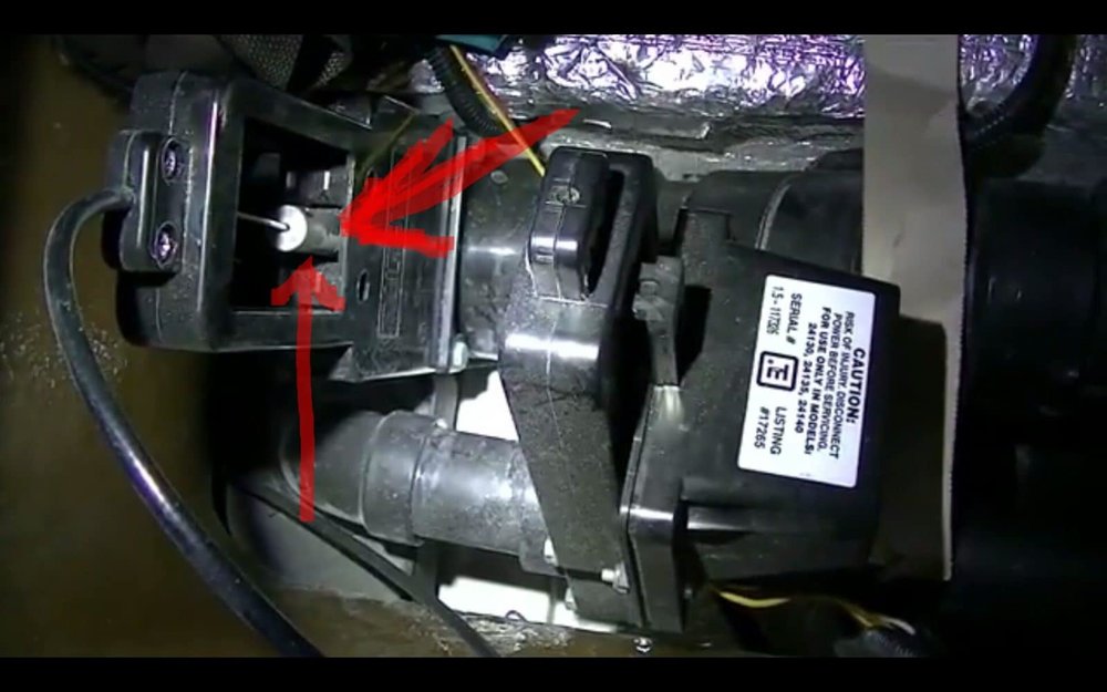

KarenLukens Posted September 24, 2017 Share Posted September 24, 2017 The pic shows the black valve but the grey valve is the same. You can pull up on the pin pictured to dump the tank with a pair of pliers or grab the plastic cable cover with your hand out at the dump valve compartment and pull the handle while letting the wire slide thru the cable to open the valve. Then just hold the cable cover again to close it :) 1 Happy Camping, Reed & Karen Lukens with Riffles our Miniature Poodle 2017 Oliver Legacy Elite II Standard, Hull #200 / 2017 Silverado High Country 1500 Short Bed 4x4 Past TV - 2012 Mercedes-Benz ML350 4Matic BlueTEC Diesel Click on our avatar pic above to find the videos on our Oliver Legacy Elite II Link to comment Share on other sites More sharing options...
