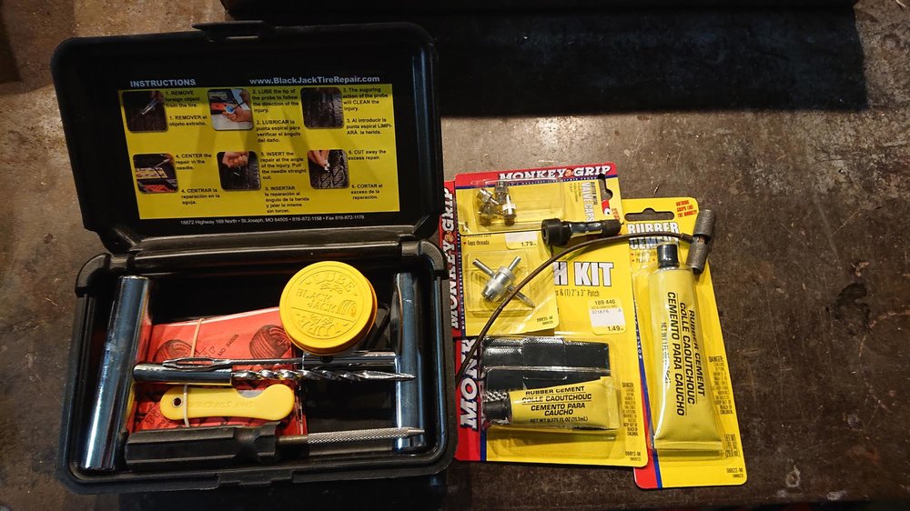

There are a number of different types of tire plugging systems on the market.  Most are the "string" type - these use what looks like a string of black material that is inserted into the hole in the tire.  However, there are also some that are a bit more substantial and resemble the "mushroom" plugs that many tire repair shops use.  Which ever type you wind up with I'd suggest that you find an old tire and practice with it a couple of times prior to actually needing to perform a real plugging on the side of a dark wet road in the middle of nowhere.  Also, after plugging a tire make sure that you check the air pressure in that tire often for the first couple of days just to make sure that the plug has done its job.
DavidS, this is a very good one, it is more expensive than the Walmart Slime kind but has all the tools plus a TactiCool zip case. ... https://smile.amazon.com/dp/B00EQ1IOS4/?coliid=IU1AGCDTAQVZJ&colid=26R5Z0L5VZEWU&psc=0&ref_=lv_ov_lig_dp_it
I recommend getting a kit with high quality tools.  Sometimes you really have to push on them and sometimes the rasp has to go into a ragged hole and clean it up.
If you buy an expensive kit in a nice box, you can add to it by buying some extra yarns, or whatever they are called, and an extra tube of rubber contact cement.  The kits now mostly come with a grease type sealant and I don't think it is as good.  The rubber cement can be squeezed into the hole and flooded all over the yarns before they are pushed in.  It makes a good lubricant and then sets up to seal.  Tubes of it are very cheap and sold next to the repair kits at auto parts stores.
Also, add a few round inner tube patches to the kit so you can fix your bicycle tube while on a trip.  This is done with the contact cement and the tube patches.
The strings, or yarns can work better than the rubber plugs because often the hole is not round and can be larger than the rubber plugs might work in.  Not all repairs are perfect, but most will get you home or to a tire shop.  As mentioned, I recently fixed a hole in my tire that was from a 3/8" bolt.  I drove it 150 miles to the Las Vegas to get a new tire and had no leak.  If you are just fixing a hole from a nail in the tread, this fix can be considered permanent and road worthy.
So, pick a high quality tool set that comes in a plastic closeable box. Add some extra yarns, some contact cement and some bike tire patches.  You can also add a schrader valve tool,  a couple of new schrader valves and a couple of air caps.  You can even add a couple of tubeless tire valve stems and a tool to install them, but that be a bit much.
I always have a bottle of windex handy in my truck for washing hands and cleaning stuff.  This will work for checking for leaks.
I also always have a 12 volt compressor, or an inverter and a 120 volt compressor, with me. These not only allow me to fix a tire, but allow me to air back up after a desert trip where I aired down.
Here's the kit I put together that rides in my truck:  It started out as a Black Jack tire repair kit and I added the rest.
