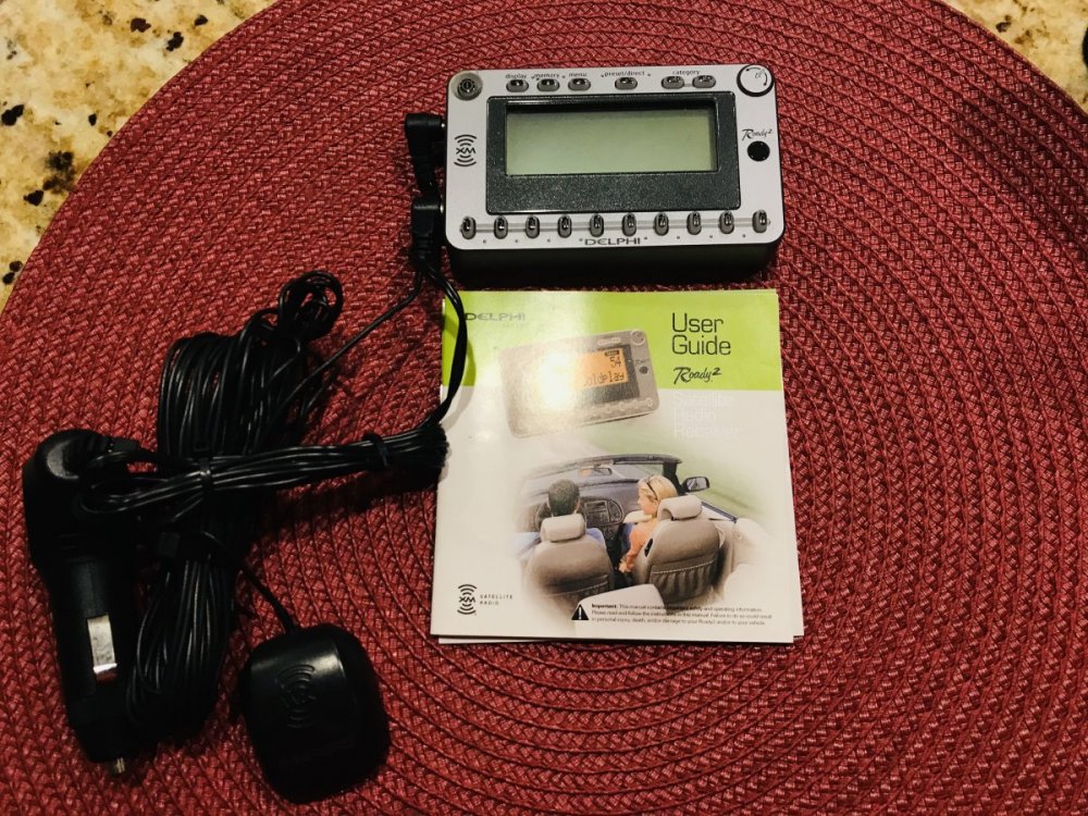

Patriot Posted February 19, 2020 Share Posted February 19, 2020 (edited) I managed to keep our two old XM Roady 2’s from our former long distance dual sport motorcycling days. I hope that someday we can get XM set up in the Ollie we now have on order. Look forward to seeing a few XM set ups when we attend the May rally. -Patriot Edited February 19, 2020 by Patriot 2020 OLEII - Hull #634 aka- “XPLOR” 2021 F350 6.7 liter Diesel Lariat Ultimate Tremor North Carolina 🇺🇸 Link to comment Share on other sites More sharing options...
