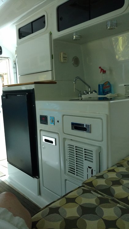

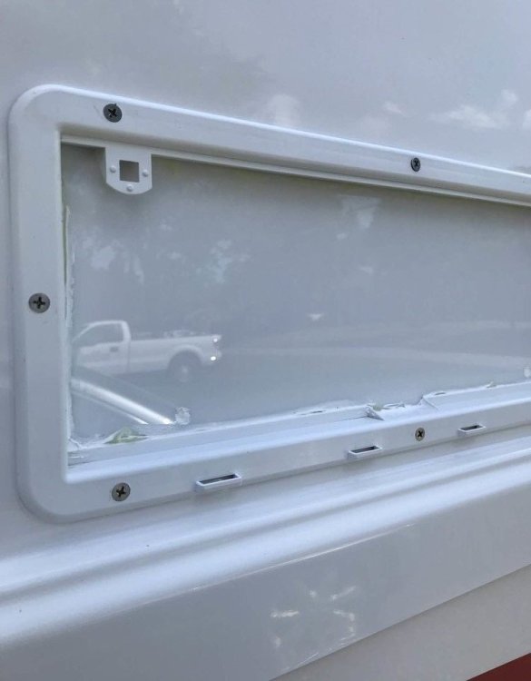

As far as sealing the now superfluous exterior vents, we've just closed them in with some plastic. We'll figure out something better later....

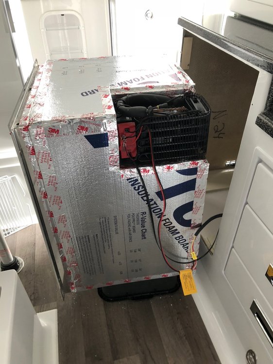

I found that adding a fan inside the fridge really transformed it. Our first trip out, the temps were up and down and we were always fussing with the temp control and worrying about it, some things freezing and others too warm. But with the fan the fridge has become something we just don't think about. See my Snowball thread for the brand and install. The Isotherm only cools via the freezer coils which is why it was so uneven before I added the fan. Perhaps the NovaKool has a better design in that respect?
I got the ASU unit for the Isotherm but never use it. I should give it a shot again with the internal fan to see if it makes a difference, but the internal temps were too variable using it on our first trip.
I added extra insulation just because. I don't really know if it's made any difference. Couldn't have hurt.
Real life power usage is minimal. It will pull 3.5 amps when starting and then settle down to around 2.5 amps. Probably has a run time around 50%, but that's highly dependent on the inside temp.
Noise is noticeable at times, but never intrusive. I can't hear the internal fan I added at all unless the door is open.
The freezer on the Isotherm is too small for anything but a few ice trays.
The Isotherm comes in both 12/120 and 12 volt only models. I couldn't see the point in the 120 and still don't.
If I remember right, the NovaKool had the compressor located on the bottom, so the internal arrangement was different. And maybe they have a model with an external compressor? That might be a good choice since you have the extra space.

I see there is a strong desire in some quarters to seal the exterior vents on the Ollie, and that is at least in part a motivator to shift from absorption refrigeration to compressor refrigeration. We have had great luck with Danfoss compressor refrigeration on our sailboats and are considering making the change.
Of course on the boats the compressor was physically remote from the evaporator plate in the ice box, located in an aft sail locker. The key to efficiency and low amperage draw was being able to move the heat away from the compressor. The compressor had to either be in a very large compartment, be supported by forced air venting of the compartment, or as was the case in our installations, have salt water cooling.
The question I want to throw out is this. Why seal off the exterior vents? The unit shown in John Davies photo looks like it is ideally suited for ducting hot air from the fan cooling the compressor directly out the upper vent. That would do a lot to keep the ambient temperature down in the compartment, promote efficiency, and reduce the amp draw.
Why not take advantage and duct out that heat? Is there something I am missing? Please advise.

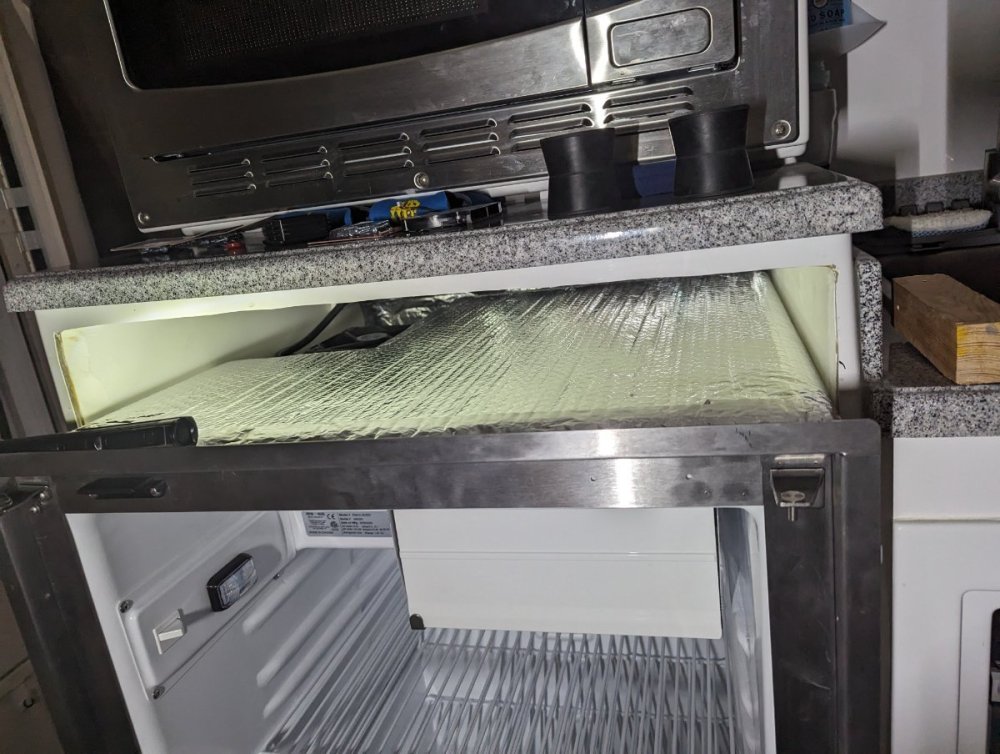

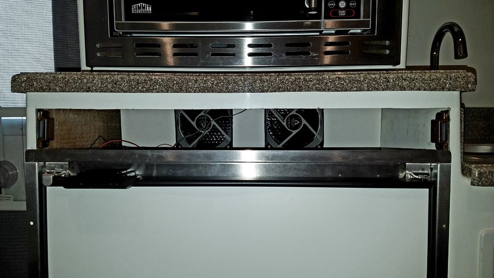

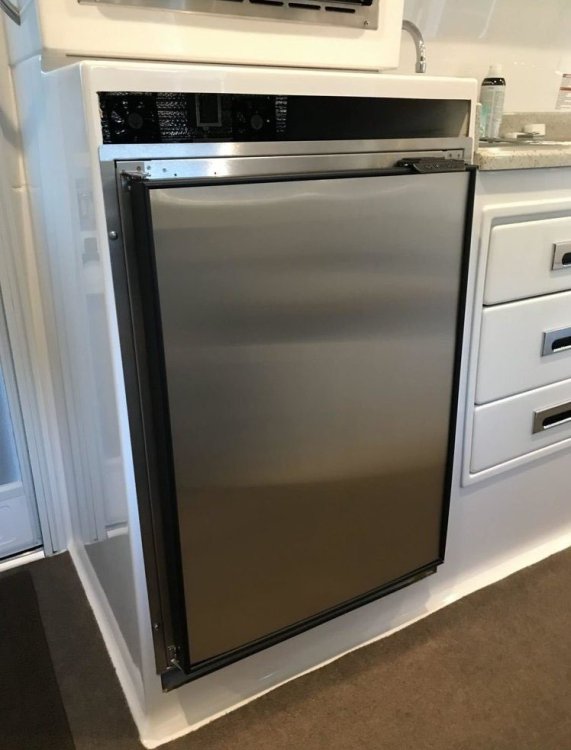

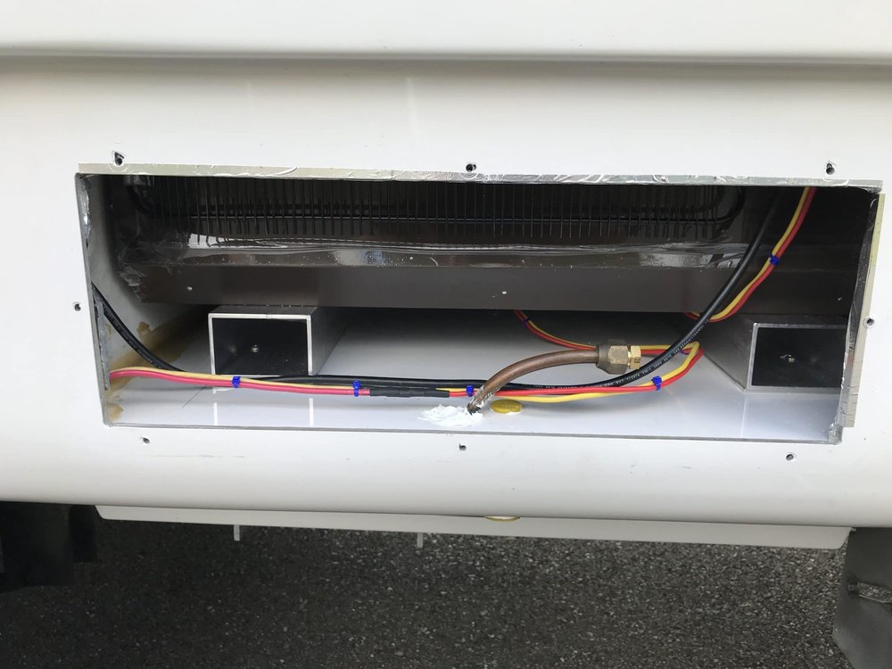

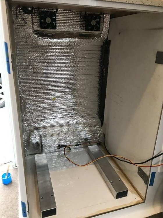

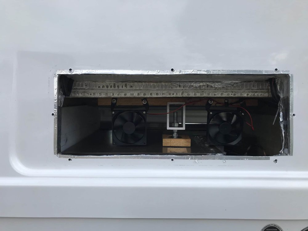

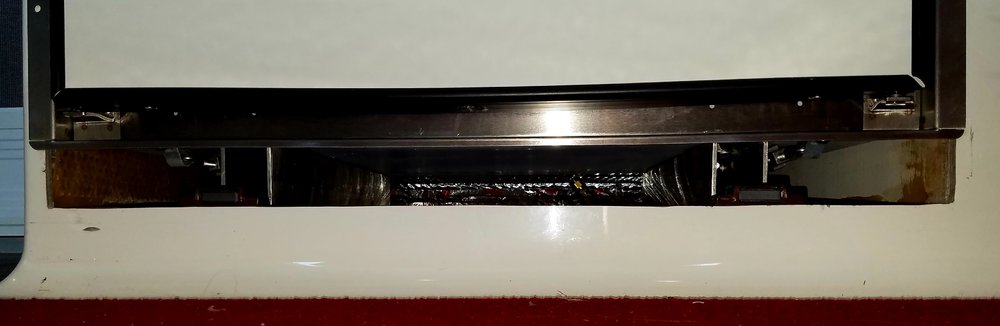

Novakool observations - model R5810
This was the closest fitting fridge to the opening from the Dometic, there is approximately ½" on either side (½" foam insulation extremely tight fit) and about 2½" both top and bottom, but not having all the propane components in the rear the fridge is actually deeper and this has more interior space.
With the extra space above and below I utilized that two area for the ventilation. With the compressor only needing to be cooled and the exchanger in the back being able to exchange the air, unlike a 3-way which actually generates extreme amounts of heat, I decided to keep everything internal and closed off the outside vents. The compressor on it is in the upper left rear corner, which is good as it then keeps any compressor heat generation above the exchanger in the rear, for maximum fridge cooling performance. I blocked off the top area, to control airflow, and installed two 40mm (I think) super quiet computer fans to pull the warm air out, which connects to the OEM fan connector to run whenever the compressor runs.
I used reflectix insulation, with the curve of the hull some places are 5 layers deep and the thinnest is 2. In the outside, I have cut to fit vinyl sheet, from some cheap the surround wall, between the tight fit and the stock vent covers it is held in pretty tight. I haven't determined a permanent resolution yet, but this one will last a while.
As to performance, the fridge runs on an approximately 50% cycle and the overnight draw is usually 23AH, which is easily recovered by 10-11am most days. The fridge is extremely stable temperature wise, the difference between fridge and freezer is generally 16 degrees so at a 4.5 out of 7 on the dial, it maintains 35 in the bottom shelf of the fridge and 18-19 in the freezer. I do not have any sort of air circulation inside the fridge, everything is stock.

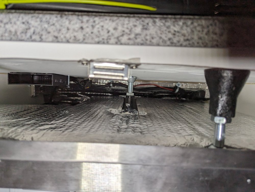

I used rectangular aluminum under the fridge, secured to the floor, to lift the fridge 2", for the bottom air intake. I did not want to screw through the face so I drilled holes into the rectangular aluminum and used turn buckles to secure to the screws where the face frame mounts to fridge body. The bottom of the fridge is pulled tight against the cabinet frame and the airflow block on the top is a tee that spans the width of the fridge and is cut to fit height wise which keeps it tight and prevents the ability of tipping (just in case). The vent covers are held in place magnetically, this was an afterthought or I would not have had the screw holes cut.
While in dead silence sitting at the table you can make out the sound of a fan hum the only real sound it makes is when the compressor kicks in there is a low vibration hum that fades out once it is going, I figure something I did is slightly loose and could use some padding but unless you're Archie Bunker it wouldn't be an issue.
Randy

That looks like a nice install. I think both you and Sherry have about twice as much ventilation through those horizontal vents than I have with the ones Oliver installed for me. While I don’t think my compressor runs excessively it does make me wonder how much more efficient it might be if I increased the venting. Or maybe a computer fan at one of the vents would be worth experimenting with.
That's a really nice install, Randy. Thanks for all your photos.

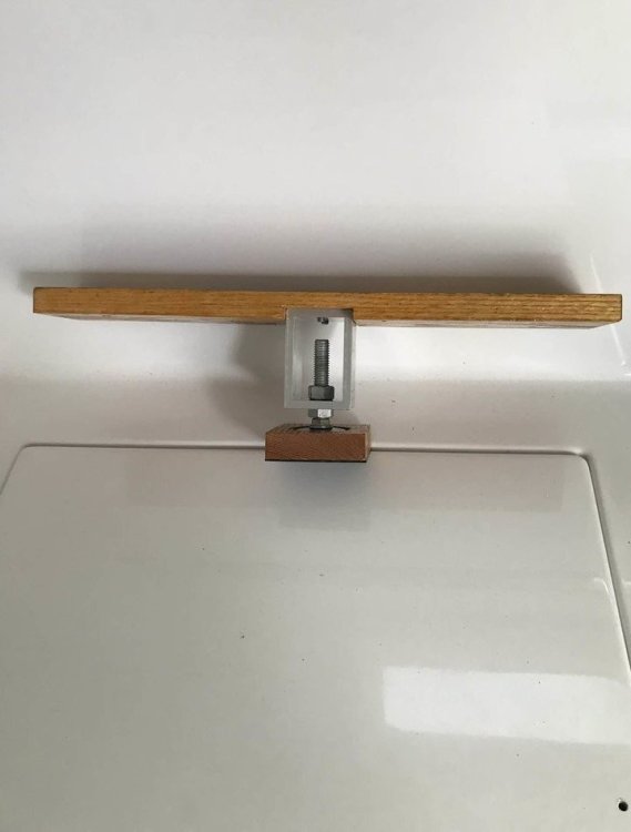

We tabbed in wood for a floor support/ riser/ drawer framing in ours. We also used scrap lumber for the uprights to attach the truck fridge to the Oliver cavity. Some is epoxy only. Some has screws through old holes into the side of the talk drawer cavity.

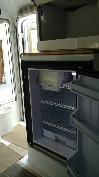

Well, I promised some updates after we actually got to use the truck fridge.
Overall, we're very happy after two weeks and some days with only solar and generator. It has taken some monitoring and getting used to.
The first day, from warm to cold, took about 8 hours to cool. I'd have done better to put some ice blocks or cold material in. The extra run time cost an extra 20 amp hours of battery power. Or, of course, cool it at home before leaving, but, I wanted the warm startup test.
Most days, the fridge used between 40 and 50 amp hours. When it runs, it uses 3.5 ah. Most often, it runs 12 to 13 minutes, with a 20 to 25 minutes rest. I found it ran better ( less run time) with a couple ice packs in the otherwise empty freezer.
Parked in dense shade, the trailer was nice and cool, but we didn't generate more than 1 to 1.8 ah in power to compensate for the new fridge with our 200 watts of rooftop solar.
The first week, we ran the Honda 1000 to make up. After that, we mostly used a portable 100 watt panel that we moved around in the spots of sun.
For people who plug in most of the time, the change would not be noticed. For us, it's a new learning curve on solar management, as we don't usually plug in, and have no power on our NC camping property.
In the sun, we'd be fine. Preference is to live in shade, so adding a portable panel and Port will work well for us.
Overall, I really like the fridge. Pretty even temps all around. the fixed door shelves took s little getting used to.
I removed the glass shelf above the produce drawer before we left home. A disaster waiting to happen. I was going to cut a plexi shelf, but I'm happy just moving one of the wire shelves down.
This fridge had a flip up on the top rack to allow for tall items... But not really designed for a full gallon of milk. I can live with that. A quart or half gallon is plenty for a week or two, anyway.
The freezer is small. It does make ice in a few hours. A couple trays, and a few bags of veggies would probably fill it, though.
At camp, we left the original vents open, with screening behind them. Average daytime temp was a high of 86, night lows in the 60s. one (very welcome) night the low was in the 50s.
I played a bit with the temp control and two thermometers. It didn't make a big difference in temp turning down the fridge from 7 to 6. Just cut the run time frequency.
I really like the big drawer in the bottom of the fridge for produce, and water bottles. Organization is different than the old dometic, but better for me as far as access.
Randy brought up s good point about the door swing. Our fridge, I think, only can swing right. Which is good for me. We cook outside 96 per cent of the time. Right swing is easier for loading groceries dumped by the door, accessing beverages during the day, and just as easy as the old left to take stuff out and stack on the small dinette table to prep for outdoor cooking. With the left swing, I had to move everything beyond the door for loading.

For John -- still haven't done anything more with the vents than cover them with plastic... Maybe we'll think of something this winter. It keeps the bugs and dirt out, so it's ok for now.
