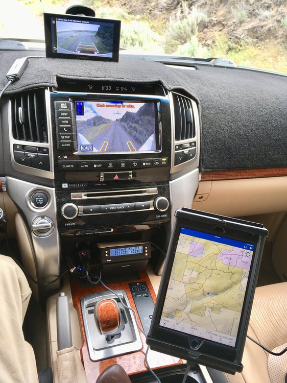

My Land Cruiser has perimeter cameras as well as front and back cameras. I hoped to tie my trailer one into that system. No luck.
I am now using a Garmin BC30 backup camera connected to my RV660 gps. It works fine, and having the second screen helps in certain unusual circumstances, such as going down a steep twisty dirt road in first gear, 4 Low. I have a view of what is in front of the truck bumper AND what is behind the trailer. I would lose that ability if I had the rear signal integrated into my factory display....
Sorry to hijack your thread. I actually believe having the monitor up high in your direct line of sight is WAY more useful, especially when you leave it turned on in heavy traffic. You don’t have to look away from the road to see it.
Note that my high mounted camera, about 8 inches below the Oliver sign, allows me to actually the rear tire; plus the two furthest guidelines are adjustable. I have mine set at six feet and four feet. I think this is important! I don’t know if the factory unit has that capability....

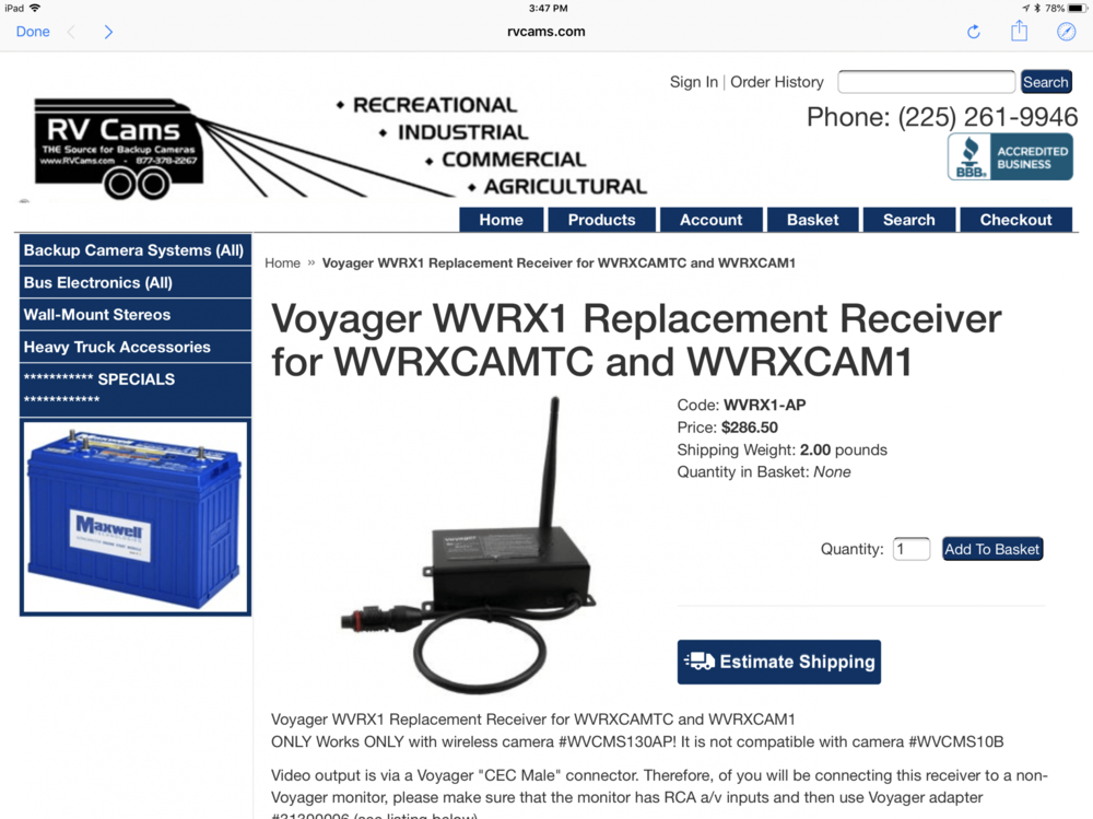

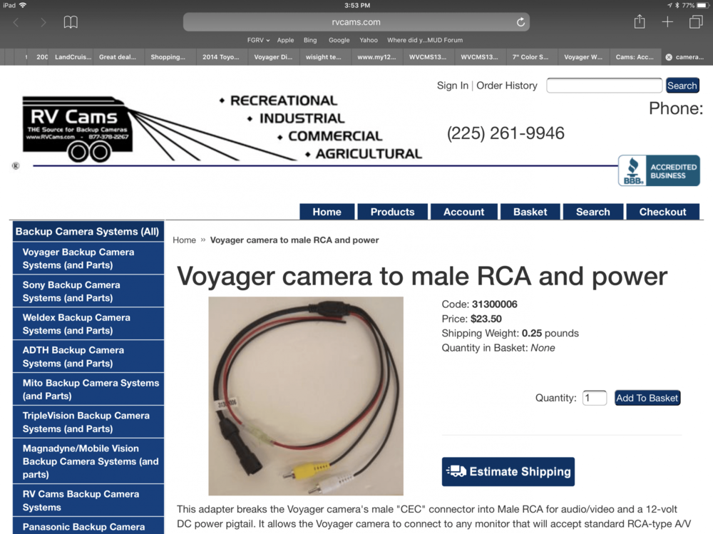

There is a way to do this if your truck display has RCA connectivity. Jensen makes the Voyager cameras Oliver is installing. They also make a wireless receiver that will connect to non Voyager equipment through RCA connectors. So if your truck monitor has RCA connectivity this receiver would plug into it and should display the rear view camera output. Your GMC dealer may be able to answer the question about the RCA connections. See the attached pictures from Rvcams.com and be sure to read the fine print about camera compatibility. Also check with www.rvcams.com for support. Let me know if you need any further assistance.
