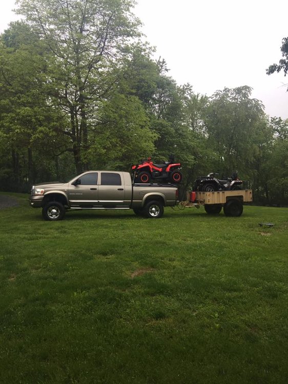

Attached is a photo of my truck with ATV on the DiamondBack lid (it's designed for this purpose) and you will note, without an airbag, it squats a little so I am going to correct that.  If you also notice, the rack for the ATV extends about 12" beyond the tailgate which is problematic so I am probably going to swap out the factory receiver with a "SuperHitch - Torque lift" receiver which safely allows me to extend the receiver back 21" (just at the edge of a downed tailgate) while allowing up to 20K towing and 2K tongue weight.  This way, when I decide to take the ATV with us, I'll just slip in the longer receiver.  Otherwise, I'll just slip in the standard short one.  Here is the link: https://www.torklift.com/rv/superhitch/superhitch-original#appguide.

I think your idea is problematic. Yes, you can extend your ball out past the open tailgate, but doing so greatly reduces its rating due to the extra leverage. Here is an article, this is a common problem when a guy puts an extended truck camper in the bed and also wants to tow a small boat. I am not aware of any setup that is safe for a 7000 lb trailer without using an equalizing hitch. Even then, it is going to be a major PITA. It will certainly be a knee knocker when the trailer is disconnected, and a real hazard to passing cars in a parking lot.
https://www.etrailer.com/question-192372.html
My recommendation is to see if Oliver can extend the tongue of the trailer 12 inches. That will cure your clearance worries and also LIGHTEN the tongue weight. This ideally should have been done when they welded up the frame. I don’t know if it is practical to do it afterwards. Give them a call to see what they say....
If that won’t happen, then I have to say you definitely need an Anderson when using that really long extension. When the ATV platform is not there, you will be fine with the short deadweight hitch.
I have never tried towing with a long stinger, but I have experience with intermediate length ones (about 12-14 inches) and they definitely affect how much the trailer moves around. The “tail wagging the dog” effect becomes much more pronounced. If you had an extended tongue and a foot long stinger, the trailer would remain very well behaved.
Call Hohenwald tomorrow and see what they have to say.
BTW what is the weight of your ATV, gas and gear? 750 pounds? Weight of the  platform? Your payload is about 2500 pounds so you need to make sure you are not going to be overloaded with a heavy hitch setup plus about 600 - 700 pounds of tongue weight. These Gen 3 Rams are not particularly good load carriers compared to the newer ones.

John;  All good points to ponder but I have previously investigated the extended hitch and you're right, as the hitch goes out, the tongue weight allowed goes go down dramatically.  The SuperHitch however has taken this into account and provided the additional construction and engineering to specially account for this scenario.  If you read the data available from the linked website, you can see how they did this.  They in fact use a chain system similar to the Andersen equalizer as well as using a second 2" receiver, one on top of the other.  That is why they rate the system at 2K tongue weight and 17K-20K pull weight.  It's an interesting system that was suggested to me by a very reputable off-road fabrication shop that specializes in unique towing issues.  Superhitch in fact, has systems that extend out to well over 4' that are engineered to handle 30K lbs..  The one I'm looking at is the shortest one they make.
Now, you're point about total weight on the rear of the truck is valid and I'll look into that.
You are correct about the extension being a knee knocker so when disconnected from the trailer, I would simply remove the extension and put in the rear of the truck or otherwise, drop the tailgate which covers the extension.   When I'm not hauling the ATV, the standard hitch goes in vice the 21" version.
As far as having Oliver extend the frame, I think we're too far down the road for that one.  The trailer has been in productions since mid-Oct.

Maybe I wasn't clear in my description above.  The ATV rack extends about 12" past the tailgate (in the closed/up position).  The extended hitch puts the receiver 21" past the bumper which equates to the distance covered when the tailgate is in the open or down position.
In effect, the back of the truck is now 21" further back or at the point where the tailgate is open.  At that point, the ATV rack is actually about 10" shorter than the tailgate.  I see no way that anything on the tongue of the trailer is in jeopardy of getting hit by either the ATV rack or the tailgate (if it was down).
Am I missing  something here?

I think Randy’s point is that if the rack sits higher than the propane housing, then a standard hitch setup should work fine. No need for an extension. Looking at the photo, I’d agree and in fact even wonder if you need an extension regardless.

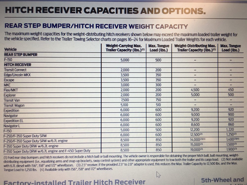

FrankC - Do you know what the tongue weight limit is for your Ford?  My F-150 has a limit of 500 pounds (without a WD hitch) even though it can tow 12,000 pounds, and I'd be a bit surprised if yours wasn't the same with regards to the hitch weight.  I also have the electronic anti-sway on the truck and leave it on even when towing with the Andersen.

Bill,
My spec sheet for the Expedition EL says that without a WD hitch, it’s 6,000 pounds max trailer towing capacity with a max tongue weight of 600 pounds.  With a WD hitch it’s 9,200 and 920 respectively.  Here’s a pic of the Ford site.  The Expedition (6,000/600) is slightly higher than the F-150 (5,000/500) without a WD hitch.  With a WD hitch the F-150 is higher (12,500/1,250).

FrankC -
Assuming that we are talking about an Elite II then, in my opinion, you don't have much of a choice.  Off the factory floor an Elite II - full propane tanks but all tanks are empty is going to weigh in right near 5,000 pounds = or - a few pounds.  Unless you plan on keeping yours this way, I believe that you will soon get it very close to that 600 pound number (assuming a 10% hitch weight versus total weight).  And, if you are at all like ScubaRx you will be much closer to 700 pounds.  Either way, not enough room for error in my book.  If for no other reason (and I do believe that there are other reasons) I'd use the Andersen.
