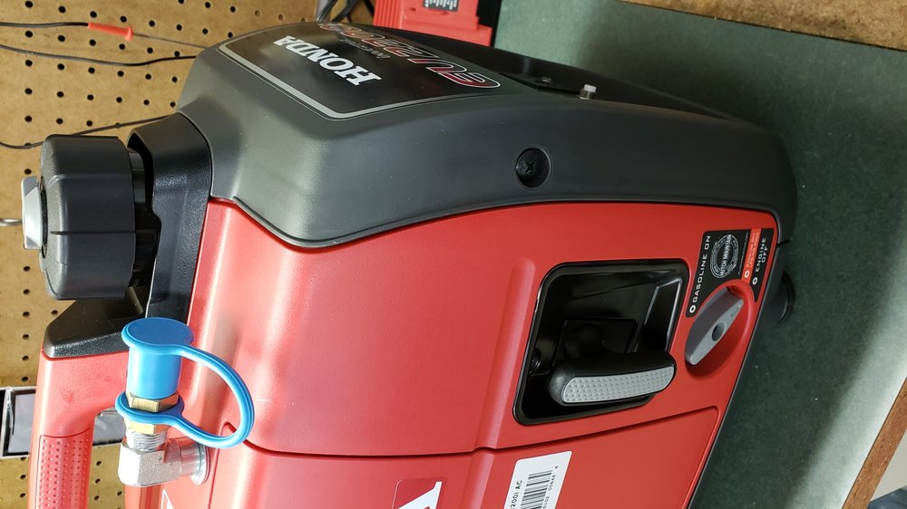

I also installed the Hutch Mt kit. Mounted the large regulator on their Extended Distance Bracket and I clamp that to the front storage basket using a large wood clamp. Propane hose plugs into the optional front propane outlet with Honda 2200 in basket. Will run a/c with Micro Air Easy Start at 650 Ft elevation, at less than max rpm. The regulator bracket can also set under the generator if you want to set the generator on the ground or use the generator with a portable bottle away from OTT, or hook up to natural gas at home as a backup generator. If purchasing be sure to get their RV-1/4-to-3/8-Quick-Connect-Adapter. Their hoses use 3/8 inch quick connects and the OTT propane port is 1/4 inch.
