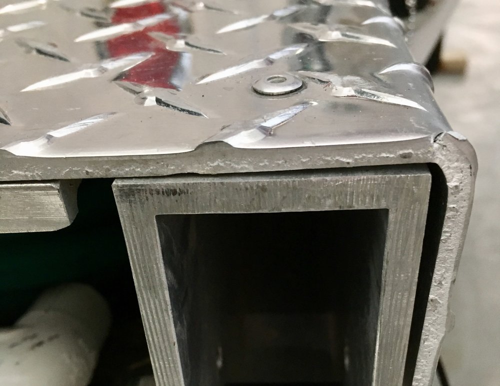

Here is a closeup of the area in question, with those pesky diamond plate ridges.... this stuff really does not bend neatly, notice the small crack right beside a diamond in the corner. I much prefer smooth plate.... I don’t think the crack will go any further but it should not be there. Those raised edges will make you bleed, they should be filed down. I am not impressed.

We had the very first bike rack that Oliver installed on any trailer and it was a joke.  After many calls and emails to Oliver they sent me a replacement bike rack hitch, which was not much of an improvement.  That started another round of calls and emails to Oliver about the replacement bike rack hitch.  The third and current rack was installed by Oliver at their factory, which has handled our two bikes and rack weighting 121 lbs.  We also have a cargo basket for our Honda 2000 generator and a 2..5 gal gas can plus the cover and it's weight is 121.5 lbs.
You can see in the attached picture that Oliver used under the bike rack the same rubber that is placed under all supports between the aluminum and fiberglass body.  With the current rack I have had no issues, the mounting bolts remain tight over many miles.
Thanks for the closeup pic, I have seen pics of the various rack versions, but didn’t know what material was used. Do you actually check the bolt torque routinely and have you ever had to tighten them, or do they stay pretty much solid?
