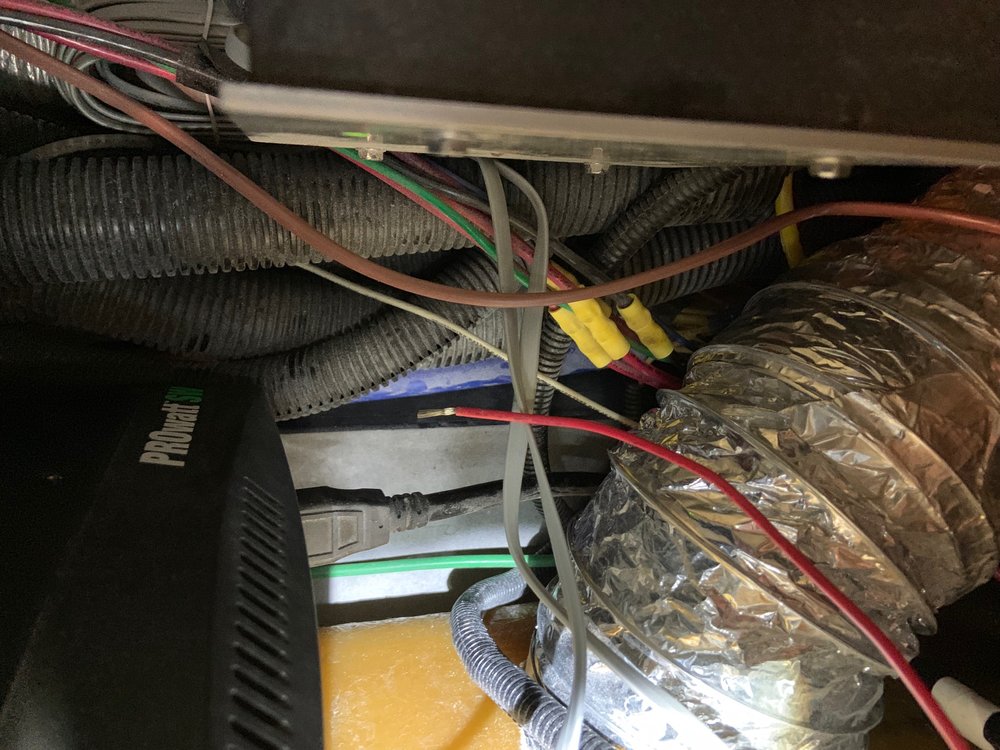

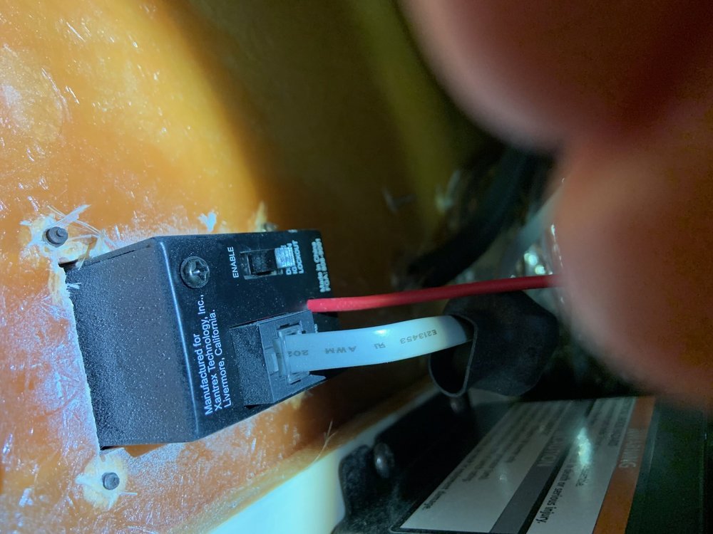

Dave and Cindy Posted May 25, 2019 Share Posted May 25, 2019 Our inverter does not turn on when we push the button to start it. When I looked inside there is a red wire from the backside of the switch that is not connected to anything. If this is the issue, could someone tell me where to connect it? If it is just there to confuse the not-to-mechanical folks like me, any other suggestions as to why it will not turn on, no light on the switch and no power from inverter, would be greatly appreciated. We are on our way as of Wednesday to Alaska for an extended trip and would love to have this working. Thanks. Dave Dave & Cindy #076 Photographer * Traveler www.twolanetouring.com Posting Daily - National Parks, Camping and more. Link to comment Share on other sites More sharing options...
Moderator+ ScubaRx Posted May 25, 2019 Moderator+ Share Posted May 25, 2019 You can tell that wire was originally crimped inside a connector. I would bet it’s in the immediate vicinity of the bare end probably behind something and not readily obvious. Look for another wire one that area (probably red but not guaranteed) with only a connector on it. On a slightly related note, we too are on our way to Alaska. We are currently in Missouri slowly making our way West. Steve, Tali and the dogs: Reacher and Rocky plus our beloved Storm, Maggie and Lucy (all waiting at the Rainbow Bridge) 2008 Legacy Elite I - Outlaw Oliver, Hull #026 | 2014 Legacy Elite II - Outlaw Oliver, Hull #050 | 2022 Silverado High Country 3500HD SRW Diesel 4x4 Link to comment Share on other sites More sharing options...
Overland Posted May 25, 2019 Share Posted May 25, 2019 That red wire is supposed to be for a vehicle ignition disable and if used would be connected to a vehicle's ACC wire. I'm thinking it's a red herring, and may have just had a wire nut on it to protect it. The switch above it is to enable/disable that feature. Can you turn it on from the button on the front of the inverter? If you can, that would narrow the problem down to the remote. You might have to unplug the grey cable from the unit to make that work. Link to comment Share on other sites More sharing options...

bhncb Posted May 25, 2019 Share Posted May 25, 2019 Our inverter does not turn on when we push the button to start it. When I looked inside there is a red wire from the backside of the switch that is not connected to anything. If this is the issue, could someone tell me where to connect it? If it is just there to confuse the not-to-mechanical folks like me, any other suggestions as to why it will not turn on, no light on the switch and no power from inverter, would be greatly appreciated. We are on our way as of Wednesday to Alaska for an extended trip and would love to have this working. Thanks. Dave Mission accomplished. That wire is for an unused feature and should have at least been taped and tied up out of the way. In your picture, that switch on the back of the remote must be in the disabled (down) position. It appears to be but flip it up/down to be sure. Will the inverter power on with the power button on the inverter control panel? It has to be pushed in for a second or two. Other than that, try disconnecting and reconnecting both ends of the remote cable. Link to comment Share on other sites More sharing options...
John E Davies Posted May 25, 2019 Share Posted May 25, 2019 “Don’t cut the red wire!” Wasn’t that a line in a movie? Mine is not connected to anything, don’t worry about it. You should fold it back on itself and secure it and also secure those loose floppy wires with nylon ties. Any excessive motion while traveling causes chafing and stress on connections and stuff. The earlier hull numbers like yours and mine have less than satisfactory wiring. Buy a big sack of good quality 11 inch nylon ties (not from Harbor Freight or Walmart) and whenever you open a compartment and see wires like that, lash them down. It could prevent future unpleasant electrical issues beside some isolated Yukon backroad.... BTW, where is your inverter located? Later units have it below and behind the pantry, but there are no furnace ducts there, I guess yours is on the right side somewhere? Good luck and above all, enjoy your big trip. John Davies Spokane WA "Mouse": 2017 Legacy Elite II NARV (Not An RV) Two Beds, Hull Number 218, See my HOW TO threads: https://olivertraveltrailers.com/topic/john-e-davies-how-to-threads-and-tech-articles-links/ Tow Vehicle: 2013 Land Cruiser 200, 33" LT tires, airbags, Safari snorkel. Link to comment Share on other sites More sharing options...
