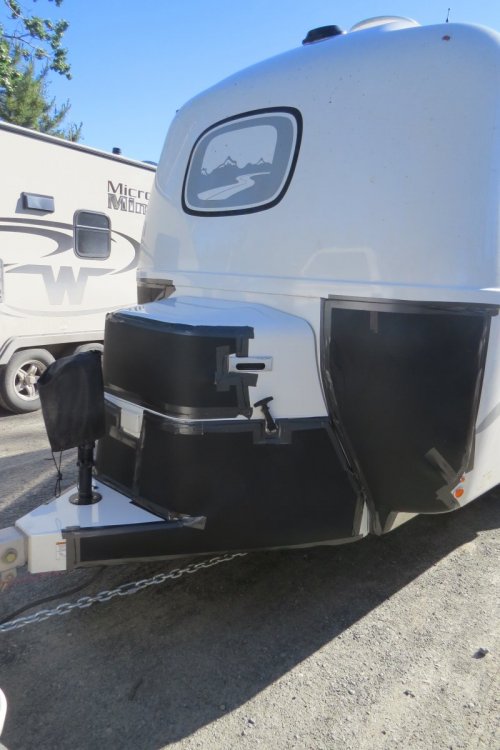

    I have applied closed cell foam on the front of my Oliver with non- residue duct tape, put it on in British Columbia traveled for a month thru Alaska and removed it just before we went into Washington state. We went up the Alcan and back down the Cassiar, Great trip. The application took the rain , mud, washing, back on the dirt and gravel and it held up well no dings or dents to the gel coat. Safe travels and don't hesitate try to catch the salmon runs it is also when all the Grizzley's come out to feed. If you want to stay in Denali make your reservations when they open up.

Mike, John and Gary- Thank you for you replies. Between Gary’s closed cell phone and John’s suggested search words I am finding good recommendations. I am considering ordering an Oliver and then a possible Alaska trip in 2021
