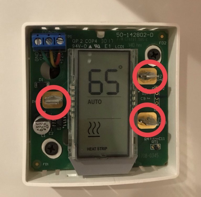

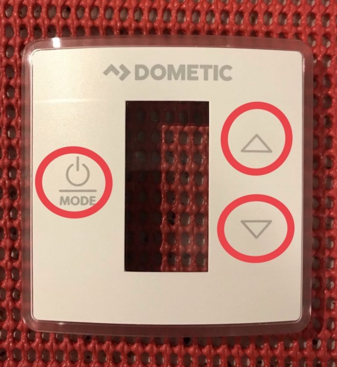

Townesw Posted February 1, 2020 Posted February 1, 2020 (edited) Let’s test the faulty faceplate theory. Take your faceplate off and try just touching the 3 tabs that are circled in the following picture. Those 3 tabs correspond to the 3 “buttons” on the faceplate. Don’t push them, just lightly touch them and nothing else. I just did it to mine and I can operate all modes of the heating and cooling system with the faceplate removed. Edited February 1, 2020 by Townesw 2 Bill and Martha 2018 LEII Hull 313 Original owners 3/14/2018 2019 Chevrolet 2500HD Duramax
Moderators SeaDawg Posted February 1, 2020 Moderators Posted February 1, 2020 (edited) Townesw, that's a "solution" I've seen on several of the 40 plus threads I've read on this thermostat's problems. It looks like a good trouble shooting idea, but not long term solution. Everyone who left the cover off, in the threads I read, had problems later, within a few weeks? Corrosion? Moisture? Would be my guess. Definitely, a worthwhile exercise to troubleshoot, Just not a long term solution. I've never seen so many bad reviews on a thermostat. I was stunned. I hope Dometic has resolved the issues, as I haven't found a replacement/ other brand stat yet in my research. Then again, others reported corroded connections, loose connections, on the ac and at the furnace, as other issues causing similar problems. It could be worth a try, Nan, if you have the time. It can rule out the messed up face plate. But, it won't rule out a faulty thermostat. Edited to add: townesw, that's a great troubleshooting technique for the faulty faceplate. . Not discounting it, at all . Sherry Edited February 1, 2020 by SeaDawg 1 2008 Ram 1500 4 × 4 2008 Oliver Elite, Hull #12 Florida and Western North Carolina, or wherever the truck goes.... 400 watts solar. DC compressor fridge. No inverter. 2 x 105 ah agm batteries . Life is good.
Nan Posted February 1, 2020 Posted February 1, 2020 Right Sherry..when I took off the faceplate and lightly touched the the buttons there was no change. It seems to me if the service department stocks the faceplate they would also stock the whole thermostat..but the first tech said I would have to buy it at Camping World or someone else that stocked it. And when I called Oliver the other day Cindy told me to just leave the thermostat alone for awhile and see if it might reset itself.. and that did not happen. Maybe I do need to go to Camping World and see what they have in the way of thermostats installed in their campers. 1

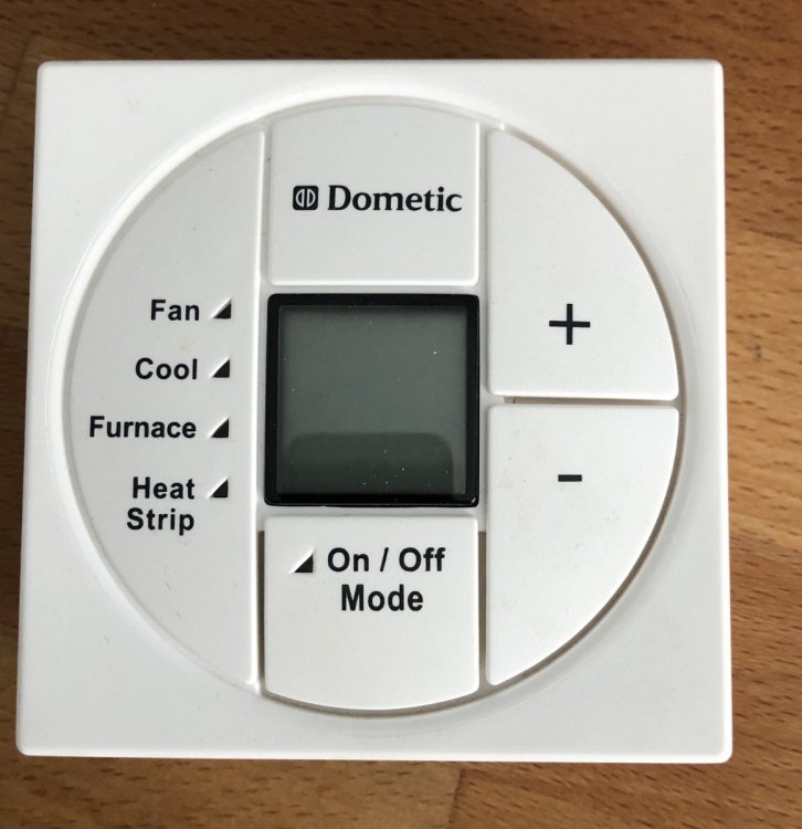

DavidS Posted February 1, 2020 Posted February 1, 2020 Nan, I have a spare thermostat I can send you if you want. Mine is hull 164, and it had an older model thermostat than the photo @Townesw posted. As I posted in this thread, I replaced my thermostat with a Bluetooth model that allows us to turn on the heat or adjust the thermostat from our warm bed, using our phones. We really like it. One thing I noticed after the replacement, is that the buttons on the regular thermostat were not always responsive, and that the iPhone app worked much better. 2 David Stillman, Salt Lake City, Utah 2016 Oliver Elite II Hull 164 | 2017 Audi Q7 tow vehicle. Travel and Photography Blog: http://davidstravels.net
Nan Posted February 1, 2020 Posted February 1, 2020 David, thank you so much for the offer. But maybe I should just try to replace my thermostat with a bluetooth model. Since I do not know what I am doing, can you please tell me: 1) Will a bluetooth work with my 2017 Oliver? 2) Other than killing the ac power, is there anything I need to know about changing it? 3) If I need to kill the dc power, how do I do that? 4) Where did you purchase you bluetooth thermostat and do you know the model? Thank you so much. Nan Wallace
DavidS Posted February 1, 2020 Posted February 1, 2020 1) Yes, Bluetooth should work with the 2017 Oliver. Mine is a 2016. 2) AC power should probably be off. 3) If you don't want to turn off all of the DC power, you will need to pull the fuse that controls the thermostat. On my Ollie the fusebox is under the dinette. Or you could disconnect the batteries to shut off all DC power. 4) I contacted Dometic customer service (customersupportcenter@dometic.com) to ask which model to get. I told them that I had a Dometic Thermostat model 3313194, and they asked for the brand and model of the AC unit. I told them a Dometic Penguin, model number 936000724. They replied that I had model number 641935C751C0 (I think this is the capacitor part number), and that the part I needed for a Bluetooth CT replacement thermostat is 3316255.000 for white and 3316255.011 for black. Based on their response, it sounds like there are a number of models. My email correspondence with them is attached below. Dometic emails.pdf I purchased my Bluetooth thermostat from Panther RV for $77 with tax and shipping. And a piece of history for those who are interested. Bluetooth wireless technology was named for Harald Bluetooth, a Danish king who ruled more than a thousand years ago. The naming was based on the analogy that Bluetooth technology would unite devices the way Harald Bluetooth united the tribes of Denmark into a single kingdom, and the Bluetooth logo consists of runes for his initials, H (ᚼ) and B (ᛒ). I am a big fan of Wikipedia! 1 1 David Stillman, Salt Lake City, Utah 2016 Oliver Elite II Hull 164 | 2017 Audi Q7 tow vehicle. Travel and Photography Blog: http://davidstravels.net
