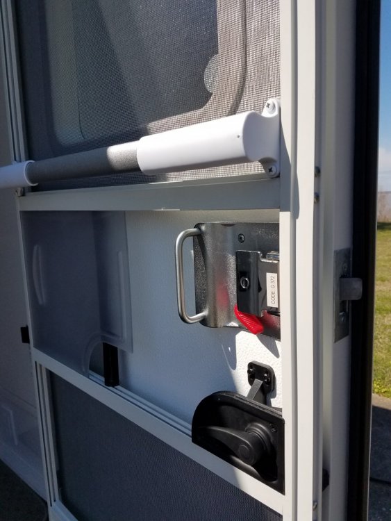

Moderators topgun2 Posted February 17, 2020 Moderators Posted February 17, 2020 Ouch! Obviously this issue is the reason for that aluminum plate on the door behind the rubber bumper. A number of us have installed a grab bar that attaches to the screen door so that there is something to hold onto in the event of a strong wind - screen door grab bar The only downside to these is making sure that people don't use them for "support" when getting in or out of the camper. Bill 1 2023 Ford F150 Lariat 3.5EB FX4 Max Towing, Max Payload, 2016 Oliver Elite II - Hull #117 "Twist" Near Asheville, NC

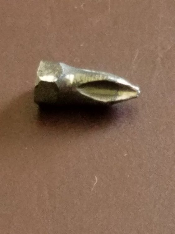

Buck Posted February 22, 2020 Posted February 22, 2020 I noticed those holes in the handle and they measure 3.5" center to center. You can get drawer pulls from a hardware store that fit that measurement. I got an Amerock BP86726D Brass Wire Pulls 3-1/2 in . You need to get 1/2" long bolts or cut down the ones that came with it. I also had to cut a Philips head bit to get behind the handle or you could take the handle apart. Be sure to double check your hole measurement, it may not be the same. 3 2 2019 Elite I hull #496, tv is a 2019 GMC Canyon Denali v6

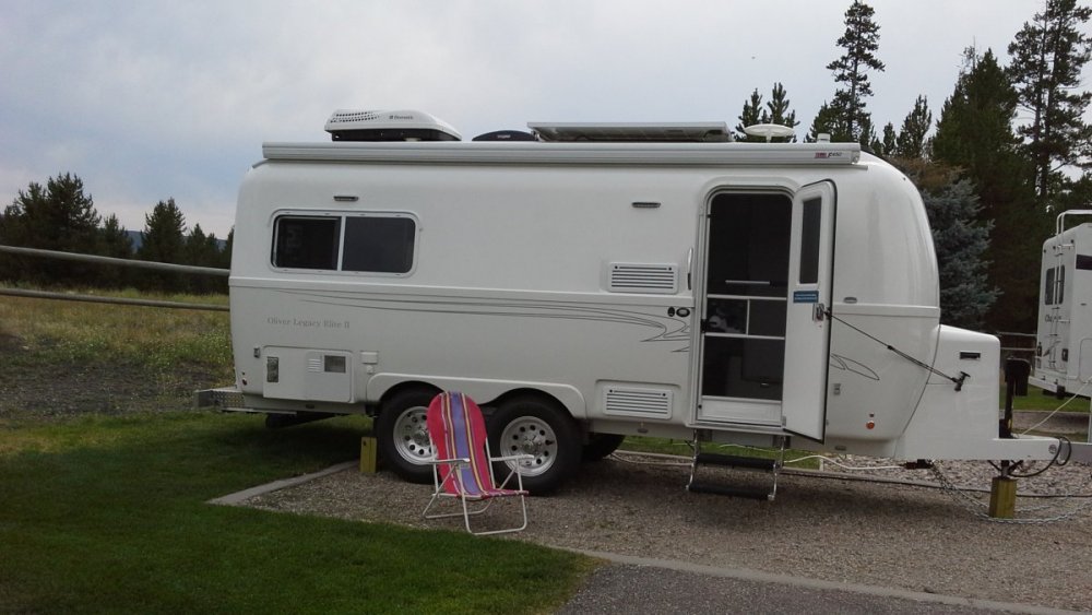

Moderators topgun2 Posted February 22, 2020 Moderators Posted February 22, 2020 (edited) Buck - Looks nice and gives yet another place to grab - nice job - thanks! Below is a pic of a rope/bungee that I made primarily for use out West. With the afternoon winds out there my open door would rattle and shake being only held by the hook at the bottom of the door. This rope/bungee has a stainless steel hook at each end, hooks to the interior side of the door latch at one end with the other end hooking to the propane tank cover latch. It gives added support to the door with the bungee allowing some dampening of the buffeting caused by the wind and taking the stress off the bottom door hook. I'll post better pis of this when I get a chance. Edited February 22, 2020 by topgun2 1 1 2023 Ford F150 Lariat 3.5EB FX4 Max Towing, Max Payload, 2016 Oliver Elite II - Hull #117 "Twist" Near Asheville, NC
