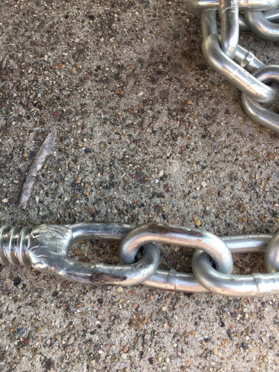

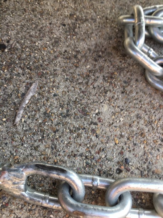

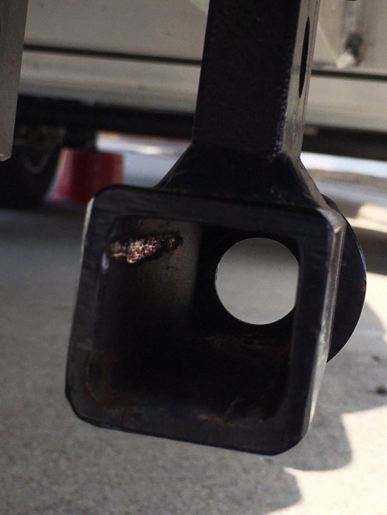

I removed the end bolts from the bracket and found indications rubbing wear on the link welded to the bolt, the first chain link and on the inside of the mounting brackets. (Pictured)

In the first picture, is that some weld flash inside the bracket that shows the rub marking. The marks on the chain links in second picture don't appear to lineup. Ask for a new bracket.
What you see in the first picture is a grove worn in the bracket from the link rubbing against it.  When the chain is inserted into the bracket, the rub marks line up.

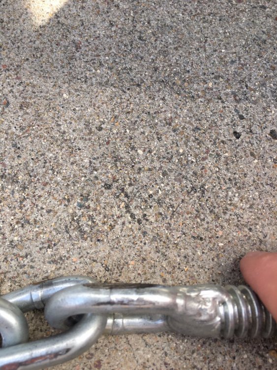

The 3rd and 4th pictures are of the chain from the opposite side.

Without a doubt, the sound was coming from the chain rubbing the inside of the square tube, on the chain brackets.
