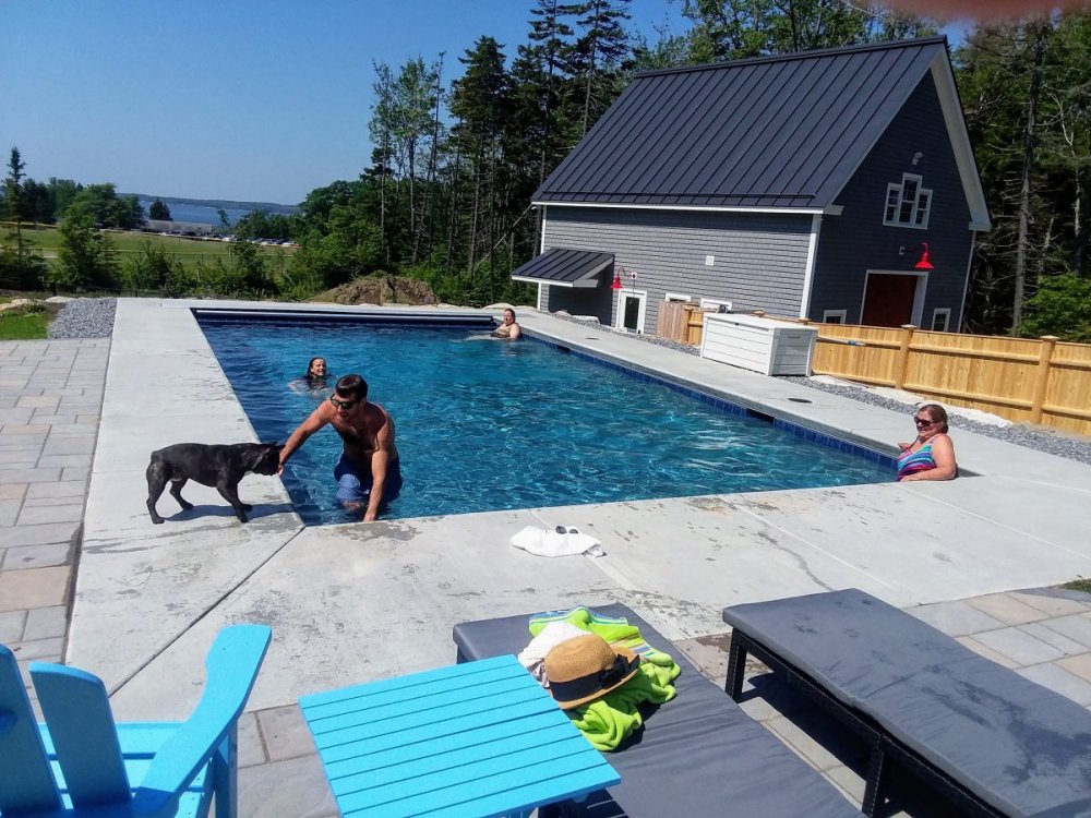

Sure,  The barn is 26ft wide by 32ft deep.  The front barn door opening is 10ft by 10ft.  The roof pitch is 12/12 a 10/12 pitch also looked nice.  The front barn door is split in the middle with one side sliding right and the other left.  We have them hooked up to work on garage door openers and that is pretty slick.  The back door is 8ft x 8ft.  The balcony is 4ft x 10 ft.  The loft apartment is 16ft deep x 26ft wide.   We also have some storage on the 2nd floor on the right and left and we have hoist to lift items to the 2nd floor.  If I were doing this again, I might go a little bit larger.  I am including some pictures if it will help.  Please feel free to ask any questions.   Thanks!!
