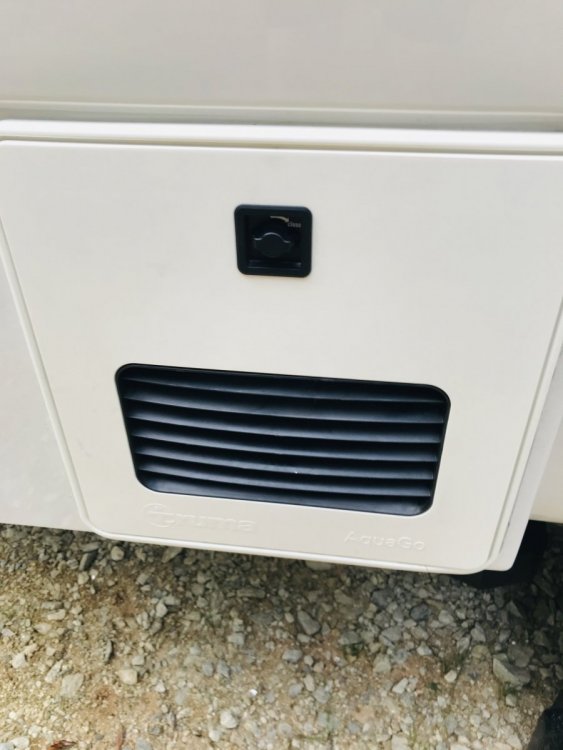

I have just completed installing SS screening to the frig vent (pic) and installed the screen for the furnace vent to keep wasps, mud dobbers and other home seeking critters out. Also installed the AC Cover to keep birds from nesting.

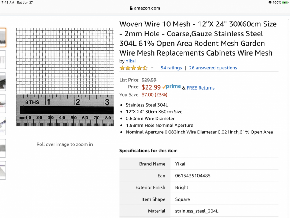

My question for Truma owners that have done this install is did you use the same size mesh for the Truma as you did for the frig? (See mesh size pic I used for frig). If not what size screen did you use? I want to be sure I do not restrict air flow to the Truma system.
I may just call Truma and ask if this is even recommended? I solicit thoughts of others that may have already called Truma and asked this question or completed this mod. I will try and contact Truma today and see if this will impact airflow and VOID the factory warranty before moving forward.

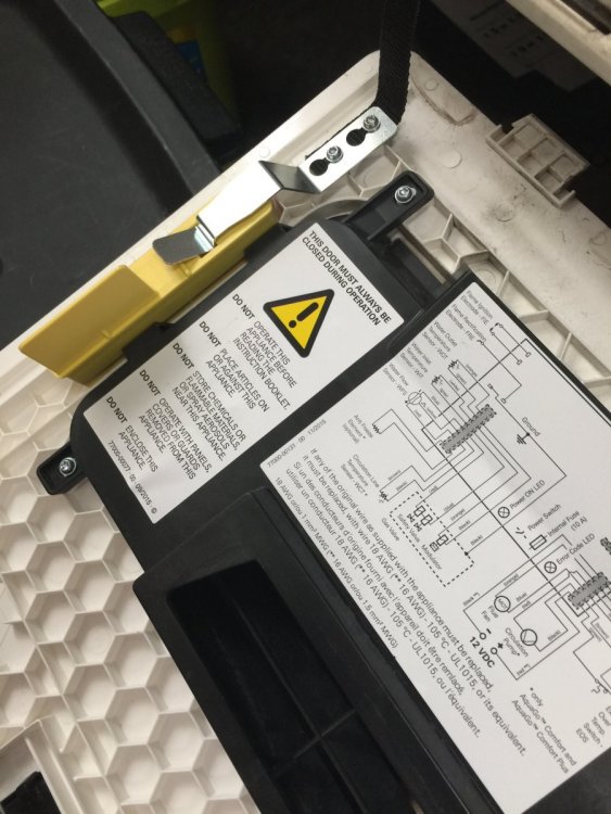

I don’t know the answer, but I do know that Truma makes a plug for that vent to use when not in use. One comes with the electric antifreeze kit and so you may be able to get one separately if you call them.
The plug has a tether and a slot to store it when not in use, and also there’s a visible tab that sticks out of the vent when installed, to remind you to remove it before turning on the hot water.
Yes, thanks! We did get the electric antifreeze kit. I will check with Truma on the vent plug.

In your shoes I would choose a much bigger mesh size and epoxy it behind the slots. I don’t see how a 10 mm mesh could possibly obstruct airflow. It would certainly keep out larger insects, like those pesky Murder Hornets.
If the kit is installed, the yellow flue plug and metal storage bracket should be on the access door like this.
