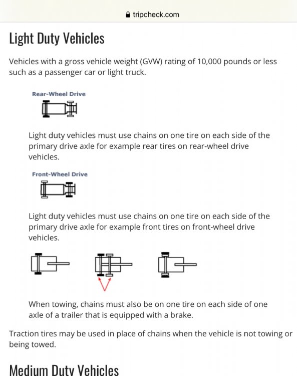

Yes . . . . here in Oregon we have strict "carry chains" regulations Nov through Apr.  Even with 4wd/All-wd you must carry chains.  Both of our vehicles fit this description and we don't have chains . . . .  we simply don't travel higher passes (even on I-5), during chain season.  Well, maybe I should rephrase that, we usually don't 😀 We rarely get snow where we live - more apt to get icy conditions, so we don't put snow/studded tires on our vehicles. My BMW X-5 has run-flat tires, so I'm not sure they even make chains for them.
This confuses a lot of folks. Legally you have to carry chains for those passes. You do NOT have to install them if the signs say “Chains Required” if you have 4WD/AWD and traction tires installed and are not towing. Normally if things are bad enough that all vehicles must chain up, the DOT closes down the road until it gets cleared of spun out vehicles.
Traction tires, not the same as M&S, have the snowflake/ mountain symbol on the sidewall and have a little different rubber that won’t slip quite as much when the road is freezing cold. (However they are not true snow tires, which must not be run in warmer seasons because they have really soft rubber, they get squirmy and wear out incredibly fast on dry hot pavement.) Nokian makes one truck tire with a snowflake that can be used year round (WR G4). There are a few more agressive All Terrains available like the BFG TA K/O2 that have the symbol. This stuff changes constantly, so you have to do your research.
