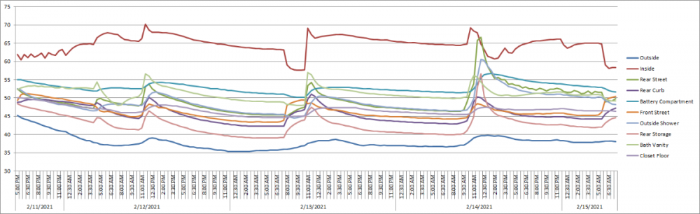

NCeagle Posted February 15, 2021 Posted February 15, 2021 @Ray and Susan Huff recently posted a couple interesting questions about humidity in a related "cold weather data" thread and I created this thread as I think humidity deserves a thread of it's own. 🙂 Here's what Ray and Susan posted in that thread so you don't have to go back and look: I've been wondering about running fan/cracking a window or two, when outdoor humidity is high. So, to maintain desirable humidity while parked in the driveway in the PNW with outdoor humidity at, let's say, 95% the fan/roof vent and windows need to remain closed? While camping for a few days recently, we had quite a bit of condensation in the trailer. Nighttime temps were in the mid-thirties. We ran the furnace, during the day, set to 68 degrees, but off at night. Daytime temps were in the upper forties and the condensation dissipated as we were outside most of the day, but returned at night. (I don't recall the humidity level registered on our sensors - my bad). When we returned home we ran the dehumidifier for a day. This brought the humidity/temp to 40%/45 deg  and maintained it there through the night. The next day we swapped the dehumidifier for the oil heater we use in storage to see what this would do humidity wise. It is set to maintain approx 60 degrees. The humidity has stabilized at 50%. Outside humidity is 95%; night time temps in the low 40's. Is it better to run the dehumidifier to achieve a lower humidity, at the expense of lower temperature (40%/45 deg) or the heater that produces humidity/temp levels (50%/60 deg)? The dehumidifier, running on high heat, draws 3 amps; the oil heater, on med 900w setting, draws 7 amps. What is a healthy humidity level for maintaining a healthy environment in the Oliver while sitting idle? 2020 Elite II, Hull 688 --- 2021 Silverado 2500HD, 6.6L Duramax Diesel

Galway Girl Posted February 15, 2021 Posted February 15, 2021 Remind us what sensors you have for all this spaces? Craig  2019 Elite II (Hull 505 - Galway Girl - August 7, 2019 Delivery) Tow Vehicle: 2021 F350 King Ranch, FX4, MaxTow Package, 10 Speed, 3.55 Rear Axle Batteries Upgrade: Dual 315GTX Lithionics Lithiums - 630AH Total Inverter/Charger: Xantrex 2000Pro Travel BLOG:  https://4-ever-hitched.com Lower 48 + Alaska Achieved in Maine in Aug 2024 on way to Nova Scotia. Â
NCeagle Posted February 15, 2021 Author Posted February 15, 2021 3 minutes ago, ctshort09 said: Remind us what sensors you have for all this spaces? Craig  Hi Craig, SensorPush Wireless Thermometer/Hygrometer for iPhone/Android - Humidity & Temperature Smart Sensor with Alerts. Developed and Supported in The USA. I'm a "bit" overboard with them - I am using 10 of them for these graphs and I just added 2 more yesterday (one to monitor the backflow valves directly and another to monitor the refrigerator). I also have the gateway so I can see them and they can send me alerts remotely. What can I say - I like data. 🙂 1 1 1 2020 Elite II, Hull 688 --- 2021 Silverado 2500HD, 6.6L Duramax Diesel

Moderators SeaDawg Posted February 15, 2021 Moderators Posted February 15, 2021 31 minutes ago, NCeagle said: Hi Craig, SensorPush Wireless Thermometer/Hygrometer for iPhone/Android - Humidity & Temperature Smart Sensor with Alerts. Developed and Supported in The USA. I'm a "bit" overboard with them - I am using 10 of them for these graphs and I just added 2 more yesterday (one to monitor the backflow valves directly and another to monitor the refrigerator). I also have the gateway so I can see them and they can send me alerts remotely. What can I say - I like data. 🙂 I have to say, we appreciate all the data you send our way, as well. 1 2008 Ram 1500 4 × 4 2008 Oliver Elite, Hull #12 Florida and Western North Carolina, or wherever the truck goes.... 400 watts solar. DC compressor fridge. No inverter. 2 x 105 ah agm batteries . Life is good.        Â
