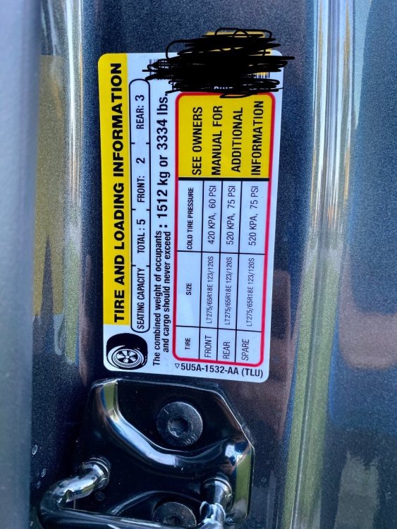

Is the 937 lbs. limit what is printed on the sticker on the Mercedes driver’s door jamb?  (The sticker will look something like this shown in the photo.  This is from my F-250, a cargo limit of 3,334 lbs and my towing capacity is 12,500 lbs, so the loaded Elite II plus all our camping gear, bicycles, people, etc in the truck is not a problem).  If your actual cargo/payload limit is only 937 lbs. then that is definitely not adequate for towing an Elite II.      The limit of 937 lbs. seems really low even if you aren’t towing.  You would get close to that with just 4 adults and a bit of luggage in the Mercedes.

John, I guess I’m even more amazed that Mercedes would offer a vehicle that they claim will tow 7700 lbs, yet less than a 1000 lbs of cargo capacity. The salesman retired the day I took possession; however, I doubt he knew how low it was.

3 hours ago, Xuxu said:
Yes, the 937 lbs is on the sticker just inside the front door. Obviously, this is not enough capacity to tow much of anything.
That number is not the actual payload of the vehicle because it factors in reduced load capacity of the tires when under-inflated up to 25% below the specified value,  or the point at which the TPMS system will alarm. In other words, 937 lbs has been determined to be the maximum safe additional load with the tire inflation 25% less than the value specified on the label.
There have been a number of different weight specs published for this vehicle but none I've found result in a payload rating that low. I'd suggest finding the GVWR number listed on the vehicle information label and having your vehicle weighed to determine its actual curb weight. The difference between these two numbers will give you a better idea if the GLE can be an adequate choice for towing. I suspect you'll find the actual payload is around 1300 lbs.
