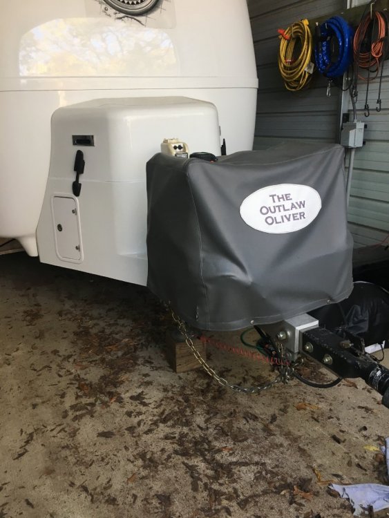

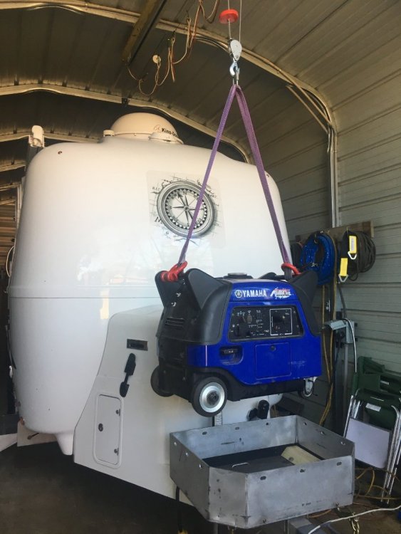

We've carried the same Yamaha 3000 watt generator over 150K miles on the front of two different Oliver's. Wouldn't have it any other way. Fuel goes into the generator tank. Fill it up when you get fuel for the truck.DSC_1095.thumb.JPG.002c9ca71788b5215ac103d273b80a10.JPG 1544955134_Steve-101-Img_1573-1.thumb.jpg.540470ce2fdc4d43df202f87907277dc.jpg

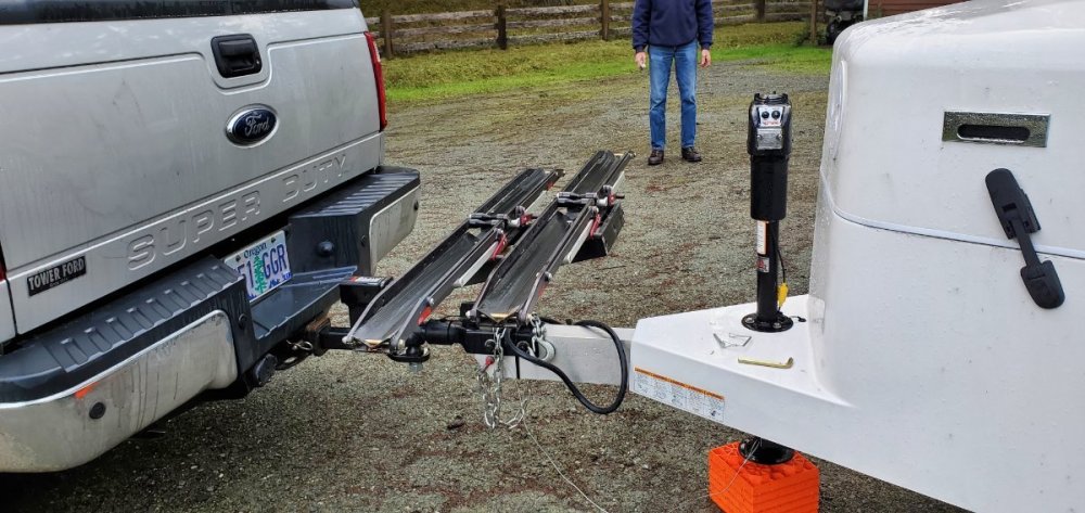

I shopped around and found an in the bed locking tool box that is deep enough for the Honda 2200 generator we chose.  In addition to the generator, it carries: a small tank of gasoline, small, portable LP tank (for an outside two burner stove and gas grill), the aforementioned gas grill, tools, bike tool box, folding camp table - items you like to keep secure and out of the weather.  It is deep enough to accommodate the generator and has tons of room for more "stuff".
We did not get the tongue accessory box because it would interfere with our bike rack that attaches to the pickup with a dual receiver hitch; the box would prohibit most turning situations.

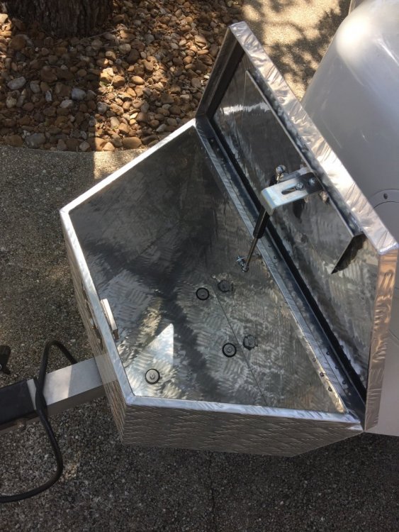

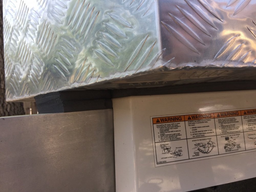

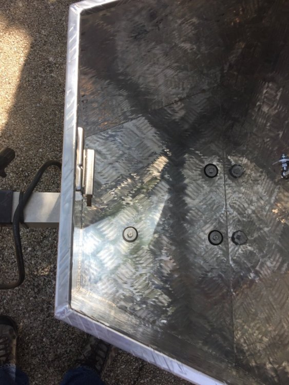

My installation may not win any awards, but it has worked well for the last couple of years.  I had some of those interlocking foam mats that I cut to provide a surface under the box.  One thickness on the fiberglass area, and two thicknesses on the aluminum tongue. I got some stainless steel bolts and nuts and some rubber washers from Home Depot.  I drilled three holes through the box and the fiberglass in front of the propane tanks.  I used the Home Depot hardware to secure the box with the foam mats underneath.  It has been rock solid ever since.  I cut a piece of the foam to fit on the bottom of the box to fit over the hardware.
Here are a some pics of the holes I drilled.

We have the 1UP and love it!  Extremely well built (in USA); quick and easy to load/unload.  It folds up, when not in use and drops down, with our without bikes loaded, so you can access the tailgate or back of an SUV.  The trays easily accommodate off-road tires up to 3.1" wide and my 29" Specialized Rock Hopper wheels; there are accessories to modify it for wider tires.  You can add up to two additional trays, though this would not work while towing the Ollie.  They also sell roof rack trays and trays for mounting in pickup bed or cargo area of vans/SUVs.
This is one of few racks we found that is approved for use behind an RV - we originally purchased it for our Leisure Travel Van.  Unfortunately, with the Pandemic surge in outdoor recreation equipment, there is a waiting list for these racks.
