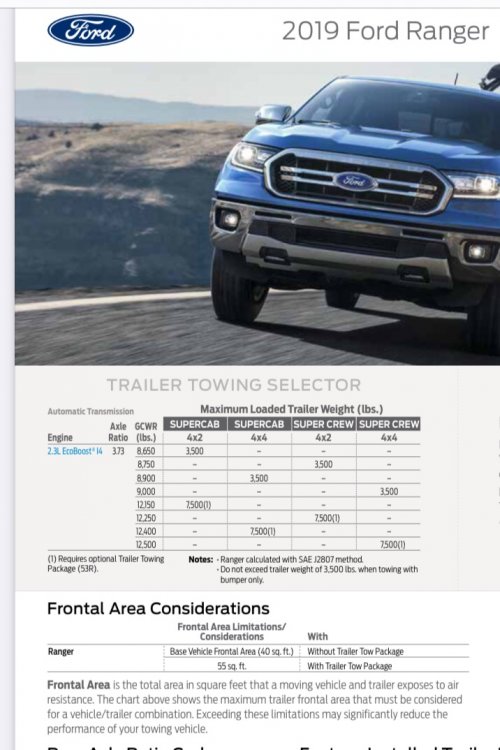

I saw that a member appears to be towing an LE2 with a Ranger, and it got me thinking, which is always dangerous.…. I never saw this in print before. The Ranger 2.3 Ecoboost can tow 7500 pounds when properly equipped, but the tow guide is pretty explicit about not having a lot of exposed surface area on the trailer. “Exceeding these limitations may significantly reduce the performance of your towing vehicle.”
They show one towing a small boat, which should be perfectly fine. I wouldn’t worry so much with an LE1 because of its much lower weight, but a loaded down LE2 would make me think long and hard before heading out West. The frontal area of that one is about 70 sq ft, and additional rooftop equipment like solar panels will make the drag far worse .
Comments? Has anyone seen these published frontal area limits for other TVs?

John,
Before buying our LE2, we towed a 2000lb aluminum travel trailer out west a couple times from NC with a 2013 4.0L Nissan Frontier. Best fuel economy I could get with this rig was  13.5MPG. Called this trailer a lightweight aluminum brick because of the lack of aerodynamics. The Trailer Frontal rating for the 2013 Frontier pickup was 60sf. When we purchased Ollie in Missouri,  towed Ollie home with the Frontier and could not believe the fuel economy @ 15MPG to NC (checked by actual gallons burned) with Ollie over double the weight of our previous camper. In 2014 the trailer frontal area dropped on the 2014 4.0L Frontier to 30sf with same engine and pickup frontal area. Believe these changes were made due to SAE J2807 towing methods.
If you look at 2014 Ford towing brochure, if I read it correctly, even the F-550 Super Duty is restricted to trailer frontal area of 60sf, page 13:
https://www.fleet.ford.com/content/dam/aem_fleet/en_us/fleet/towing-guides/Ford_Linc_14RVTTowGuide.pdf
This is a good discussion on the FGRV forum on the same topic during 2016:
https://www.fiberglassrv.com/forums/f56/trailer-frontal-area-77307.html
