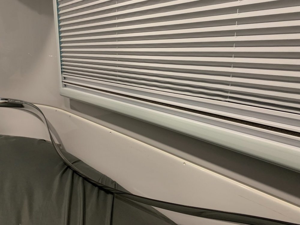

Apparently my trim got tired.
Thinking about just replacing with 3M molding trim adhesive roll. Looks like what Oliver used.
other suggestions?

Sometimes, the adhesive is inconsistent. I believe it come affixed to the chrome strip, like ez rv gutters.
Our bath trim fell off. We replaced it with vhb tape.
If I had to do it again, I'd use one strip of vhb, as opposed to the two narrow strips, as being too close to the outer edges, it leaves a tiny bit of gap.
https://olivertraveltrailers.com/forums/topic/4315-bathroom-bellyband-trim-redo/
I assume they used two narrow strips to keep the edges close to the hull, but do see what you mean.
I noticed a strip down the middle would be over the valley where the hulls connect, and thus no contact.
Should be easy fix with VHB in any case.
thx for link
Ours is vintage 2008. It was originally a single strip down the middle.
Ralph, for a newer trailer that is surprising.  Looks like an easy fix but not something that should happen.  Mike
Was strange. One year old this past May….and of course, heading out next Sunday. 🙂

If you don't have time to do it right, I'd just tape it up with packing tape or clear duct tape, and not let it ruin my trip.
Imo, it shouldn't have fallen, but I know it has. If it were me, I'd remove the entire strip, clean everything,  and do it right. Pretty hard to clean and refasten, just a section, especially since its occurred at the curve.
Even if you are out of warranty,  I'd encourage you to open a service ticket, so that Oliver knows about the issue.

that's my quandary.  I may try a section with the VHB I have. Worse case I do it right when I get back.  Solo trip and I don't use that bed, so not a big inconvenience. Just looks tacky. 😉

FWIW, Jason responded to my service ticket and said they use VHB to remount.

This just happened to us, too. PXL_20230118_201232951.thumb.jpg.938cb90d02d8e32161563b6819f995f0.jpg
Too cold to deal with now. Our first trip this spring will be to OTT for some other warranty issues. They can fix this while it's there. Will probably tack it up with painter's tape for the trip down.
I'm assuming poor prep work is the culprit.
