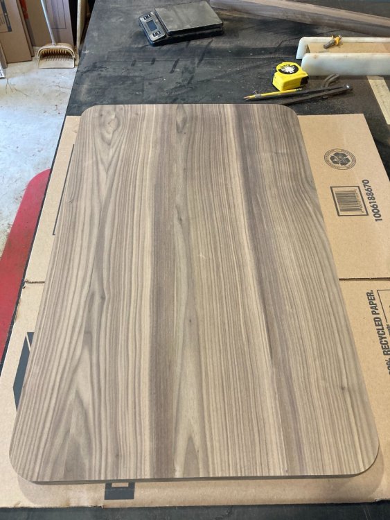

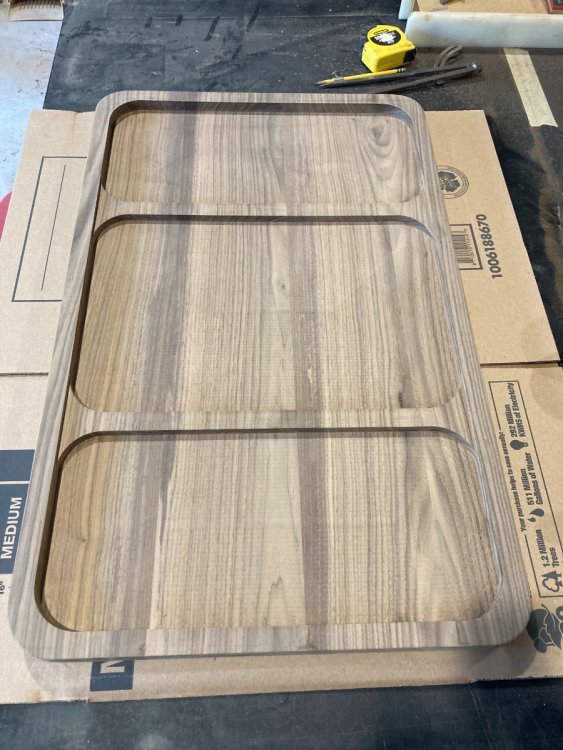

Popular Post Foy_Mirna Posted July 26, 2021 Popular Post Posted July 26, 2021 I have not posted in a while. My Oliver family has had me very busy in the shop. We are getting ready to go camping and then head to Greece for a 10-day vacation. I will be suspending my crafting for the month of August and will start back up the first week in September. I plan to ship all orders through August in the next week. New orders will begin shipping in mid-September. Below is my current challenge, a 35” x 22” x 1.4” Lagun tabletop in black walnut. While this sounds simple, the challenge is in the weight. Lagun Table Systems have a maximum weight of 50 pounds. It includes the top and any items you are going to place on it. My target weight of 15 pounds for the finished top leaves 35 pounds for day-to-day use. The walnut blank I started with 35” x 22” x 1.4” thick weighed in at 29 pounds. I decided to back cut the bottom in three sections down to ¾” thick, with 1” wide edges and two cross supports. It came in at 15.2 lbs. Beautiful to look at, light as can be, and engineered to be strong for a lifetime of use. 1 9 5 Onward, Foy and Mirna Roamy Mc Roadhouse 2017 Legacy Elite II, Twin Bed Hull #227 2021 RAM 1500 Limited
