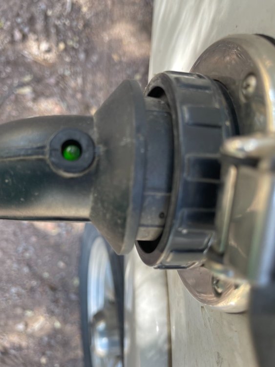

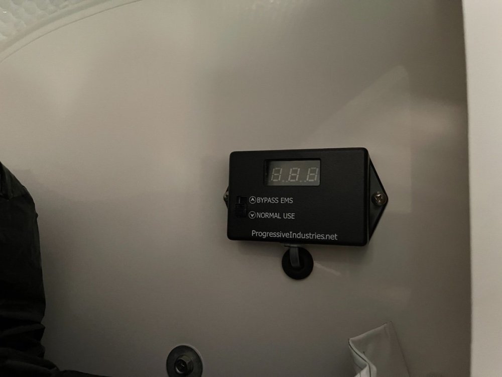

I have 110 volts going to the trailer connected to a camp site outlet but no power at the surge protector display. The display is blank and looks like it has no power to it. Is there a fuse between the surge protectors and the 110V input connector that needs to be reset or did I fry the surge protector?
I am running of the batteries but it would be nice to turn on the ac. It get hot here in the afternoon.
All see pics above. Yes ac power is coming to the trailer see pic w green light on power cord. The surge protector display is not on and I do not get ac power in the trailer when I switch the bypass ems. I do get dc 12 volts and the inverter works. Just no ac power in the trailer
did I fry the ems in the trailer or is there something else going on?

I took the cover of the EMS-HW30C and my voltmeter says there is 120V going into it but nothing coming out so for sure it is broken and needs to be replaced, either the whole unit or just swap out a circuit board as in SteveCr case.

Hi all, thanks for your help and support. Happy days again. An update on my no shore power topic. Progressive sent a replacement surge protector that I just now installed and I am very happy to report all electrics are working again on the trailer. AND I am ordering the soft start and an electrical engineering colleague will install it for me. It looks simple enough to do from the you tube videos I have watched. I could install it - I am an Electronic Engineer but I have a fear of heights so there is no way I could go up on the roof of the trailer. My younger, fitter colleague can. So I will get that done and use the lighter weight, low noise 2K watt generator that I already have.
