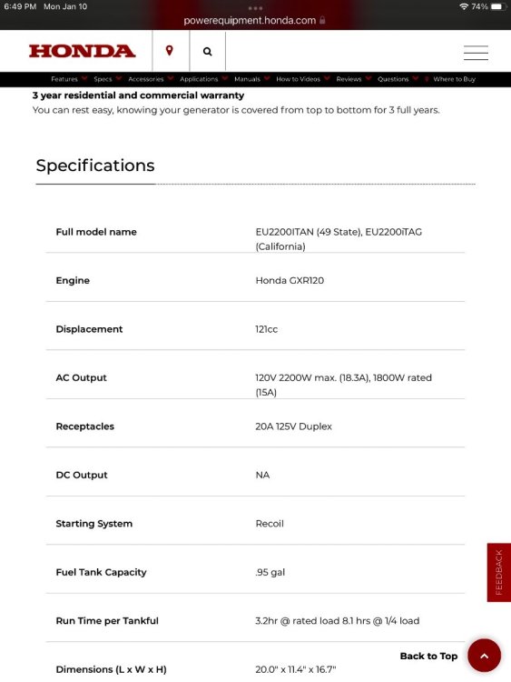

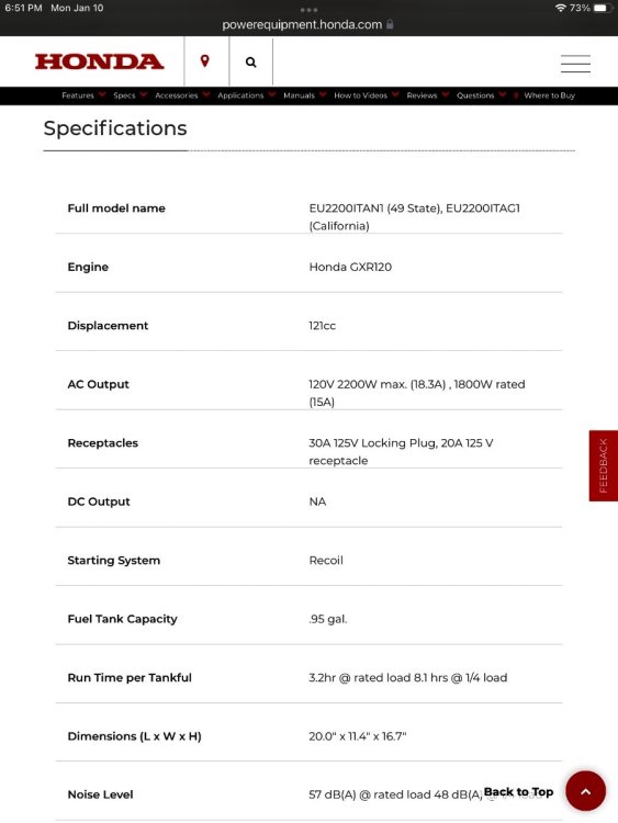

I agree with and adding to SeaDawg's comments.  These spec's are for the EU2200i and the EU2200i Companion and they are identical except for the equipped output plugs.

Thanks for your info.  Didn’t realize both Honda units put out the same amps.  I probably would have purchased the companion model. Thanks again!
