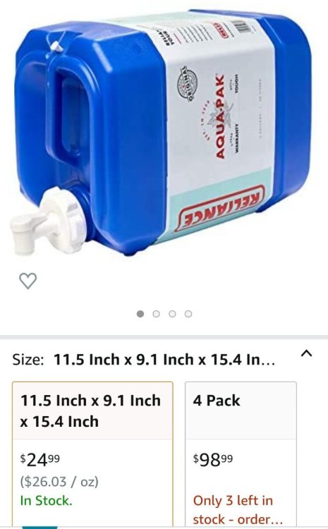

Moderators SeaDawg Posted January 12, 2022 Moderators Posted January 12, 2022 We have several 5 gallon tanks, like these below, for drinking water. We've worn out a couple spouts over the years, but the tanks are fine. Empty, they stack 3 high on our garage, and full, they pack nicely in the truck bed because of the shape. Five gallons is about all I can lift. When we're set up for several days, we just put a container on the trailer tongue or a step stool, on its side, and use the spigot. A number of people use the scepter tanks. Really nice, and super durable. More expensive. We also have a 40+ gallon bladder, like this one below. Folded up empty, it fits in one of our underbed bins. We don't use it much, but it's light, and good to have around for emergency refills. We carry it full in the pickup bed. 2 2008 Ram 1500 4 × 4 2008 Oliver Elite, Hull #12 Florida and Western North Carolina, or wherever the truck goes.... 400 watts solar. DC compressor fridge. No inverter. 2 x 105 ah agm batteries . Life is good.
