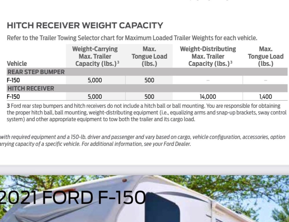

The need/requirement for use of a weight distribution hitch such as the Andersen system is based on the manufacturers specs for tongue weight limit of the tow vehicle.  If you check the towing guides that are published by the manufacturers, you will find that most 1/2 ton pickup trucks have a tongue weight limit of 500 lbs. for a basic weight carrying hitch, and for tongue weights above that you need/ require a weight distribution hitch.  And an Elite II will exceed a 500 lbs. tongue weight.  And when you get above a 500 lbs. tongue weight you are probably starting to get really close to your payload/cargo limit of your tow vehicle (this is NOT the same thing as towing capacity) when you add in your camping gear, a bed cover or cap, a bed liner, Rock Tamer mud flaps, tools, etc.  Here’s an example from Ford’s towing guide showing the tongue load limits for the F-150.   And all the limits are based on assuming a 150 lb. driver and passenger.   I don’t know about the rest of you but 150 lbs was a long time ago  😂
