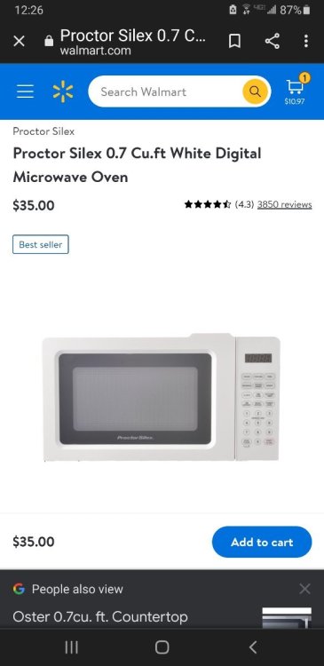

The smallest microwave I've seen, recently, was a .7 cf at Walmart. If they'd had it in red then, I might just have bought one for the garage.  Weighing in at 20 lbs, even if it doesn't fit in your cabinet, it wouldn't be difficult to move from the closet or pantry to  a tabletop for use.
